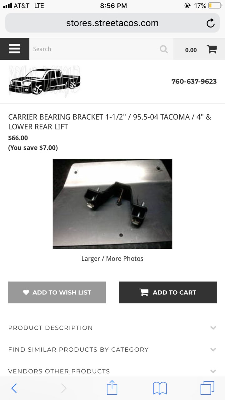

    I lifted my Tacoma and was getting drive line vibration between 15mph-25mph. I bought a 1-1/2 inch carrier bearing drop bracket for it and my issue went away. 6CD6E24A-FF8E-41C0-AC09-006FCCFB03E3.jpg

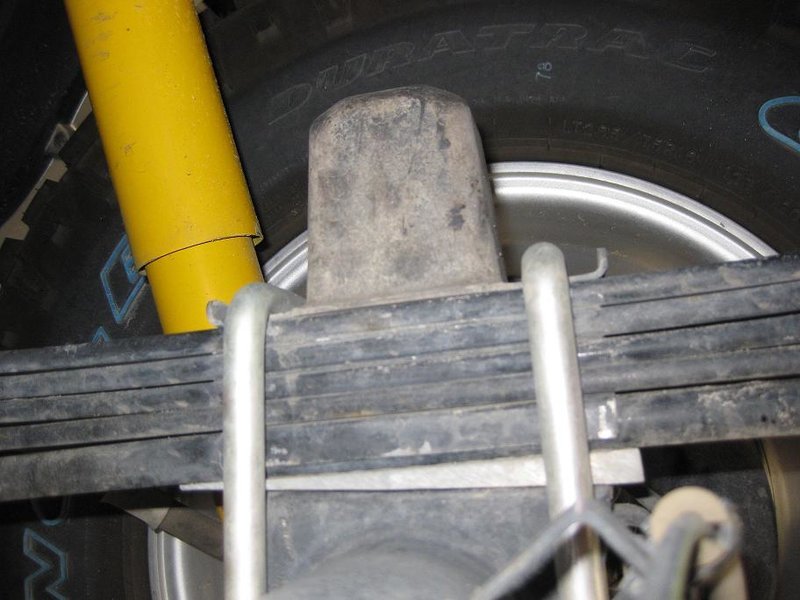

    shout out for @Wheeler's Off-Road Inc - ordered my OME kit from them (June, 2018) and just ordered SPC UCAs from them today. Customer Service level and interaction hasn't changed one bit, still the best. Thanks Wheeler's OR! :thumbsup:

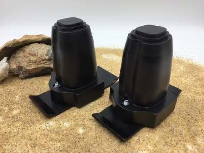

    Looks like you need some Wheelers Super bumps for that back end. I have them front and rear and they are awesome!

    Thats not my truck, I just found a picture online. Too dark and cold to take a pic this morning. Im running Durobump stops. Im loving them.

    For some reason I think Wheeler's markets their carrier bearing drop for 2nd gens on their website but I used this kit for my 1st gen just fine, it drops the CB down maybe a half an inch or so. Just a couple of small metal spacers and longer bolts.
    There used to be a bracket that someone made for 1st gens that would lower the carrier bearing enough to put your driveshaft at a straight angle but it isn't around anymore I don't think. @zero4 has one on his truck

    Yeah the CB drop I have is the one Adrian posted above. Their website is still up but if you go to their forum here in TW there's a note saying the vendor had issues. Not sure if that's the case still.
