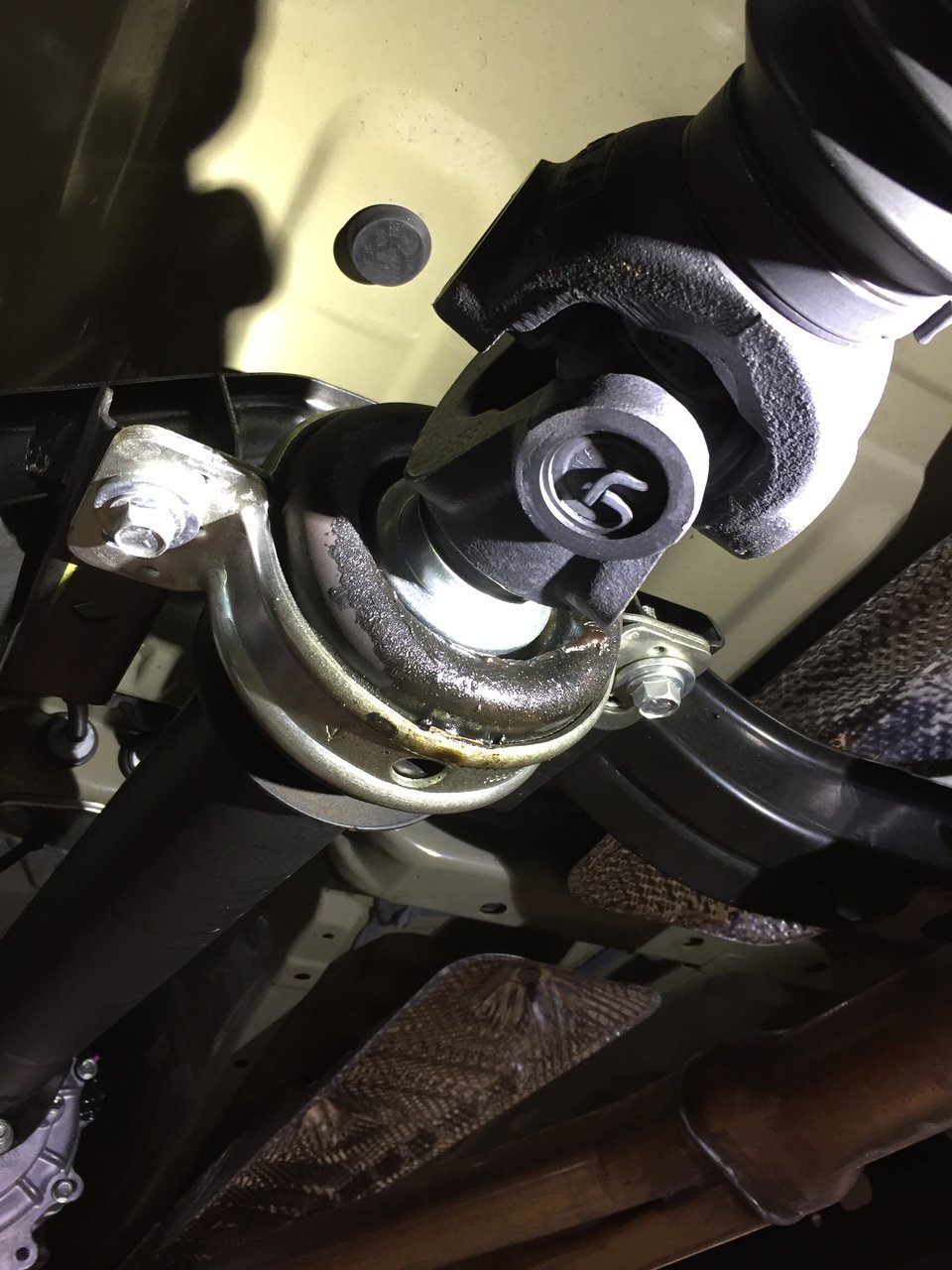

    Dropped off my ‘17 Offroad this AM for the 5k mile Toyota Care servicing (no I didn’t pay for this, my dealer dropped that charge when I bought the truck).
    I mentioned to the service advisor that I had experienced a ‘clunk’ coming from the rear end when coming to a stop. I attributed the issue to the shitty transmission as it felt like a rough gear drop, and chalked it up as another 3rd gen annoyance. That and I only experienced ‘clunk’ when the truck was still cold. Once it was at normal operating temps it seemed to stop without too much drama. I also told her I’d noticed what I suspected to be the infamous rear diff howl.
    I had zero faith in Toyota to be able to replicate, or own up to hear/feeling either issue, but still wanted both complaints documented and on record.
    A couple hours later I noticed I had a voice mail from the advisor requesting I give her a call. When I called her back, she proceeded to inform me that my driveshaft is broken and they are ordering a new one :eek: To say was shocked is an understatement. The truck has under 4K miles and has seen only pavement duty with light towing/hauling thus far.
    She couldn’t provide much more detail, but said she’ll get a tech to put it on the lift and go over it with me when I go back later to get a rental. I’ll report back when I have more information, and hopefully pictures. I asked for a 4Runner as my rental, but they claimed to not have any available right now. Gonna be stuck in a Highlander until at least next Thursday :anonymous:
    Update:
    Turns out it was a seal around the center support bearing assembly that had lost too much grease. I commented that it probably was low from the factory, along with various other fluids. The tech didn’t really say much but smurked. I’m not fully convinced replacing the driveshaft will permanently resolve the ‘clunk’ and certainly not th howl, but at least it’s all documented as a complaint and an attempted ‘fix.’
    My issue may have resulted from the possible out of balance shaft others have mentioned. Regardless, they’re replacing the whole driveshaft.

    Interesting. Take pics and note the are of the driveshaft that's broken. Mine does this too. Especially when feathering the brakes when coming to a stop. I'm def interested

    Please give more details when you can. I have the same exact issues. I’m worried that Toyota will never fix it because all they’ve ever said about any issue I have is that they can’t duplicate it.

    OP, you'r driveshaft didn't break (as in snap). Your carrier bearing is failing. Or it appears so anyway.

    Fully aware my driveshaft didn’t snap. I’m not a mechanic, but I know what’s going on below deck. I use the dealer for servicing to stay within my warranty specs. After that it’s all driveway wrecking.
    But you are correct as it does appear to be the carrier bearing.
