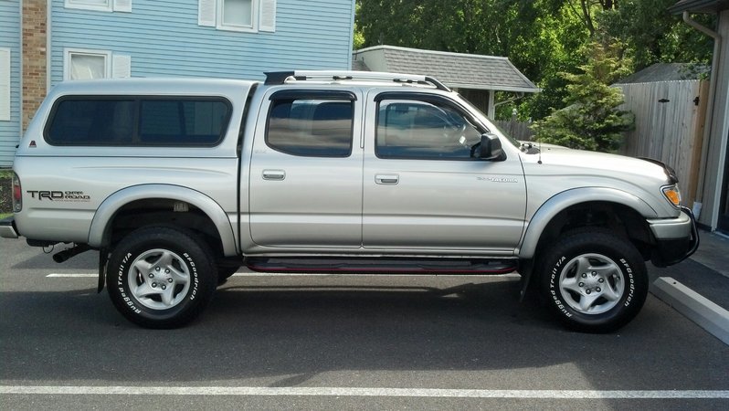

    In the past 2 years the gas mileage on my 2002 3.4 has been declining from about 17 MPG to 15 MPG. I keep it maintained, tuned, tire pressure, etc.
    About 4 months ago I noticed a strange "chirping" noise only when decelerating. Couldn't figure out where it was coming from. To me it sounded like left front, passenger said right front. rear passengers said under them.
    It took 3 trips to the dealer to figure out that my drive shaft carrier bearing was bad.
    Now that it is fixed my MPG is back up to around 17 and the truck just seems to run better now. Is it possible that the bearing had been going bad for 2 years (undetected until I heard the chirping noise) affecting gas mileage?
