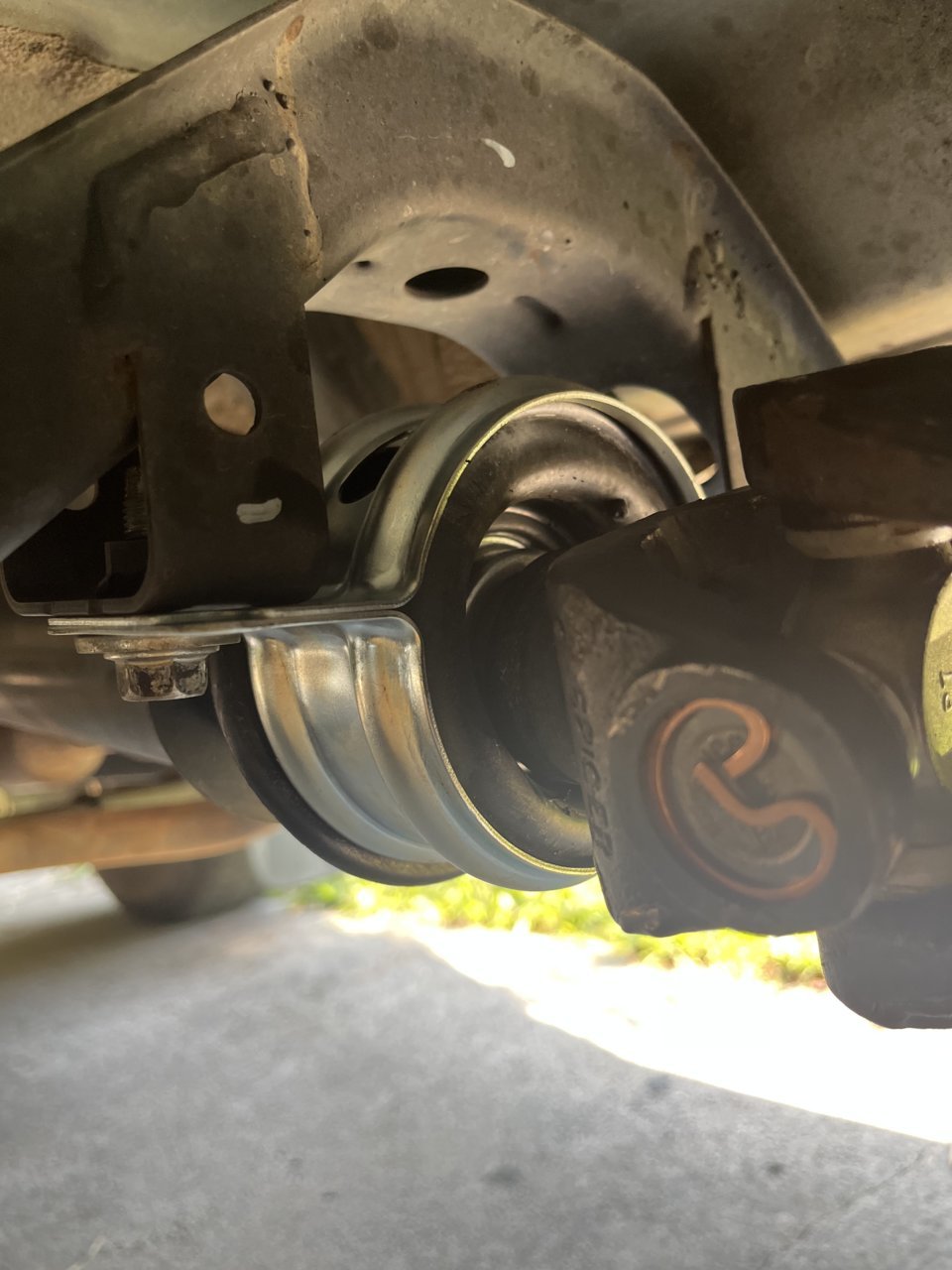

    Can someone please help. Is not not aligned right ? A shop recently replaced this because the U joints were squeaking but now this looks like this. it looks like the driveshaft is not in the center. Please help

    Should the driveshaft not be in the center of the bearing?

    That rubber is flexible, poke at it with your finger. The weight of the driveshaft is resting on the bottom, it's going to sit off center. How much off center is a higher pay grade than mine.
    ETA:
    My free opinion is it looks ok to me.

    They will sag in the carrier when new.
    It’s supposed to have some “give”.
    It helps with vibration too.
    It will “center up ” when it’s spinning.
    Drive it. :thumbsup:

    It squeaks though when i accelerate until about 25-30 then it’ll be good from the noise but then say i go over a little bump it will make a quick squeak

    The only thing I can think of is that the shop might have gotten the nut too tight.
    It’s a BIG nut, but final torque is not all that much.

    Also do the u-joints have zerks? If so you could also add a few pumps of grease if the shop might not have. The zerk type come with basically just a glaze of grease from factory if they are spicer.

    They don’t i wish they did but i don’t think is the u joints

    A squeak in the driveline is far more likely to be a u-joint going bad or in need of grease. Some of the trucks have the 100k u joints that are not serviceable so there are no grease zirks and others have greaseable jopints.

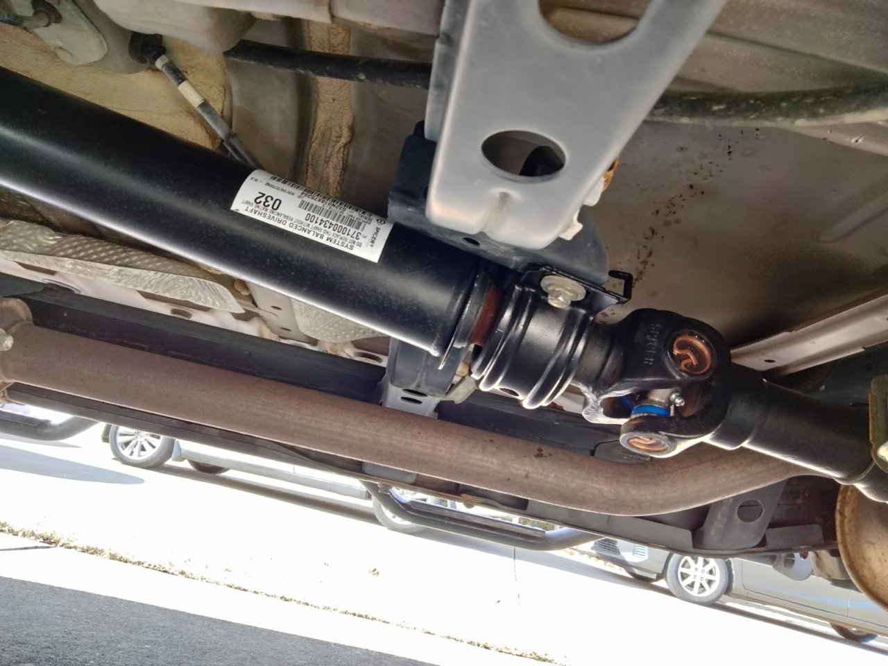

    That's the sound I heard before replacing my U-joints and carrier bearing. Took care of it. This is how mine sits after installation. Sorry,IMG20221226131236.jpg but it's the best pic I have right now.
