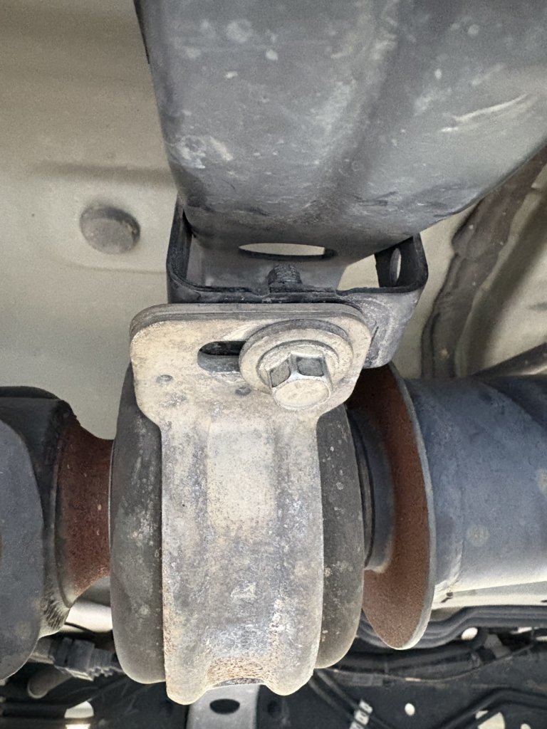

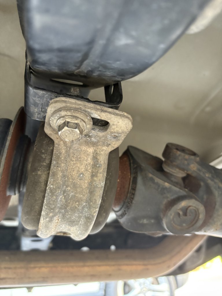

    I’ve got a few questions about the position of my carrier bearing. I have recently put a lift on the Tacoma and it has had a vibration when driving at 22-28mph. I’ve done some homework on the vibrations and first started off with trying the carrier bearing drop kit, in which, it actually made my vibrations worse. When removing the carrier bearing drop kit and putting everything back to normal it seems as if the carrier bearing is not sitting slightly a-skewed from where it originally was. It was extremely difficulty to line it up enough to get the bolts to go back in the carrier bearing and took some fighting and pushing/pulling of the carrier bearing to get it lined back up to even get the bolts back in. With all of this being said, does my carrier bearing look like it is off-centered? Could this be causing more vibrations? Or am I overthinking it and it is in the right place? If it is off-centered, what are some ways that I can line it back up when taking the bolts out one by one? It was a son of a gun to fight it to get lined up as much as it is in this picture. Not easily shifted back and forth! Thanks in advance.

    IMG_3012.jpg Chasing some vibrations after my lift right now. The Rough Country carrier bearing drop did improve some vibration but I'm installing axle shims at the moment. Kinda sucks.
    Like you, I thought the strap/lower bracket was skewed toward front of truck from the factory. So it shows the gap/bolt hole on one side toward nose of truck.
    here's mine with the shims installed, which looks cheated forward like yours (and mine from the factory). But yours does look a little droopy, like it may not be tightened all the way. Did you slowly torque it to 27 ft-lb?

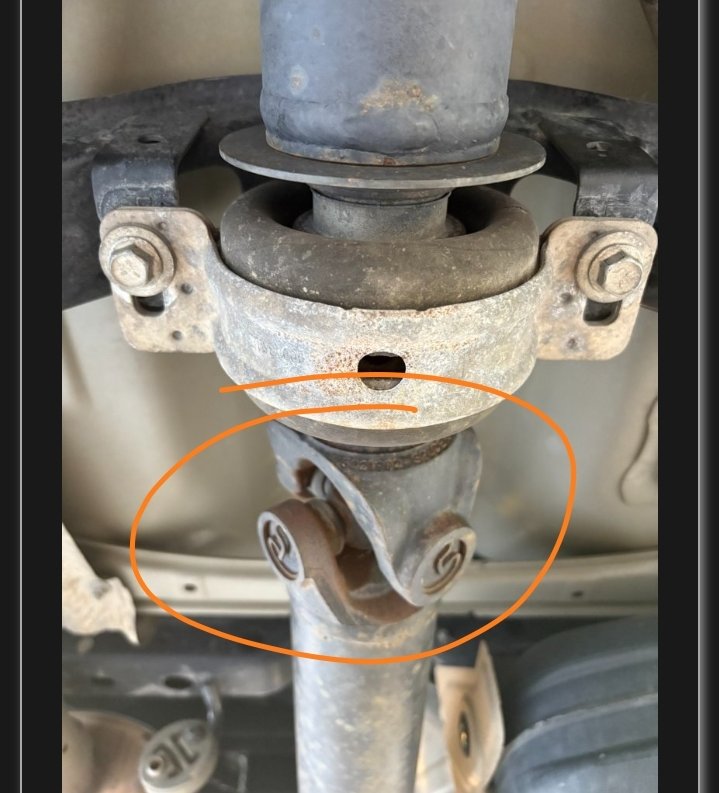

    Shouldn't matter but have the ujoints lined up with the driveshaft.
    zwelch865[QUOTED][OP] likes this.

    Thank you for that tip. I’ll try that when I get home and see if it helps me shimmer the carrier bearing back up into place. With it rotating like it is, it may be pulling it down when I loosen up those bolts.

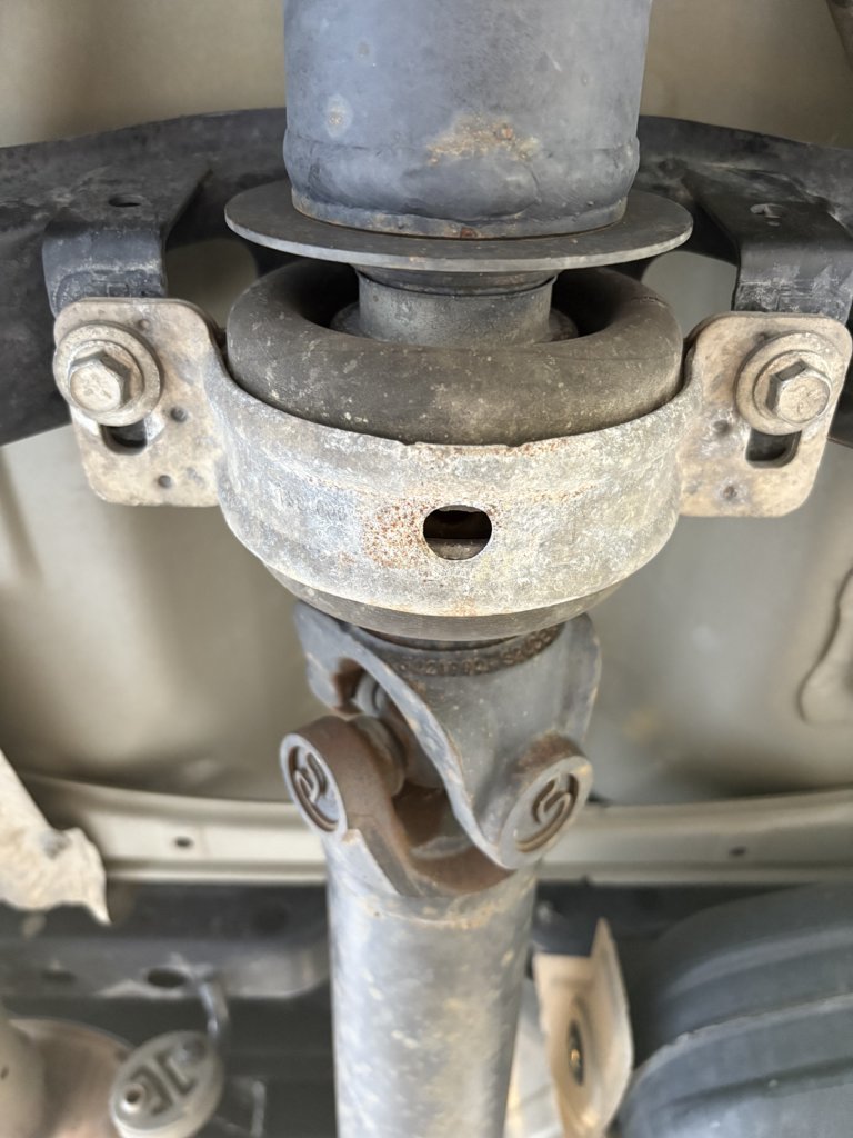

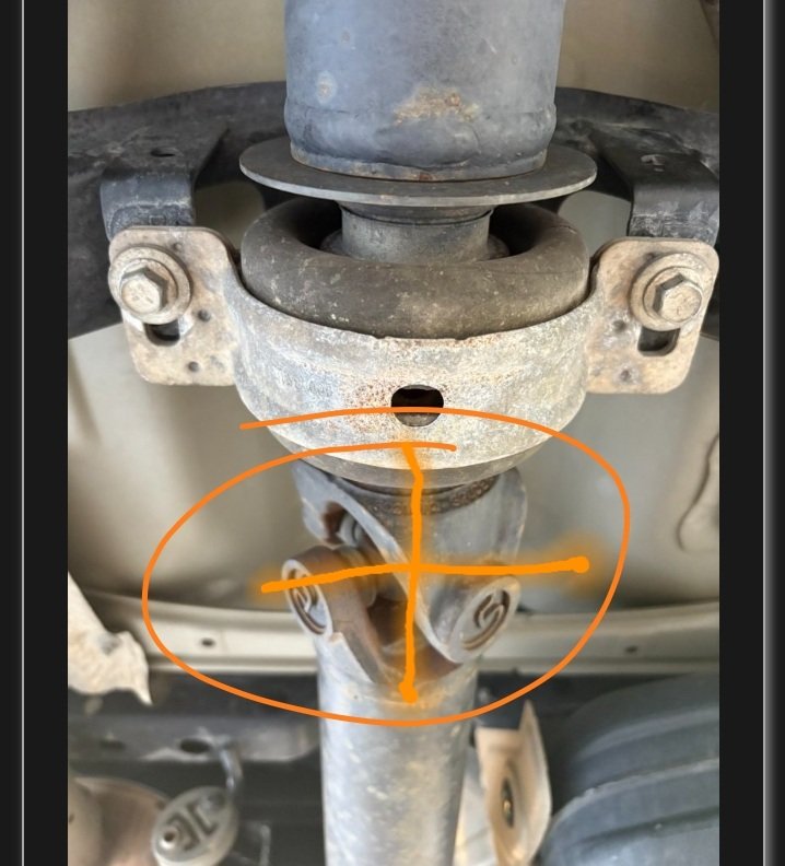

    Right now it's at a weird angle.
    zwelch865[OP] likes this.
