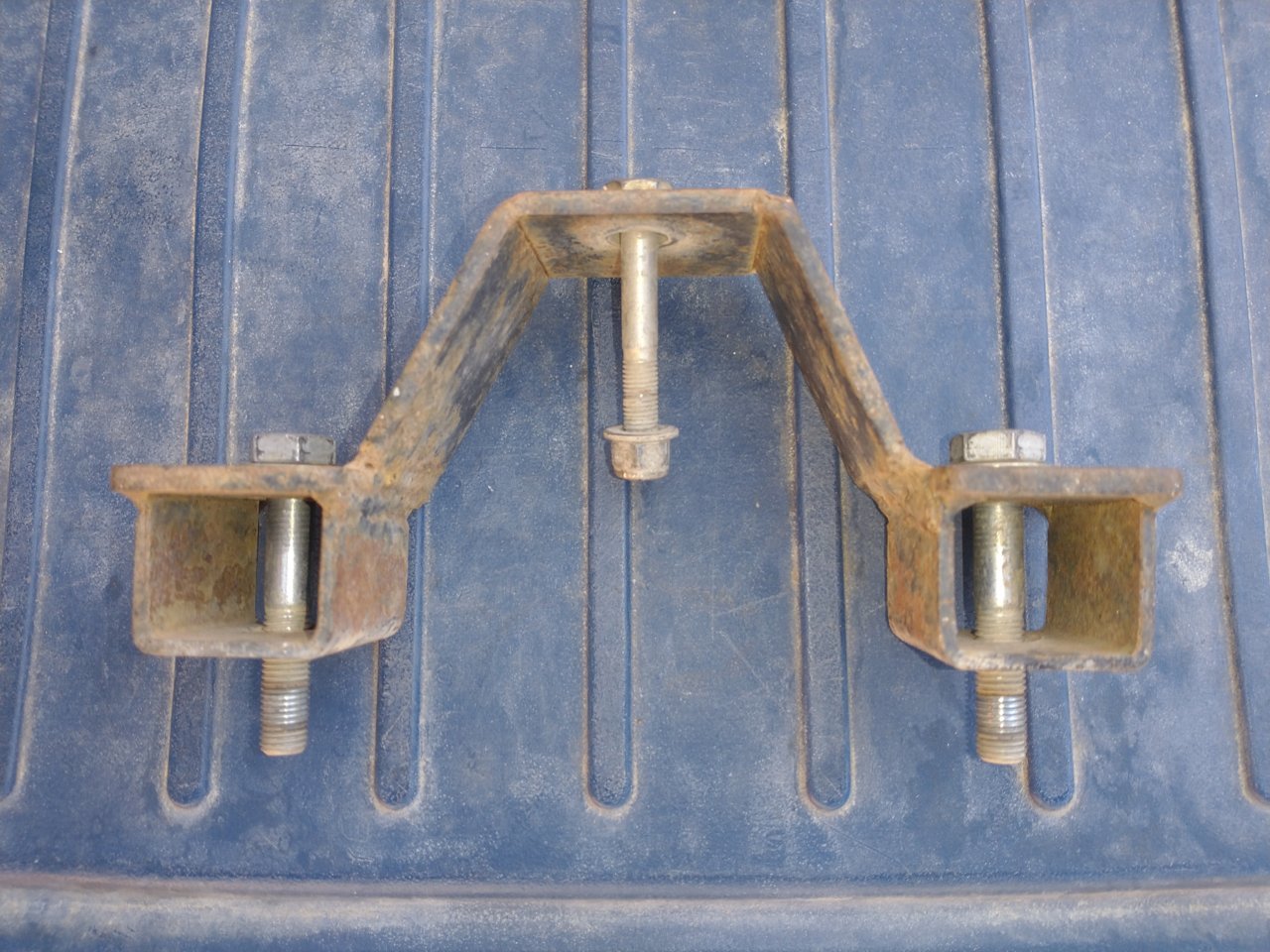

    Carrier bearing spacer:

    Wow that is so different than .

    Yeah it's kinda unnecessary beef supreme.

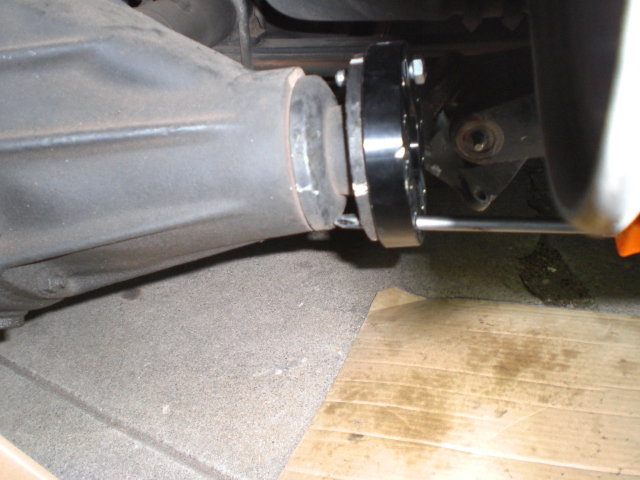

    These worked well for me.
