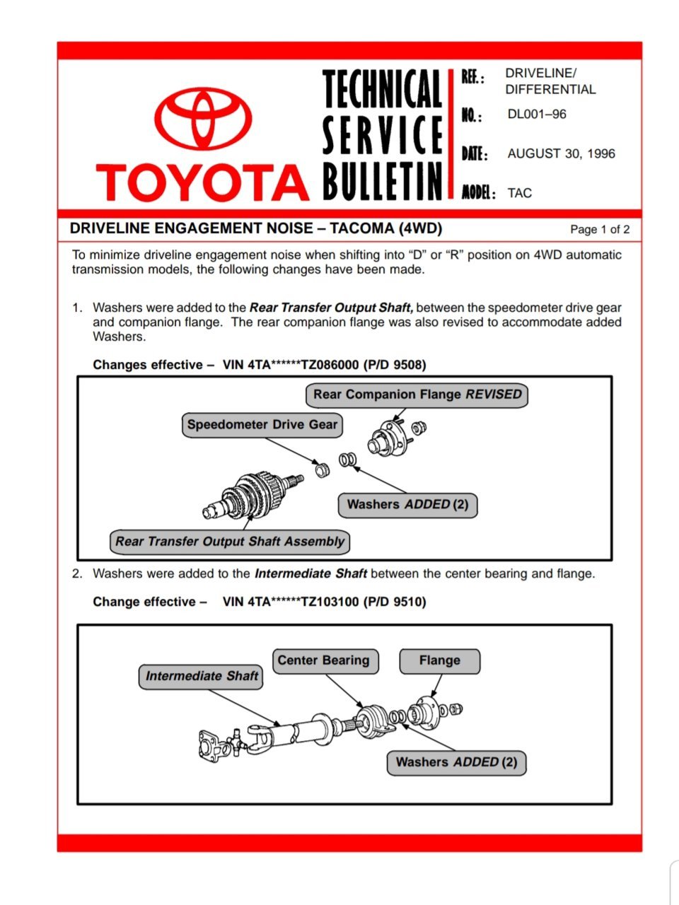

    So I am in the middle of replacing my carrier bearing and flange and I realized realized I am missing the 2 thin washers that go in between the bearing and flange.
    I found this old TSB:
    of when/where they were added. Part number is 9020125006. Closest dealer that has them is 100mi away and soonest I can get them to my local dealer is Thursday/Friday. I may go down to the junkyard but these trucks are hot pickings so I doubt I'll find them.
    So, does anyone have the specs on these washers or have the ability to measure them? I would like to see if my local hardware or autoparts store has something that will work.
    Thanks!

    I checked, they were definitely missing. I managed to find one in the junkyard believe it or not.
    If anyone else has this problem the dimensions are approximately:
    OD: 36.5mm
    Width: .9mm
