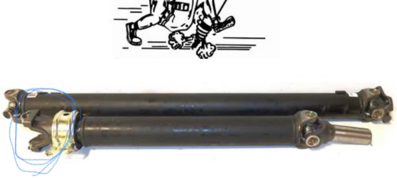

    Okay so my truck has been making a clunking sound going from drive to reverse or reverse to drive. So somebody said something about u joints so I got some new u joints and under here under my truck right now, I can move the driveline up and down from The Middle on up along with that my transmission moves not so sure that's normal. I'm assuming carrier bearings out but I don't know I don't know nothing about this s***. Thanks for everybody's help.

    So you are saying the rear end of the transmission is moving?
    That’s not normal. Some play in the carrier bearing is normal. But it’s honestly very hard to explain what normal is, it’s one of those things you have to see Good vs Bad.
    Who did the U-joints?
    If it was a shop, they should have told you about the carrier.

    Ehh just tried to change mine, broke the driveshaft….I couldn’t get the flange out in the middle. Just ordered a Tom woods driveshaft.

    I’ll post pictures when I get home. But I took the middle u joint out. Then there is a 22mm nut that you take off to get to the carrier bearing. Once I took the 22mm off, your supposed to pull off that other, small peice of the driveshaft that looks like a Y. Well mine wasn’t coming out. Used a hammer, but in the end I put a puller thru there and it broke the metal on that piece. The little y.

    Yup that is where I got stuck at and had to use the wheel bearing race remover to take it off since mine was stuck on it.

    That piece is called a yolk. I'm curious what specifically was damaged—did one of the forks of the yolk completely break off?
    I too had some struggles getting that yolk off, but some moderate percussive maintenance got it loosened up.

    Okay. The transmission does move, I noticed the zirque on the front u-joint is not rounded, it's like it has been sheared off, and there is like a rainbow of grease above and around that u joint. Im doing all this myself, so I appreciate everything y'all are saying thank you. So,.I'm taking the driveline off as soon as Im....ill keep you posted!

    A little movement is ok as it sits/connects vis rubber bushings/mounts. However there should have no free play. Below is too much movement on my former center bearing. See DIY center bearing thread below. Spicer 5002334 or 5002007 will fit, with the latter specified for 4WD models because it has seals at the ends, but either will fit. I have the -334 in my 4WD.

    As someone whose done their carrier bearing it's a relatively simple job. It's a bitch getting the bearing off the driveshaft and the new one back on since its pressed on. Doable for sure, but time consuming.
