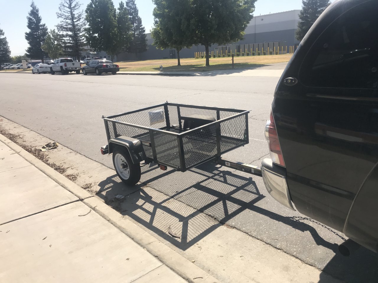

    Preamble: want to build a RTT trailer utilizing a harbor freight 46x40 trailer ( )
    I want the RTT as high as possible to use the trailer for cargo as well.
    Anyone smarter than me that can provide some guidance in regards to the center of gravity to prevent rollover (tip over) when driving/turning?
    Many thanks in advance.

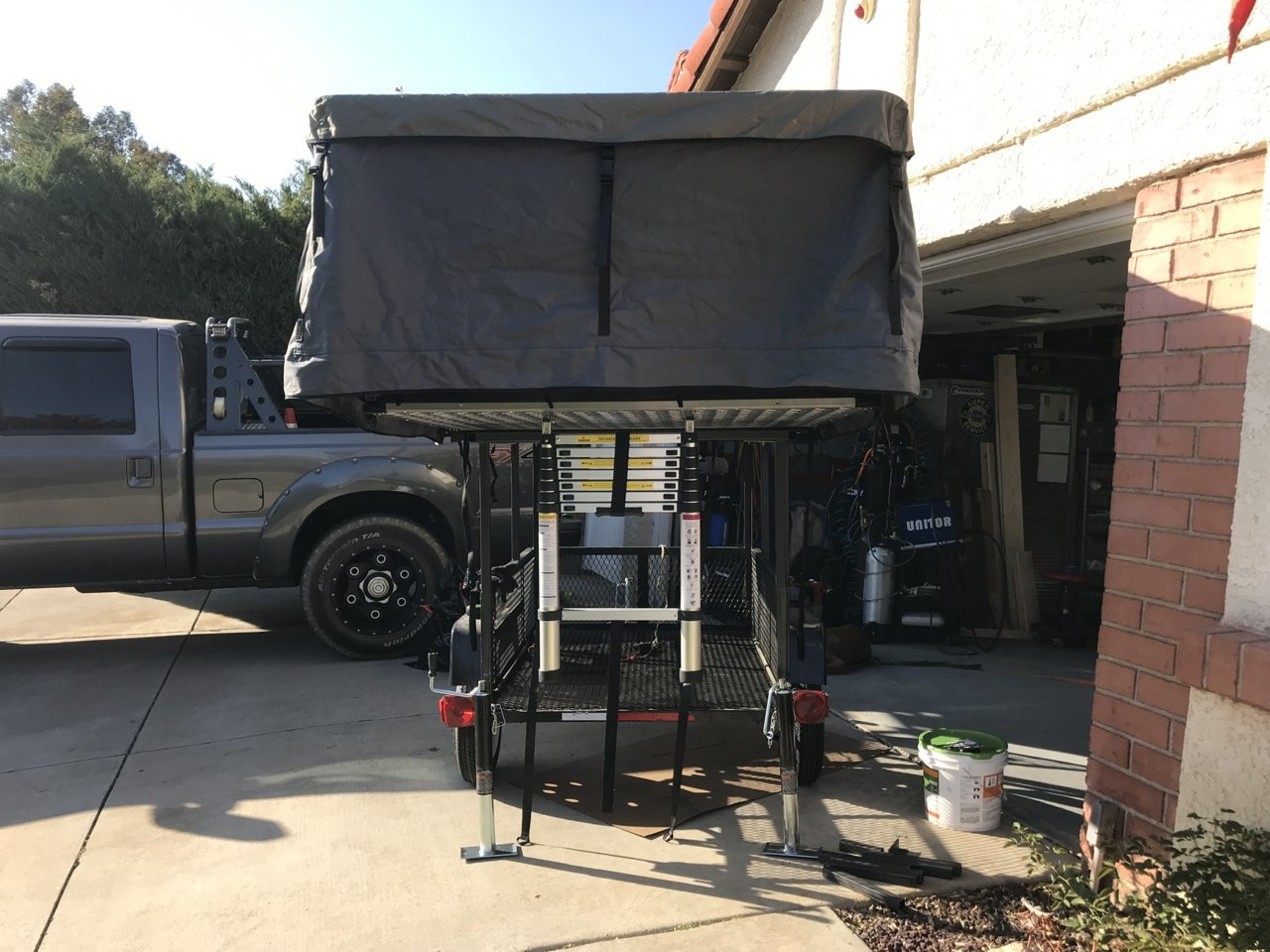

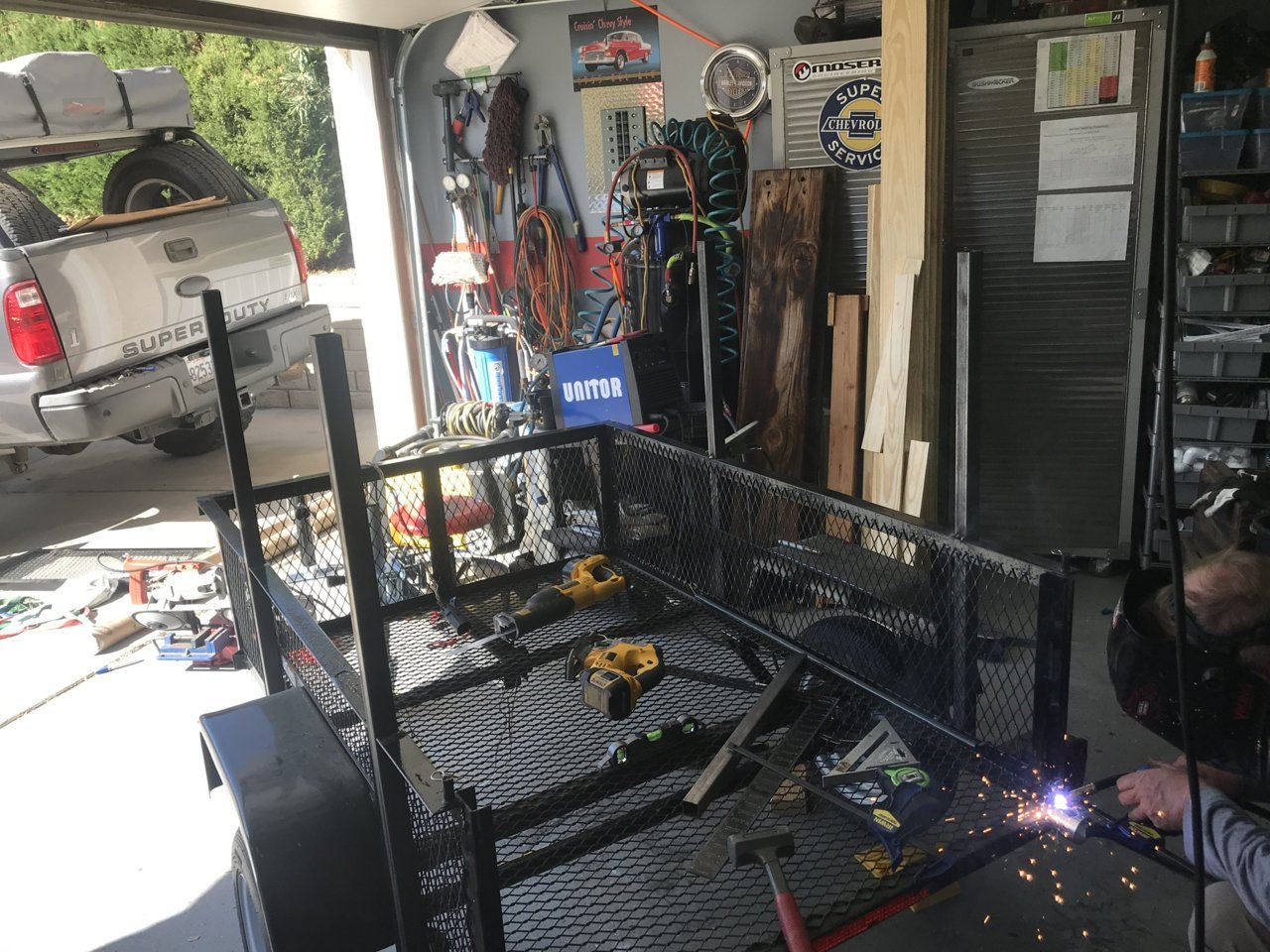

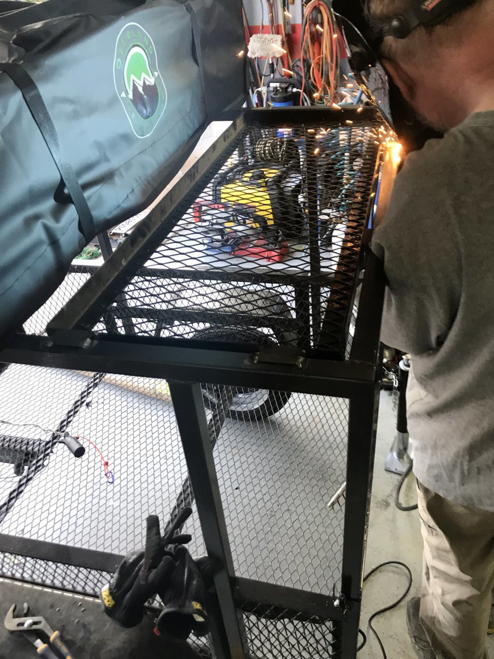

  12. Oct 13, 2019 at 10:33 PM
    67siia
    67siia [OP] Well-Known Member
    May 18, 2015
    #155493
    169
    J
    32164
    2009 4WD DCLB aka Chupacabra

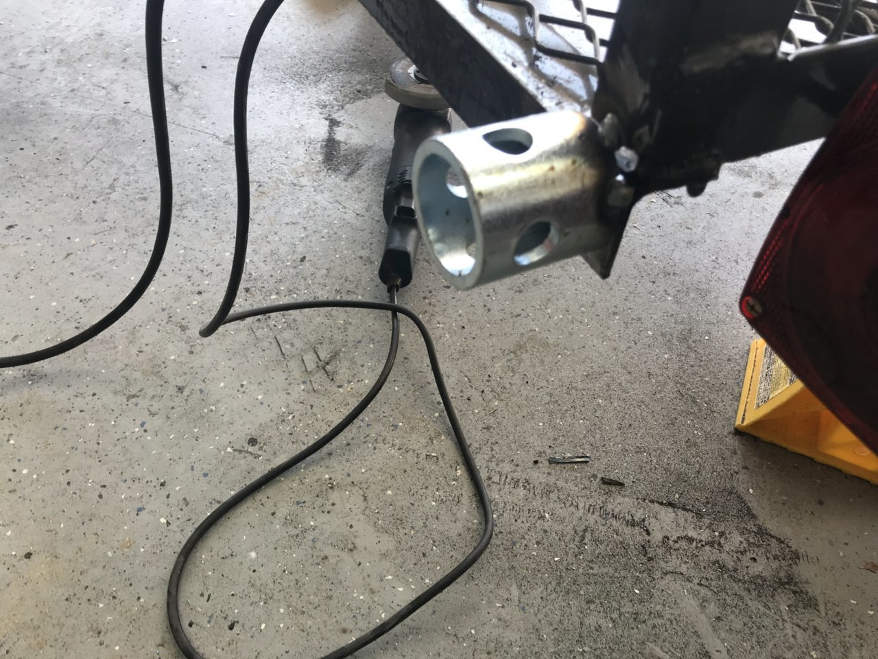

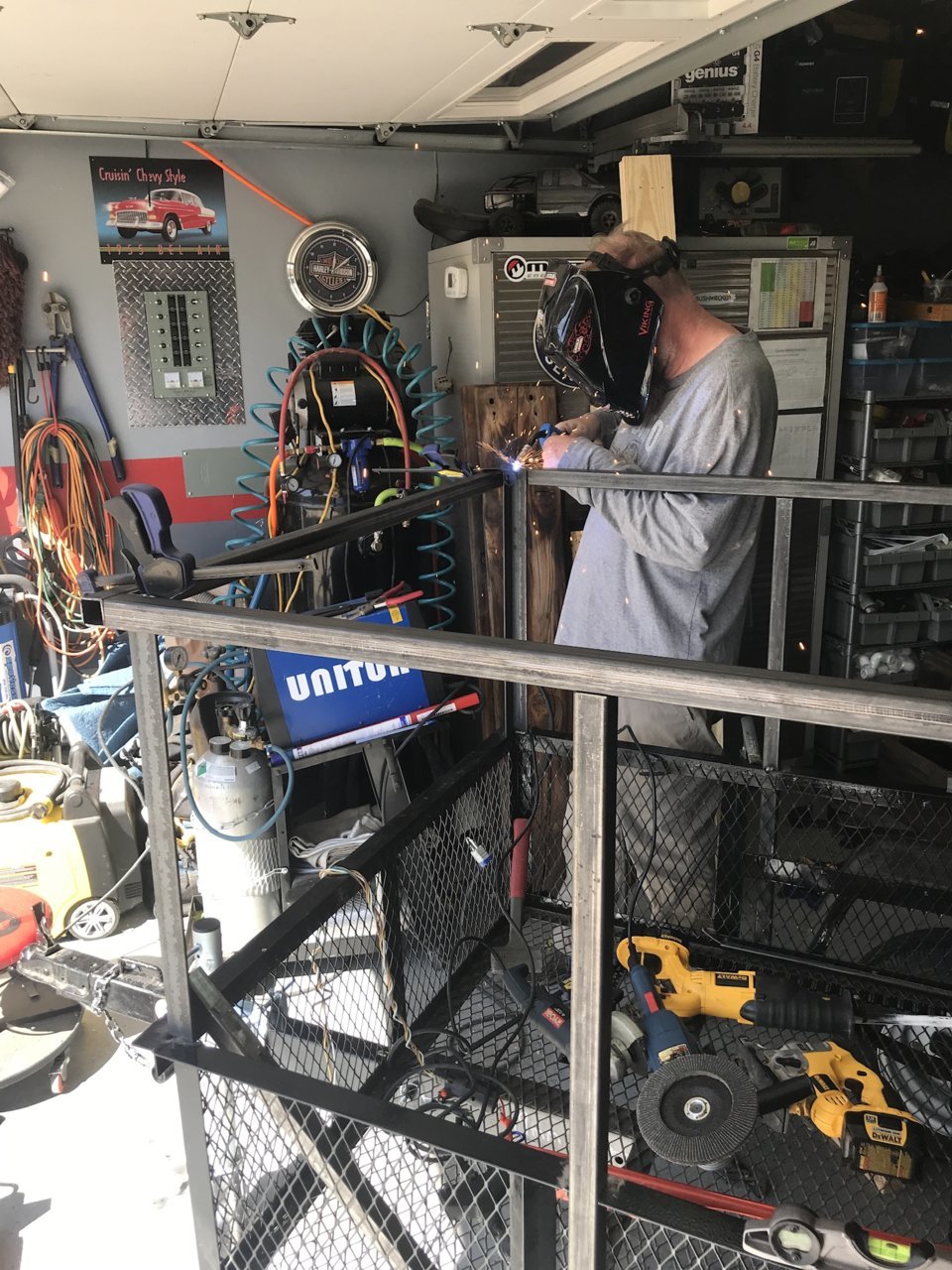

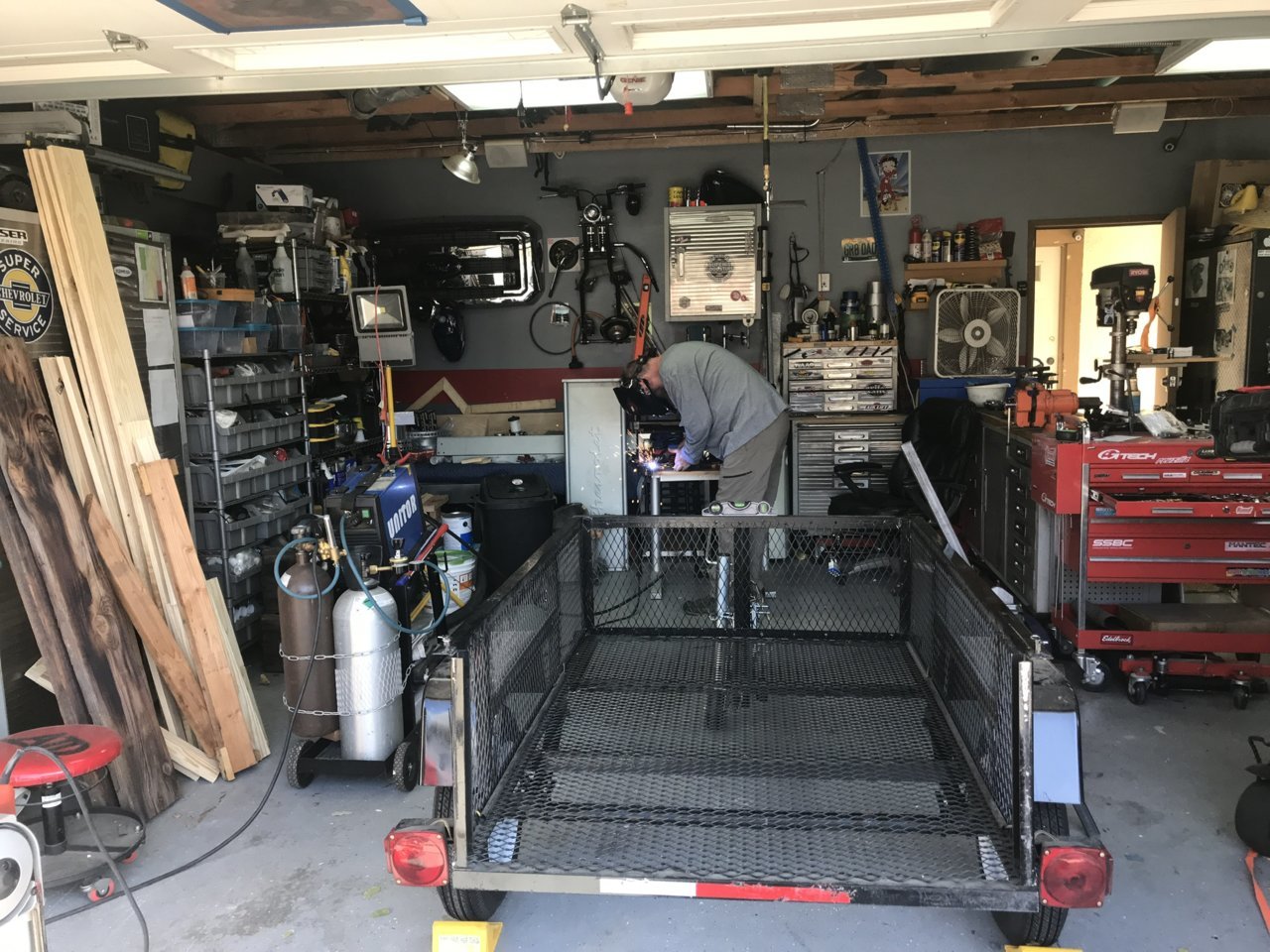

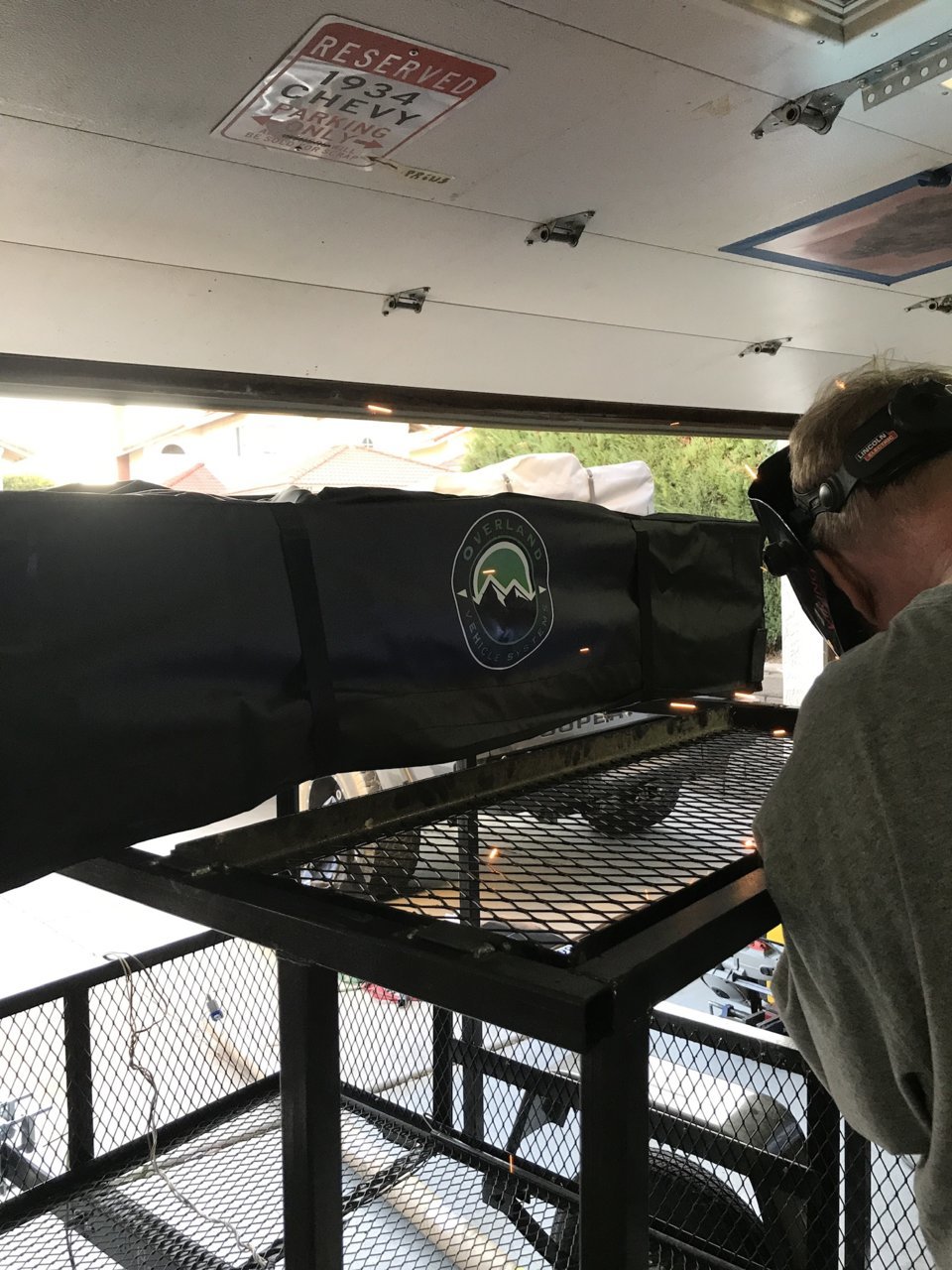

    Long day. Millions thanks to my good friend and welder extraordinaire.
    All I have left to do is paint, convert to 7 pin wiring, enclose the trailer, install house battery and test the tent.

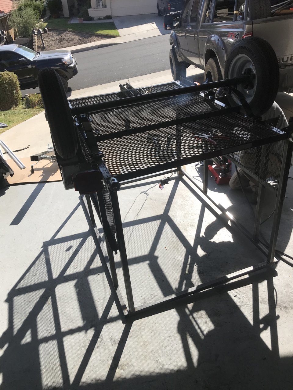

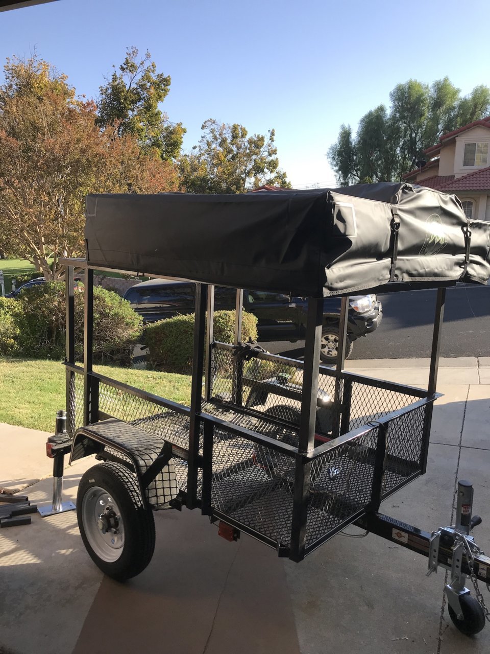

  13. Oct 13, 2019 at 10:34 PM
    67siia
    May 18, 2015
    #155493
    169
    J
    32164

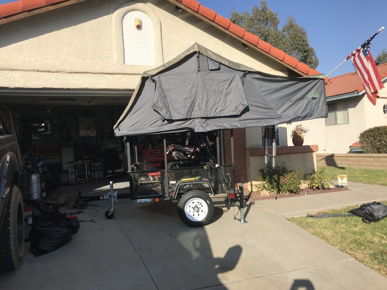

    More pics
    Trucknorris likes this.

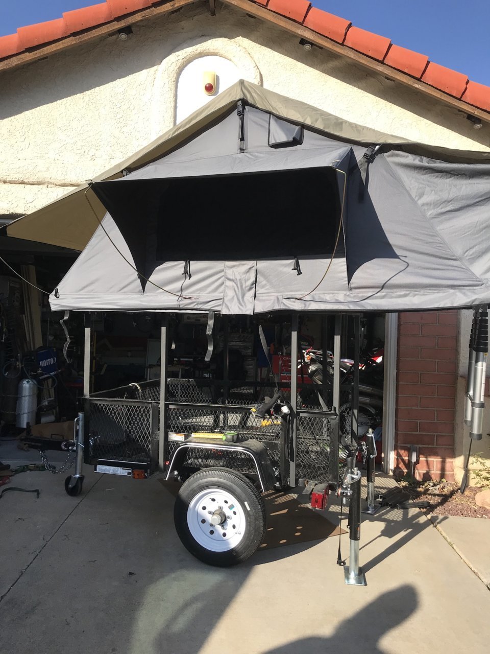

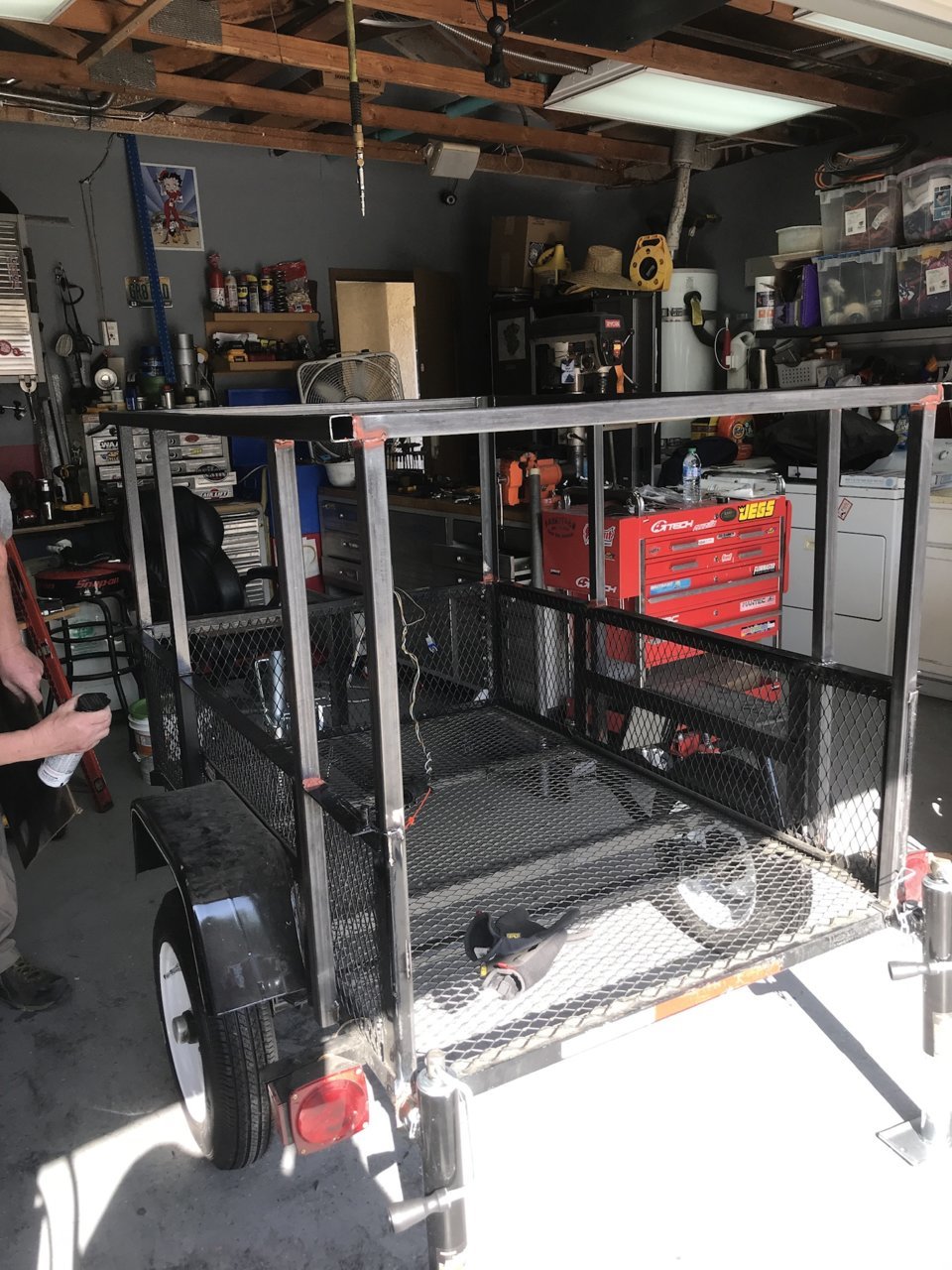

  14. Oct 13, 2019 at 10:35 PM
    67siia
    May 18, 2015
    #155493
    169
    J
    32164

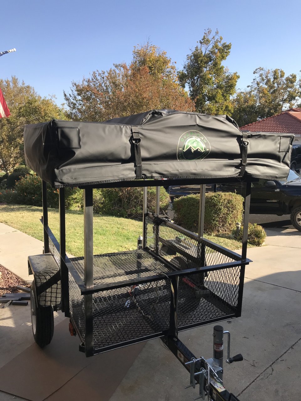

    More pics

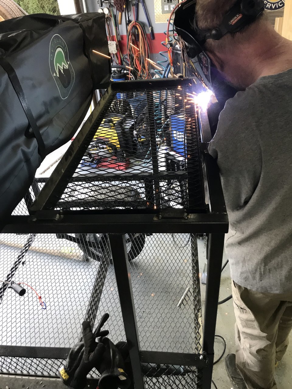

    More pics

    This trailer came with a “lift up” gate. Because I’m enclosing it and will build doors, we decided to use the gate as a shelf for firewood, etc.
    More to come in the near future.
