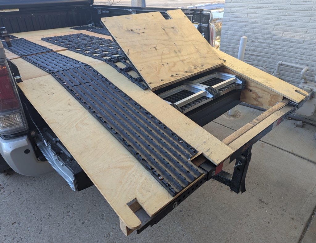

    Hi,

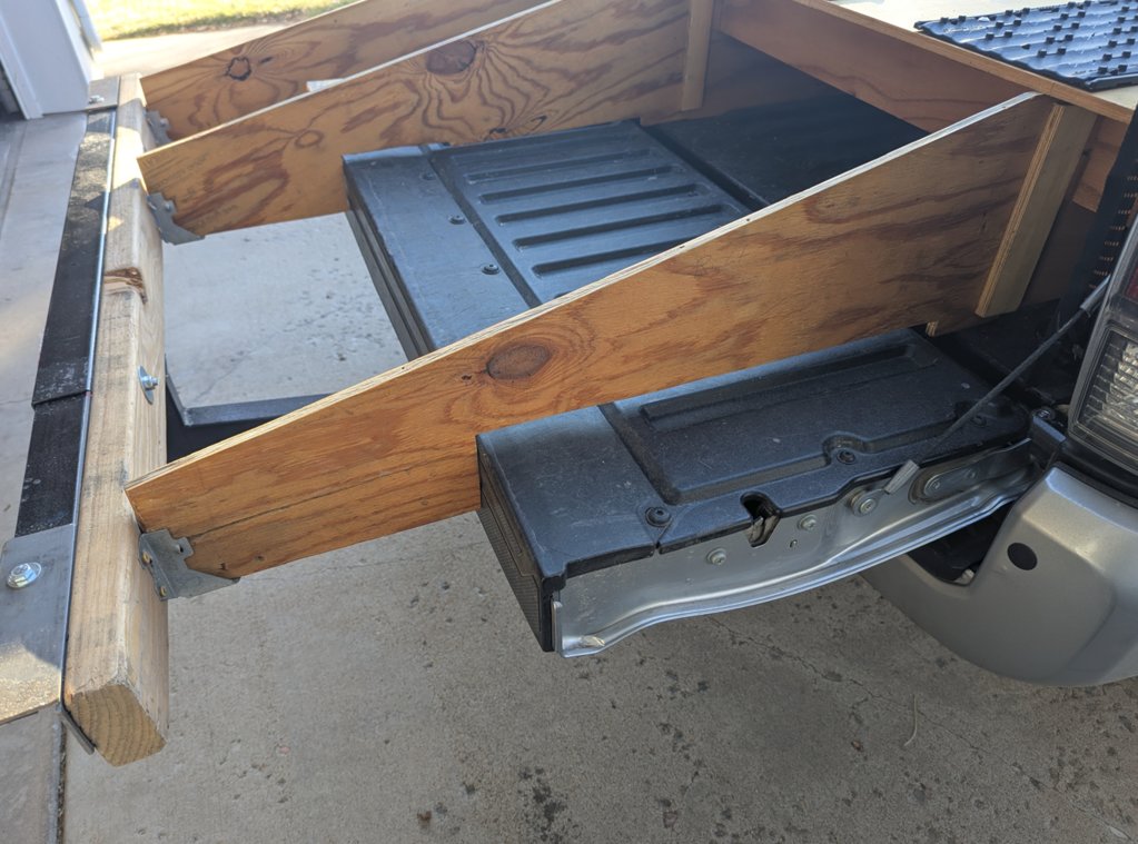

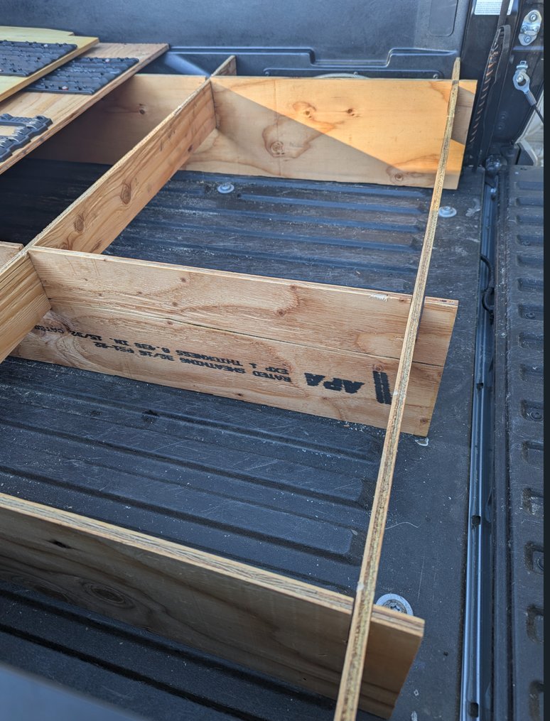

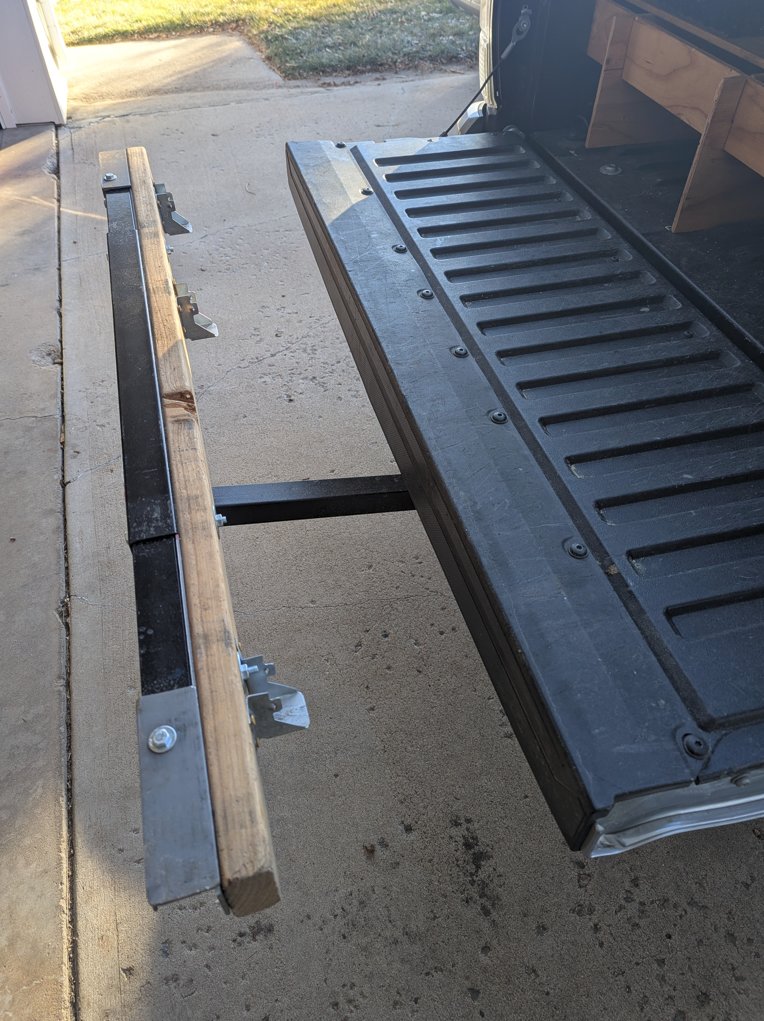

    I devised the following way to carry a snowmobile in my 2022 Tacoma TRD OffRoad Access Cab. As the Tacoma tailgate is supposedly unable to bear the full weight of a sled and rider, I designed something around this bed extender.
    I cut the extender down to the shortest length possible which puts it about a foot past the end of the tailgate. I then stabilized it with some flat steel and wedged thin metal into its joints to minimize rocking. I bolted a 2x4 onto it off of which I hung 3 joist hangers.
    The platform deck sits atop rips of plywood that are joined house-of-cards style for easy removal. The long rips are wheel-well height and the short ones are shallow enough for the longest ramp I could find to fit underneath when it’s folded up. The top of the platform is three pieces of plywood that just butt together and sit there. I did put a couple of slits in the front piece so that I could get my tie-downs connected to the D-rings in the bed.
    Between the extender and the platform I cut plywood “triangles” that sit on the truck bed on one end and on the joist hangers on the other, all the while not resting on the tailgate.
    I included a hinged door through which to access and stow the ramp.
    I finally put a couple coats of Wood Iron on everything.

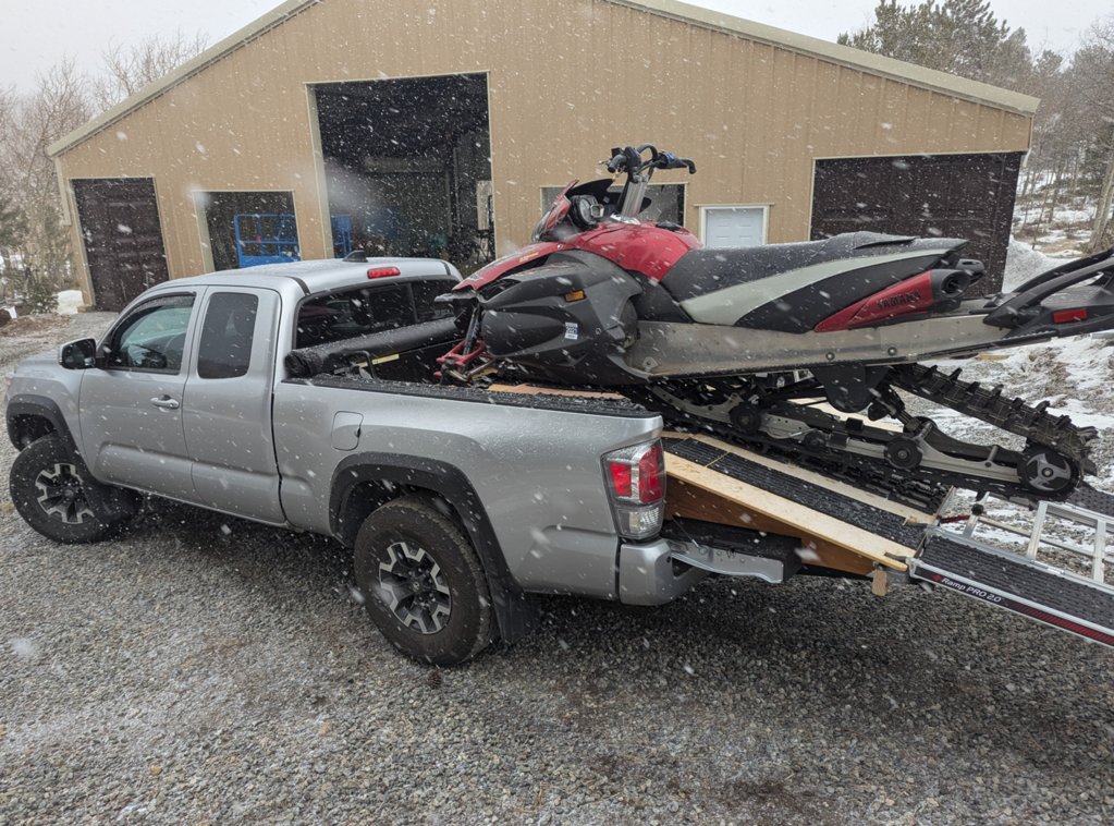

    Wanting to test it out, I drove over to a friend’s where we loaded up his behemoth 4-stroke and then drove it around on some local dirt roads.
    Initial findings
    I did not anticipate the track sagging down along the slanted part, making it impossible to open the door to restow the ramp. I have a couple of ideas to temporarily lift the back end as I would prefer to keep the ramp underneath the platform at all times.
    I will need a 1” longer bed bolt on the non-ramp storage side to help with sled theft deterrence.
    I haven't yet tested handling at freeway speeds. I may need to add something like SumoSprings in the back.
    HTH someone,
    Jay
    Legal disclaimer: don’t try this yourself or you will die. ;)

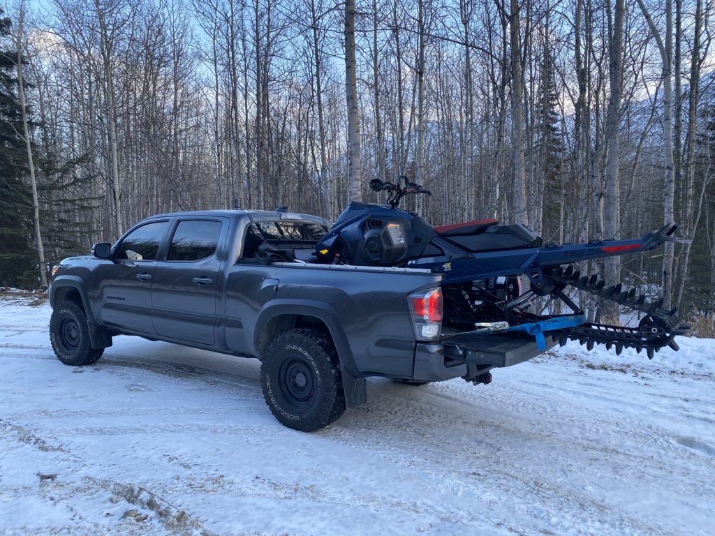

    Been running my homemade deck for 12 yrs now. I have a summit 165, pic below was my 154. Truck rides great, just need HD Dakars and airbags. And I have space for gear under the deck :)

    Ha. Yes, that's the beast. I figure if the platform held up under it, I'd be good with any other sled.

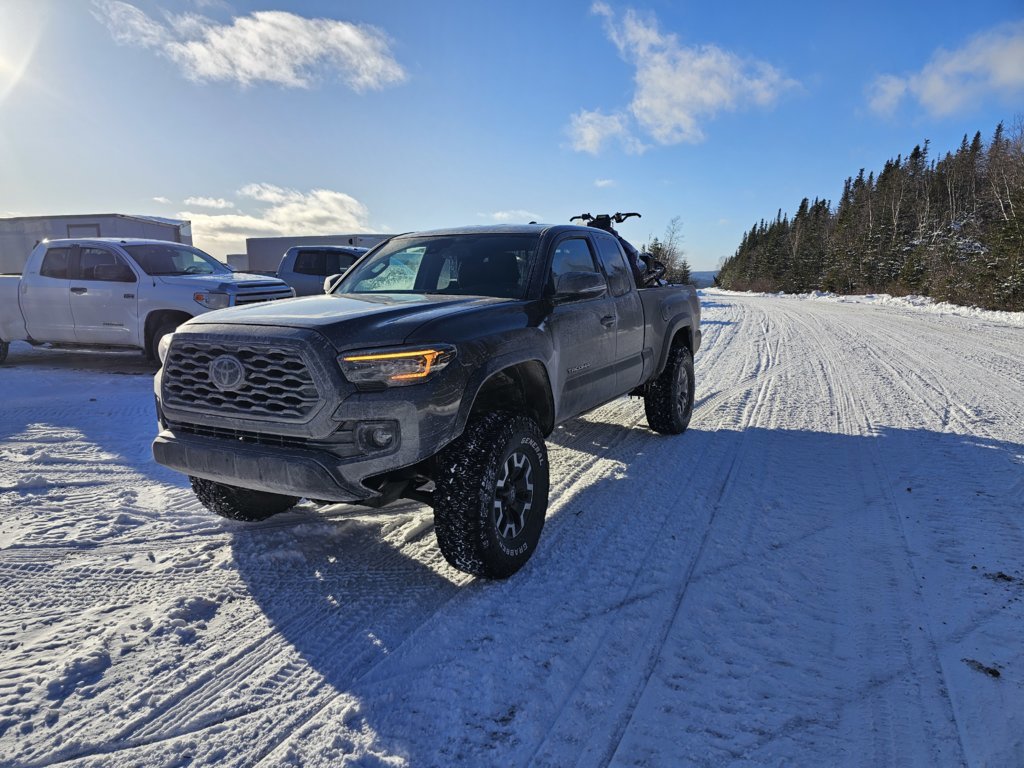

    i was confused why you were worried about the tailgate not handling the weight of a sled when ive seen people doing it and doing it myself without issue for 15 years on my 2 tacomas. then i seen it was a yamaha. understandable...

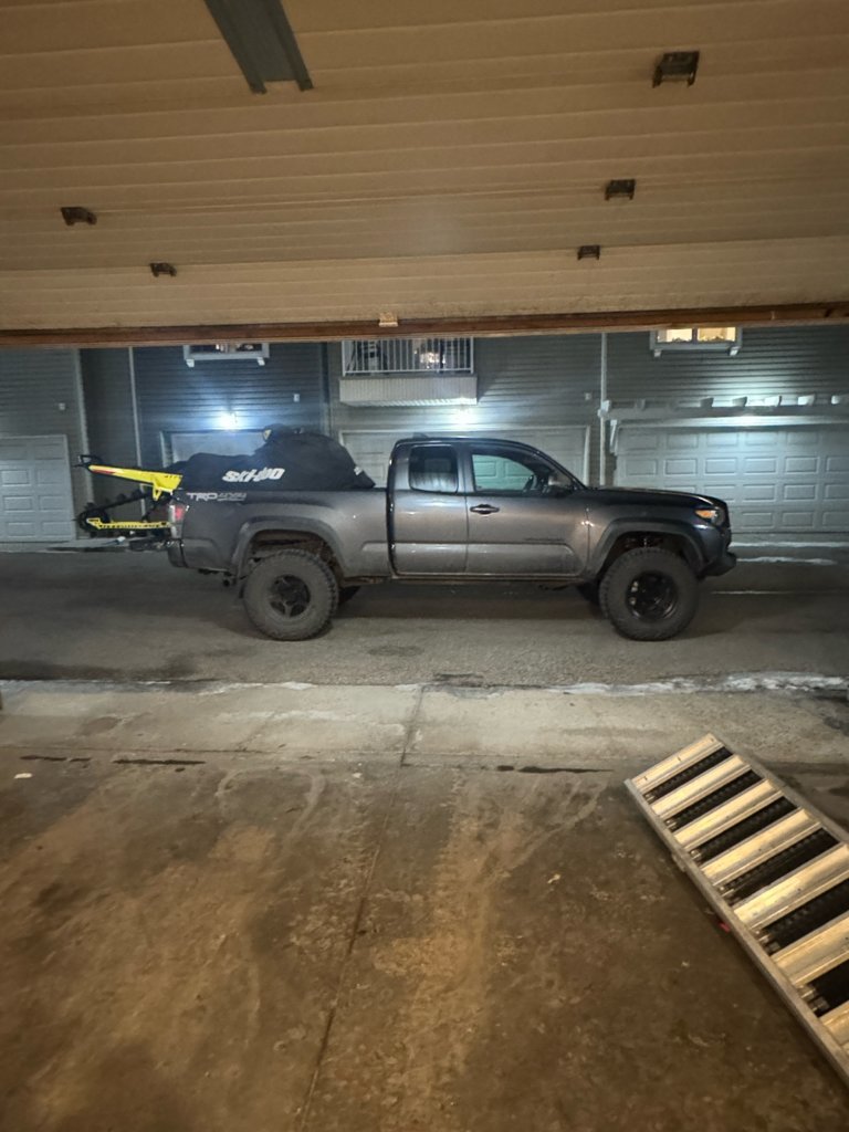

    When I first got my Tacoma I actually bought the access cab 6' bed to carry my sled. I have 8,000+ KM driven with this set up. I have had no issues with it. When I first got the truck I thought I was going to need to do something fancy to fit in in the back, but in all honesty it works without doing anything other then just having a trifold ramp. Only thing I'd do over again is PPF my tailgate, as the back roads have really chewed up my tailgate.
    I used to have stock leaf springs and they were fine, the OME springs I use now are better.
