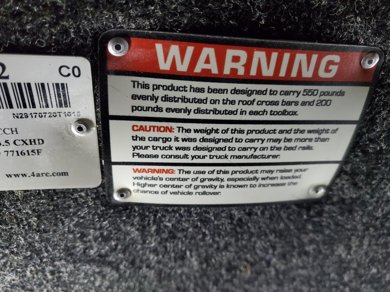

    I don't have the warning label like the photo above your post. I only have the factory label.
    Since topper usually carry about 150 lbs so the prinsu crossbars can carry 200+ lbs...
    I saw a video years ago that a guy installed the rack, he stood on the crossbars and walked around.. I can't remember who it was.

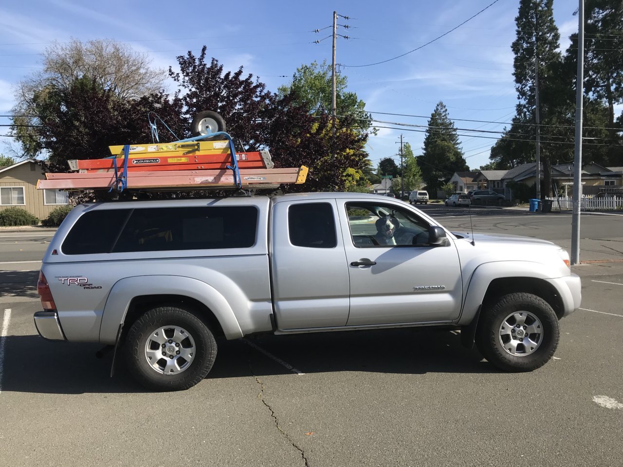

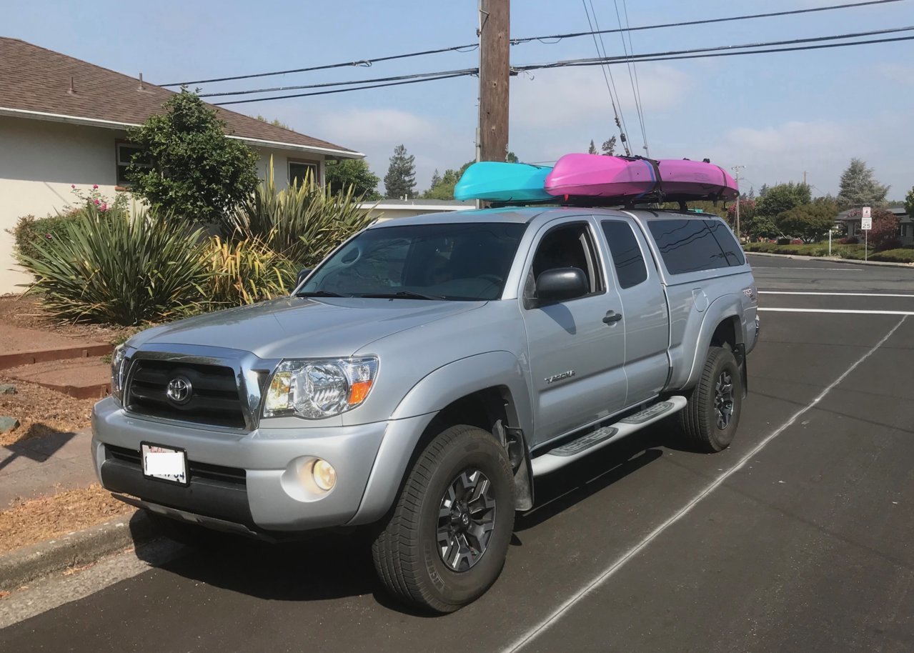

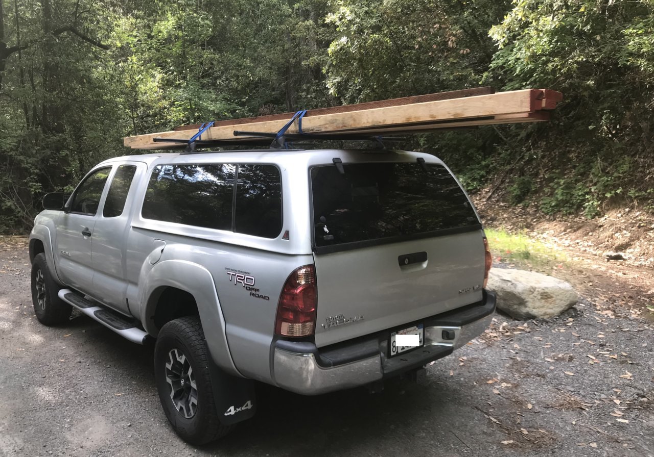

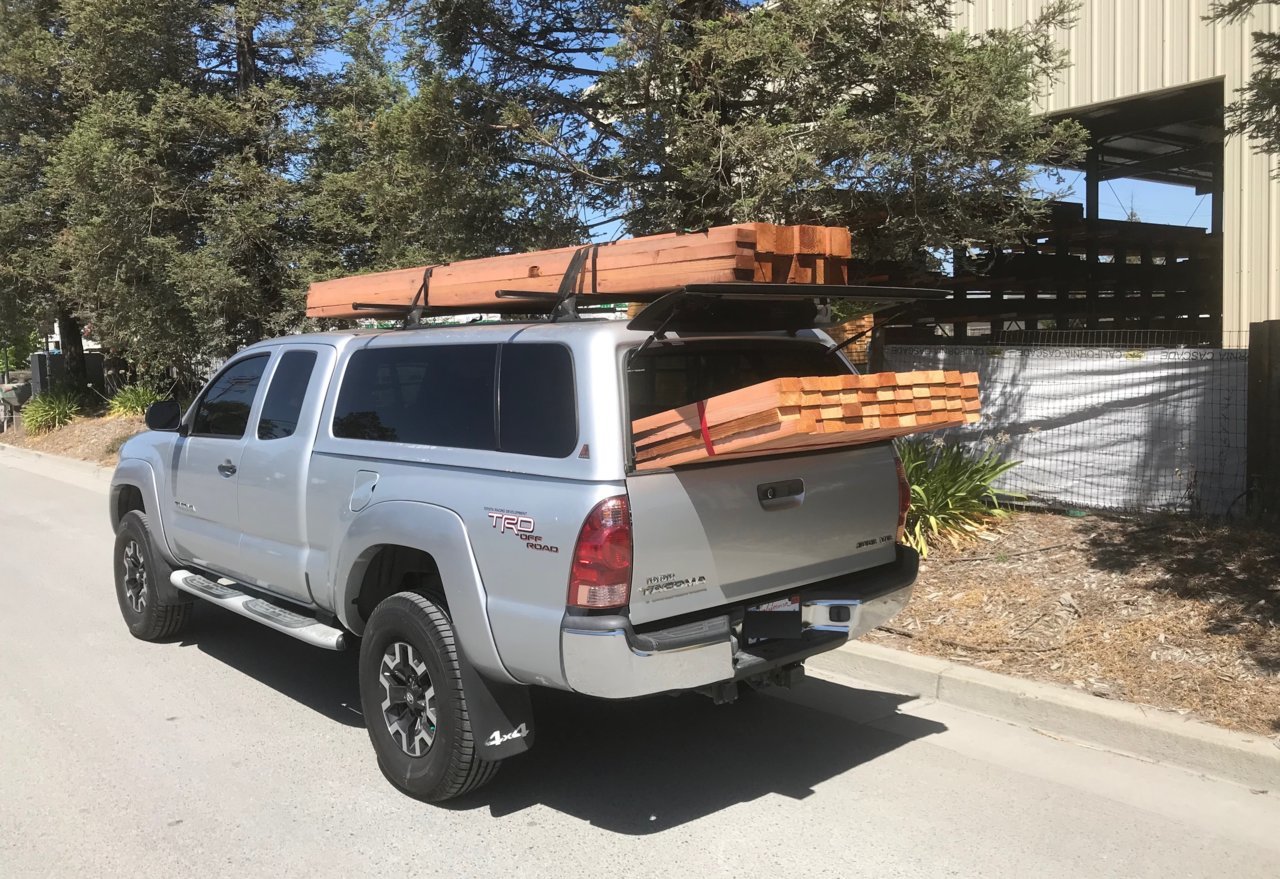

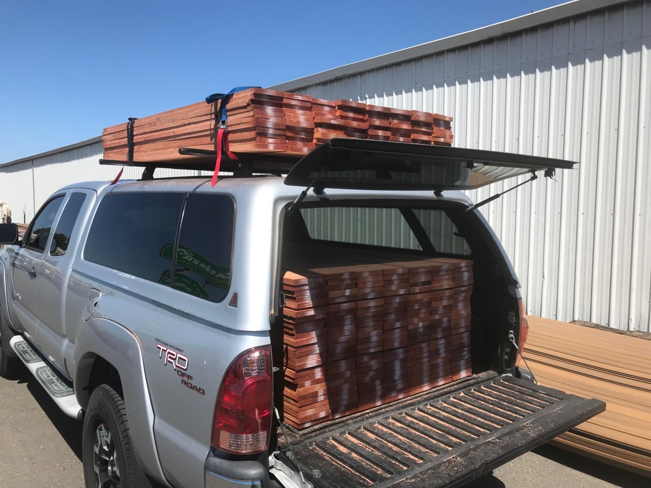

    Everyone has their own risk factor to weigh in on. I have severely abused my Leer 100XL for over a dozen years with absolutely no issues or complaints and I bought it used. The clear coat has gone bad but so has the clear coat on my Tacoma.
    It has Yakima tracks and bars that were on the shell when I bought it. No signs of stress cracks, sag, lean or twist. Maybe I just got lucky.
    Just a few photos loaded up:
    Taco fence1.jpg Taco fence2 copy.jpg Yakima bar load.jpg Taco Blake load.jpg Taco Kayak 1 copy.jpg
