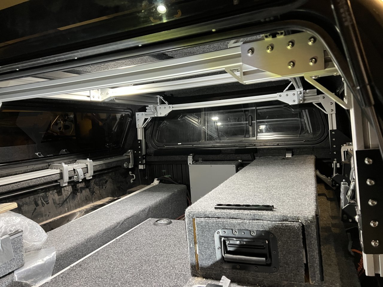

    The HD racks don’t actually carry weight on the topper. There are 4 posts through the topper that connect to the frame inside. The weight they carry is on the internal frame. Those are designed to carry weight.

    I looked into this until I just gave up asking. My best guess is none of the topper manufacturers want to be responsible for stupid people doing stupid things. I figured if it breaks it’s on me so I put a front runner rack on it and loaded it with a 100 lb tent and slept in it off and on for a year.
    I had no issues so I added 150 lb tent and my wife and I both slept in it a few times, still no issues.
    I did finally decide I didn’t want it to collapse on my wife and I so I reinforced it myself. So far no problems.

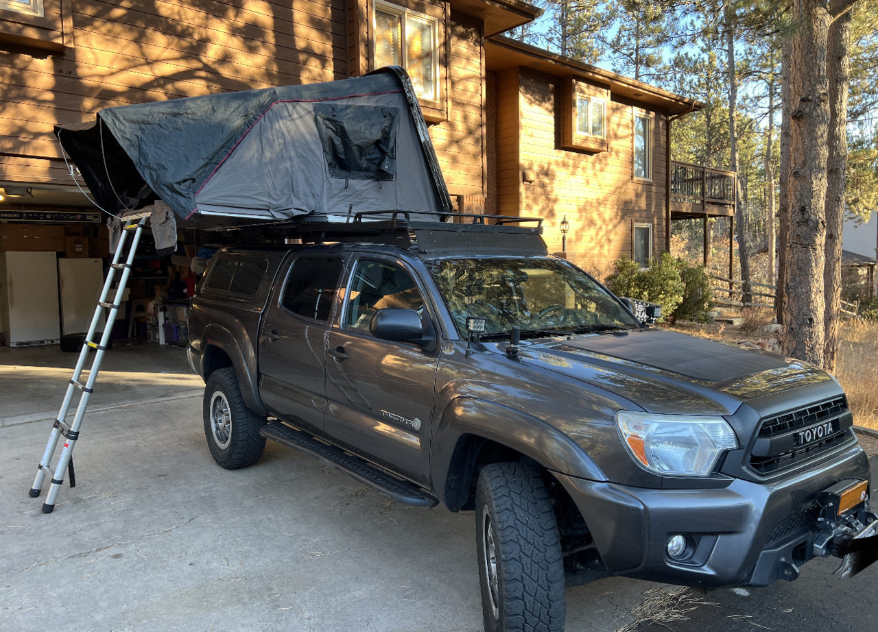

    I know this thread is slightly old but what specifically are bed stiffeners? Are there products to build those internal topper frames?
    I have crossed the country multiple times just like this and more:
    Should be able to carry a RTT you would think, especially if I added a thrid cross member? The truck and top will soon be 18 yo.

    I have an Leer 100LR something or other(Basic Fiberglass Topper) and have had a couple different tents up there no problem. I installed FrontRunner Tracks and 1" unistrut on the inside under the tracks. I also have bed stiffeners. I have never had a problem or even worried about a problem. There has been zero movement, deflection, or hint of weakness out of the cap in the years I have had it.
