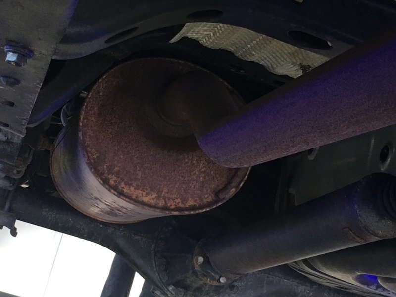

    Just picked up a 2012 Tacoma SR5 4x4 with 22,000 miles on it. It's originally from Pennsylvania and has some rust on the under carriage. Is this normal wear and tear? Or is it road salt and ice damage?
    Anybody got pics of their 2012-14 that I could compare?

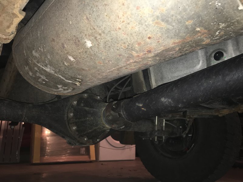

    Currently covered in salt, so they look dirtier than normal.
    Carrier bearing
    Muffler and rear end.

    Thanks dude.. looks like mine is pretty crusty and rusty comparatively.

    It does, but luckily it just looks like it is surface rust or on non important pieces. I would check up through the frame to see how it is. Probably never really washed much and may have been sitting for awhile considering how crusty the exhaust is. I recommend you get in the habit of washing the undercarriage a couple times a month during the winter. Any cheap automatic car wash with undercarriage washes will do. Come summer time, you can clean some of the rust off and paint it.

    No problem. Don't worry about the exhaust being rusty, that's normal. It isn't a protected surface nor is it stainless steel, so it's gonna rust. Like @ABNFDC said, the frame is what you really want to check.
