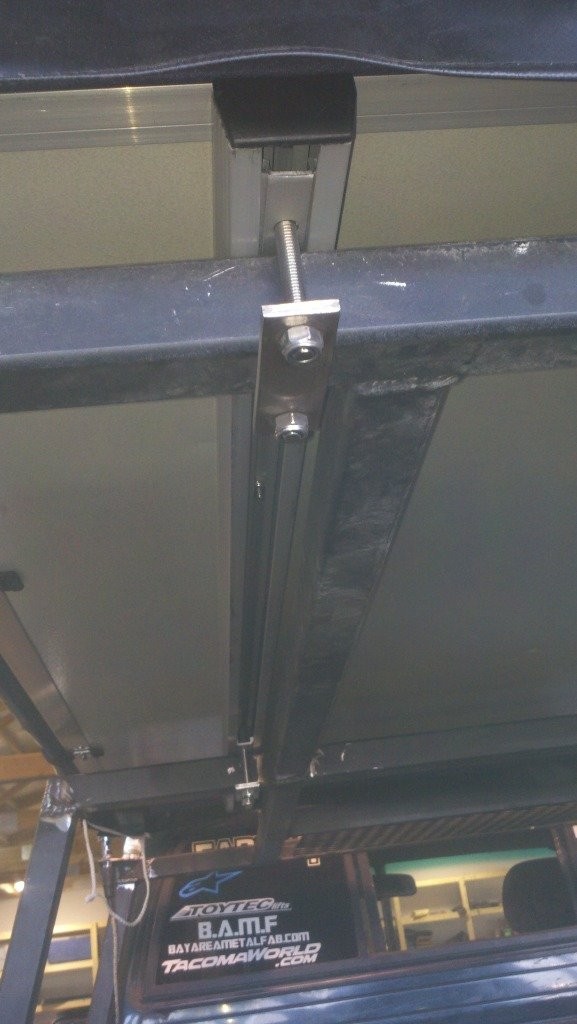

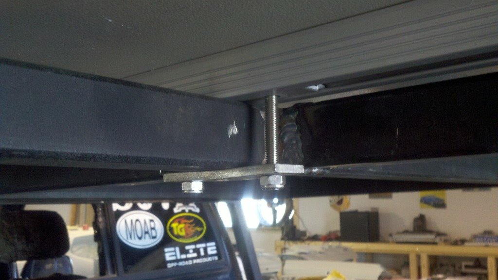

    The bolts can be anywhere in the rails. The rails you mount the tent too need to be just a bit less wide then the tent.

    thanks for the photos, helped alot. I wonder if I should have square tubing welded in instead of tubular. Looks like the mounts work better with yours.

    it may vary between models but mine (bachelor) is about 32" rail to rail

    i guess it would have a better contact...couldn't hurt i guess haha
    yea thats the distance between the rails. Should be the same for the Shasta.

    i am getting a square rack too...I think the main thing to consider between round or square is that the maximum width/diameter is 1-1/2"
    but the bachelor and shasta are the same tent and same base size...I don't know about the larger models

    I used round tubing to build my rack, and in hindsight the square stuff would have been easier to work with. I think round looks better, though. I forget what size tubing I used, doh! Must be getting old, hopefully I don't forget where I parked the tent when I go camping.
    As far as mounts, I will probably hit the local big box hardware store for some ideas -- there's nothing really fancy about the mounting system, and some kind of curved clamp should work better on round. That siad, the included system is designed for roof racks that are typically round or oval, so it should be fine.

    round does look better..but square is a bit easier.
    I woulda don't mostly round if i had a bender.
