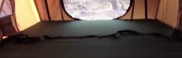

    Screen%20Shot%202015-05-12%20at%206.26.5_2ed50050b7253e2ffbc32f24419d82ce11140f82.jpg
    What are these straps for? The ones currently on top of the mattress.

    Weesa
    Bob's secret mod lair
    that's the upgraded bondage package....
    no, really they're to help get in/out of the tent. grab the loops at the ends to steady yourself when entering/exiting

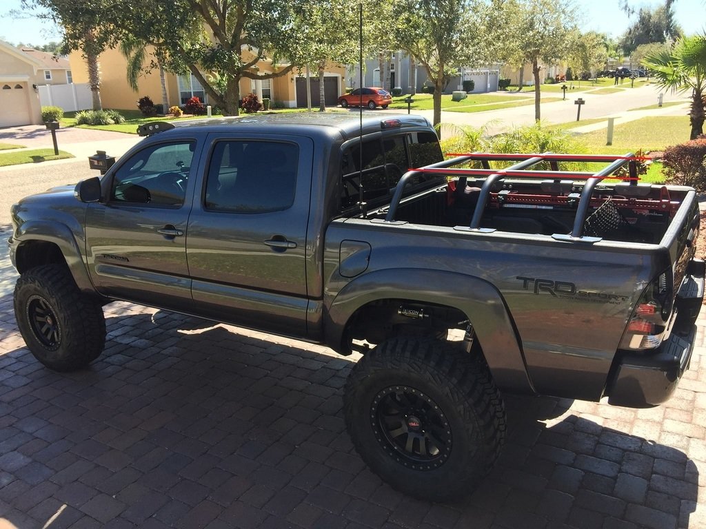

    I understand. But I'm considering something like this, from Relentless:
    My concern is if those bed bars, running the length of the truck, happen to line up exactly with the rails on the CVT tent (in red). If that were the case, and I was unable to reposition the rails, I think I'd be screwed. I certainly wouldn't want to offset the entire tent that much to either side of the truck just to avoid those bars.

    I have the exact Relentless Bars in the pic above and a Mt. Rainier from CVT, I will mount the tent tonight for the first time and take pics of it afterwards if it helps any. I bet if you ask Bobby of CVT he will take the measurements you want.

    2023 SR5 Tundra
    Ah I didn't notice the bars running the length of the truck bed! I just have the regular bed bars that go across the bed. I'll still post pics though, I'm almost through the install.

    Hey bud, I didn't forget about ya, had some things come up tonight to which delayed my install. I just finished my install, one thing I will mention is I had to buy longer bolts to allow the brackets fit around the Relentless bars. I'll get pics tomorrow when there is more light out!
