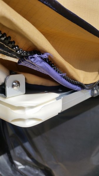

    Anyone have their tent canvas start coming out of the channels on the base? I've taken mine out a couple of times, and notice the the tent canvas (edge closest to ladder) has started to come out of the channel that is on the base of the tent. I'm going to try to get pics but I was hoping someone else would have experience in this....

    Finally I have taken pics...anyone have an idea to place canvas back in channel?

    My guess would be to pull it all the way out and slide it back in :notsure:

    if you can't push it back into the channel my guess would be that you have to remove the entire length/side(s) and slide it back into the channel (while the tent is closed). the tent walls slide into the base the same way the travel cover and annex walls do...

    This will happen. When you close the tent take and slide the fabric out a little bit and then slide it back in the channel.
    When you close and tuck the tent in you can pull the fabric out of the channel. Super easy fix. You just need to do it when it is closed. If you have problems please let us know.

    Appreciate it, I'll give it a shot!!
