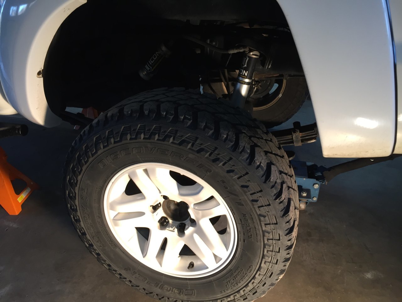

    Got a good mod done this weekend when Skip came up for us to work on his truck. We installed the Deaver stage 3 expo leaf packs in mine 9 progressive leaves with 2 over loads and a set of Bilstein B110's. I still have to install the extended brake lines.

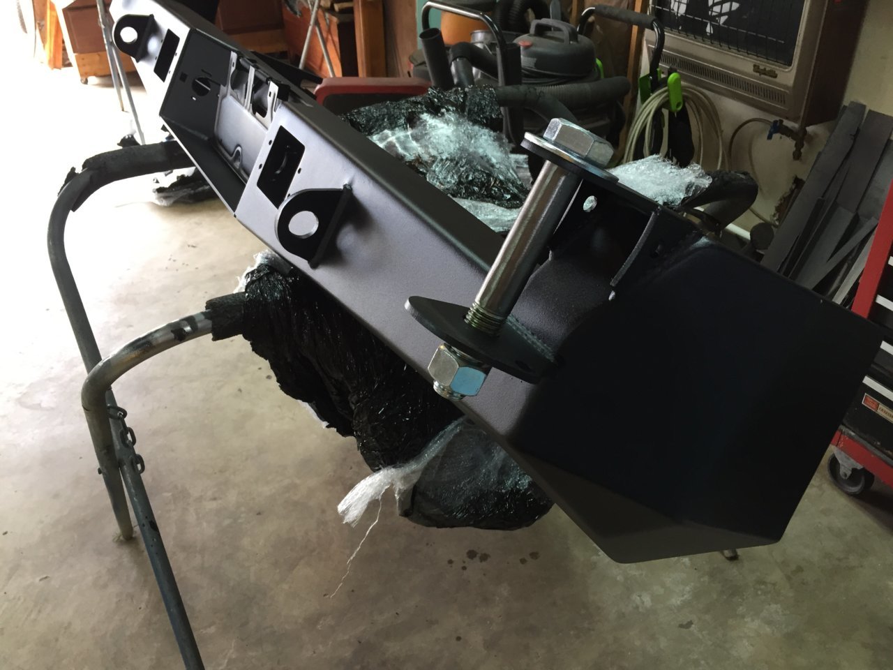

    Skip brought me my new bumper from SOS also I'll need to get to work on this here shortly.

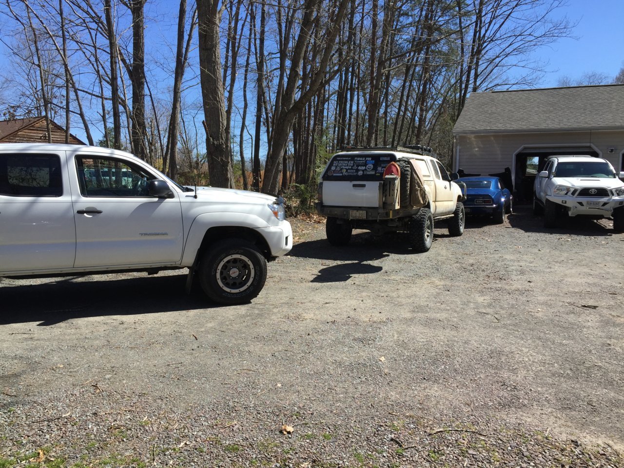

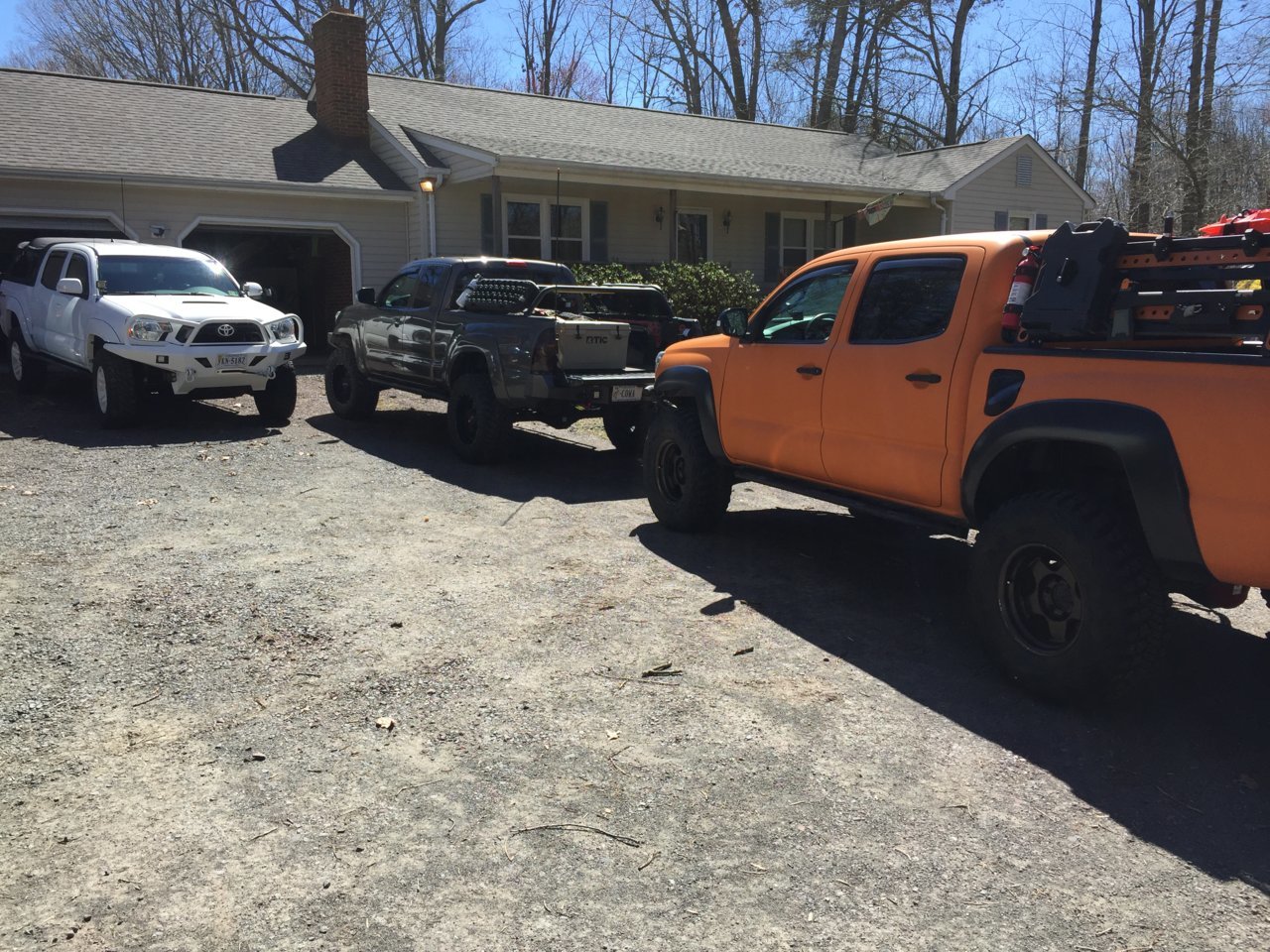

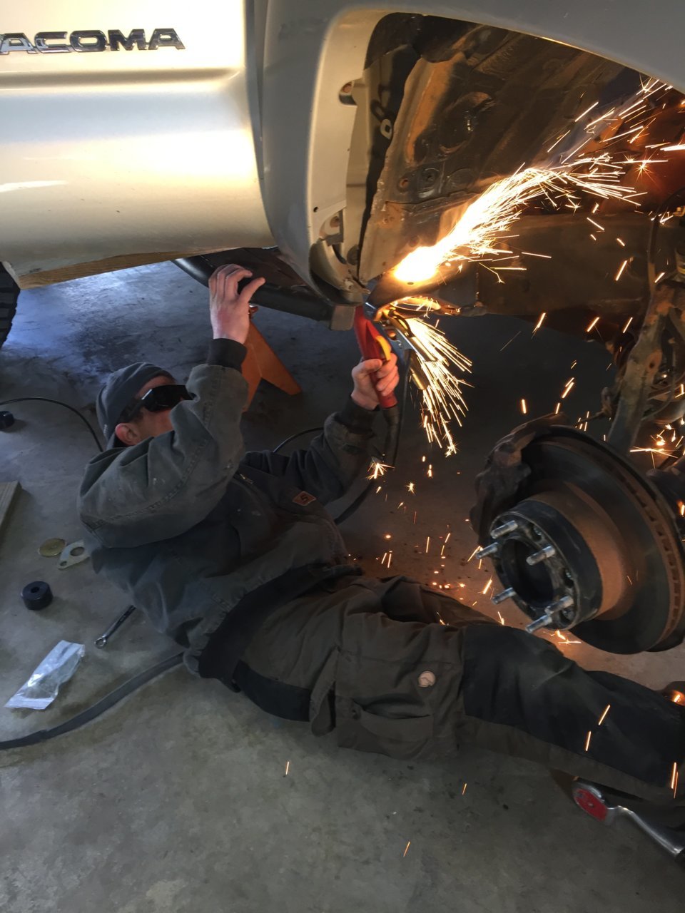

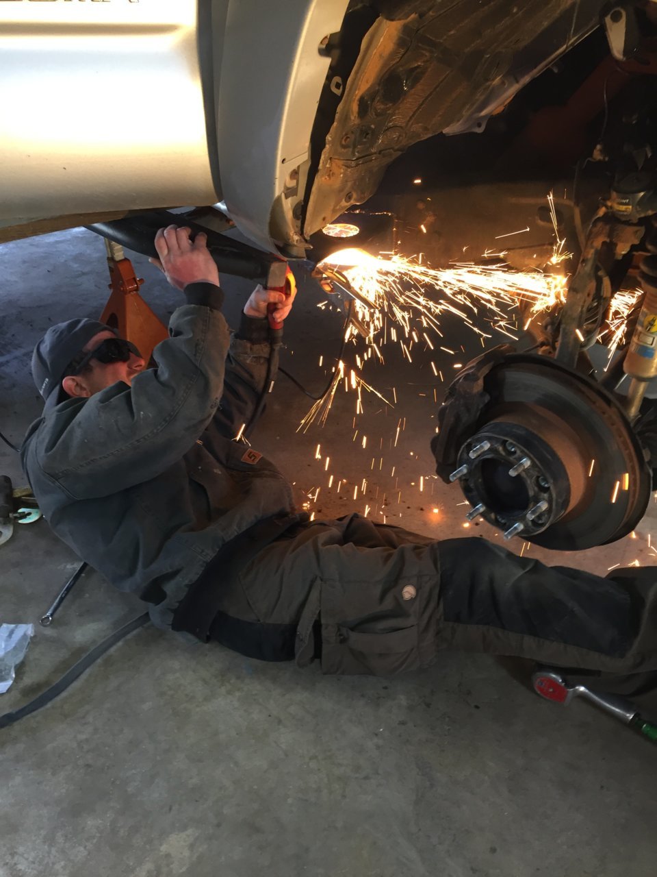

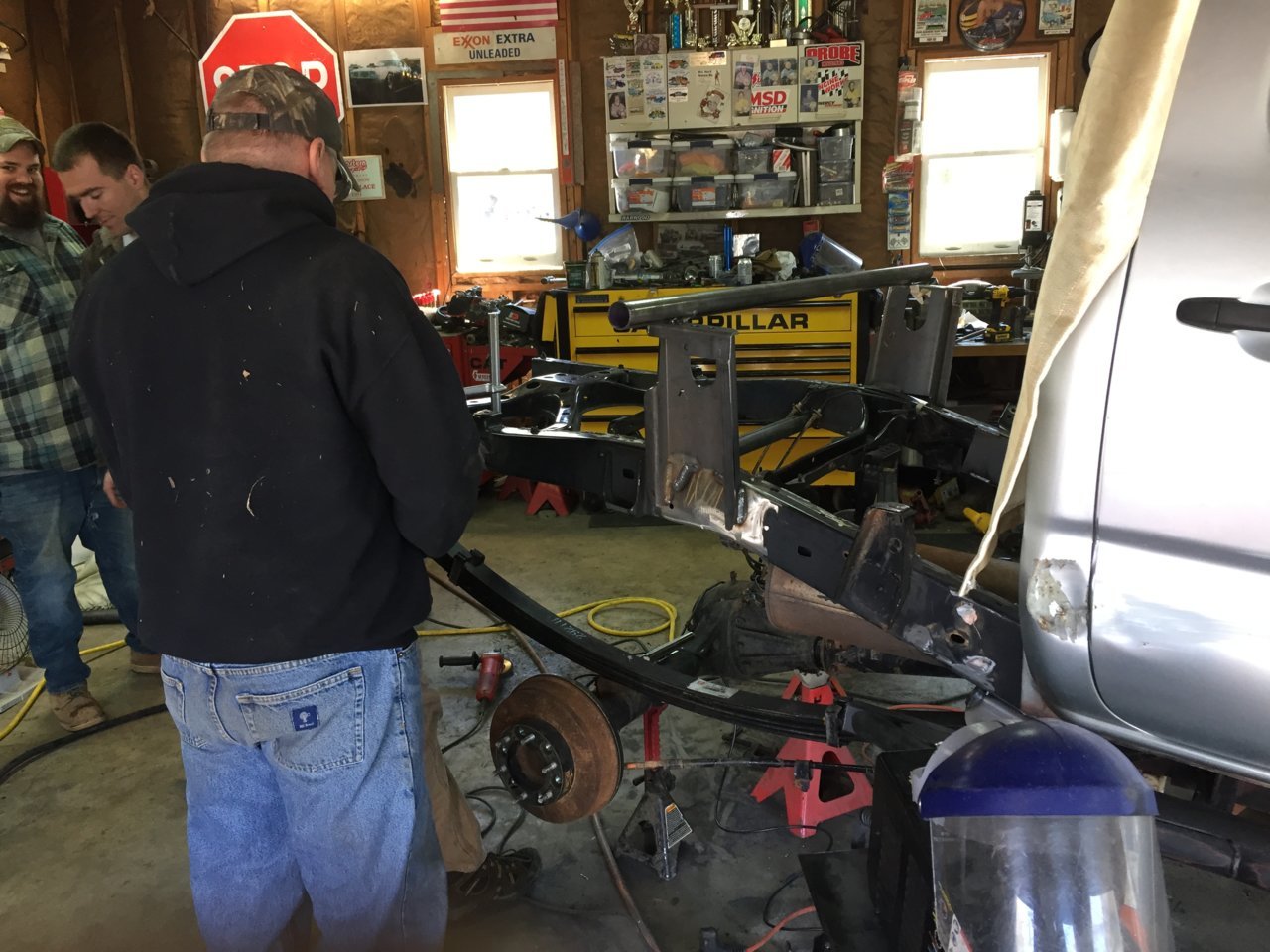

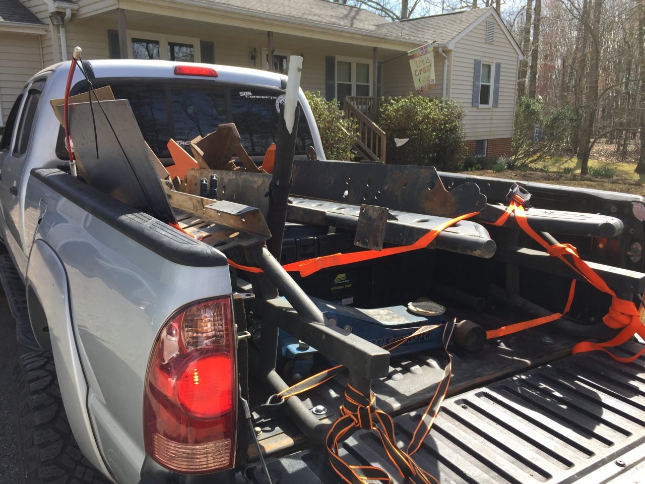

    We had a big weekend this weekend. Skip @ovrlndkull came up from NC on Friday. He brought my new bumper and a whole truck load of stuff. We have planned this weekend for a couple of months and boy what a weekend.

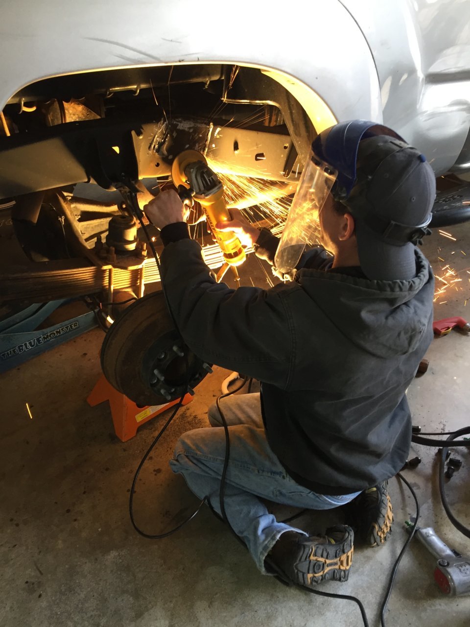

    We started Friday at 1PM as soon as he got there. We unloaded the truck then pulled it into the garage and the fun began. We started by cutting off the upper shock mounts and tacking in place the new Archive garage extended shock mounts. Then we pulled it outside and removed the bed and backed it back up to the garage and power washed all the rear frame.

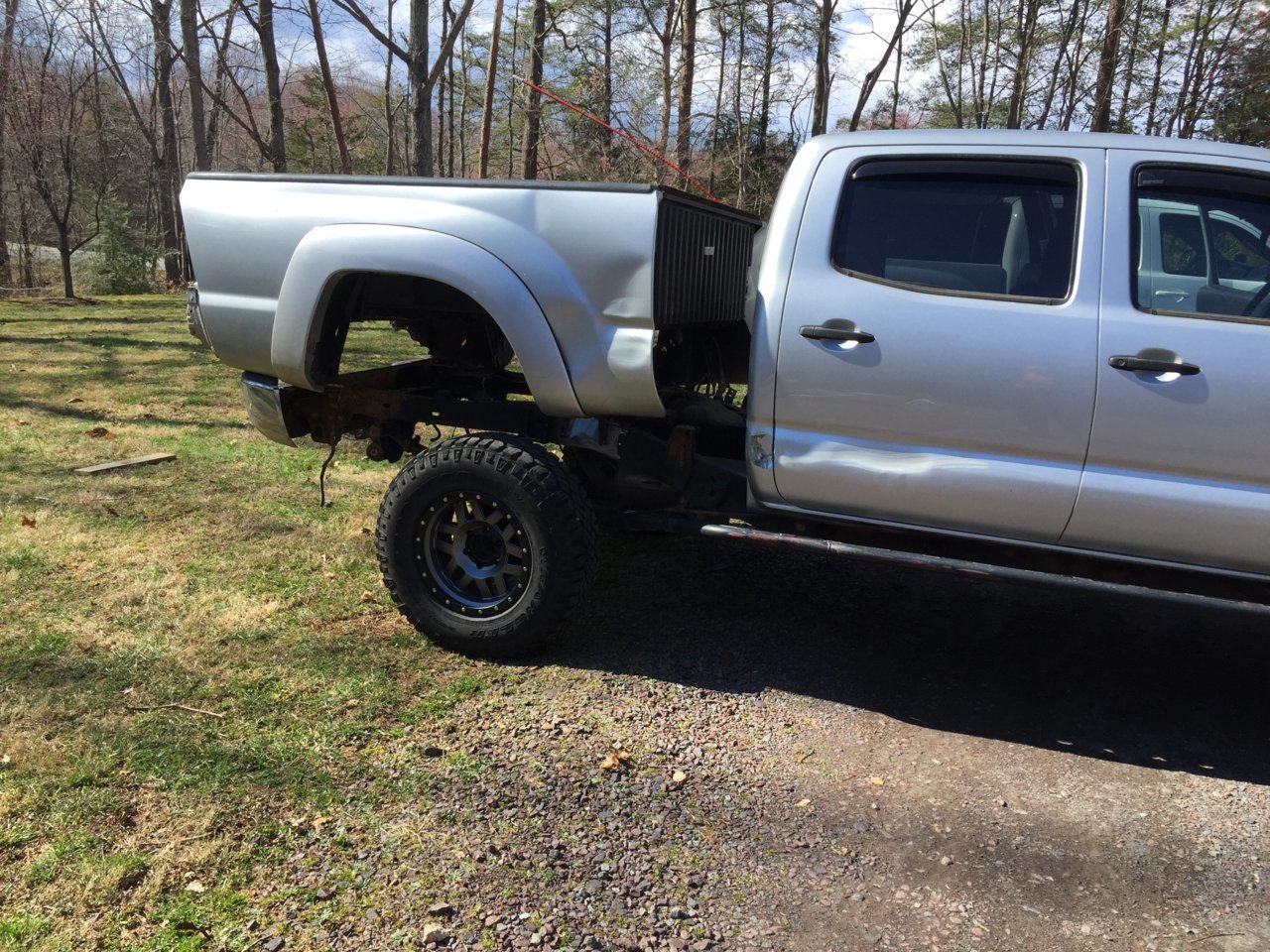

    We pulled it back into the garage and moved it so it sat sideways in the garage and we had plenty of room to work. We dropped thegas tank and took it outside and got it out of the way. Then we removed all the oem leaf spring mounts. Fun stuff but it wasn't as bad as we thought it would be. Skip began welding all the new leaf spring mounts up while I began cutting 1/4" plates to box the frame. I borrowed a steel cutting skill saw from a buddy and it and the plasma cutter made good work out of the frame plates and removing all the mounts. We finally called it quits about 10PM
    Saturday was the big day! We started about 6:30 in the morning and finished up cutting the frame plates and welding up the mounts. Everybody got here around 7:30-9 am and the mayhem began.:
    The frame was completely boxed all the way up to the cab.
    A cross tube was welded in above the axel for bracing and to munt limit straps
    the front leaf mounts were tacked in place
    The Chevy 63" leafs were attached to the front mounts
    Then the fun began figuring out the proper placement of the rear leaf mounts and what was the correct shackle length to use
    The Ubolt flip was installed
    Then the suspension was onbolted and everything was welded solid
    Everything was painted and the suspension was reinstalled
    Lower shock mounts were cut off with the plasma and grond smooth
    New lower shock mounts were located and welded in place
    14" 2.5" KINGS with RR's were installed
    The RR mounts were welded in place
    Installed a new bed side on the passenger side
    The gas tank was reinstalled
    The bed was reinstalled
    Finally the rear bumper was reinstalled
    A big shout out to all who helped. It was a long day @EatSleepTacos , @PyritePirateBill , @boogie3478 , @pabstsmeared these guys hung in like troopers until we had the bumper on. What a huge help not just physically but mentally helping to figure out all the measurements and getting everything set right. Skip and I kept going until we had the tailgate on, tail lights, and some other odds and ends and we loaded a bunch of his stuff up. Christie kicked in helping to supply a great breakfast and Mac n cheese with dinner and Bill brought some great potato salad I just smked some ribs so I could keep working, in the smoker for 7 hours. I figured if these guys were going to drive all the way out to my house and work all day I could at the very least feed them. I haven't ever done a work party like this so I didn't know what the norm was but I don't believe anybody left hungry at least.
    We jumped up this morning and got to work around 7 and jumped strait onto my suspension swap. Then we did cab mount relocates to Skip's truck completely removing the oem cab mounts and installing new ones a couple inches further back. This wasn't as bad as we thought it would be but still took some time to remove the oem ones. Skip finally left here around 3. So I figure we each had about 33 hours into this weekend. Very busy but alot of fun and educational.
    I think Skip left hauling back more than he came with.
    There'll be a pretty good write up in his thread.
