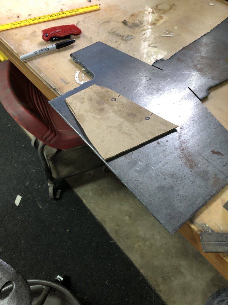

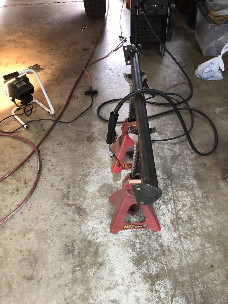

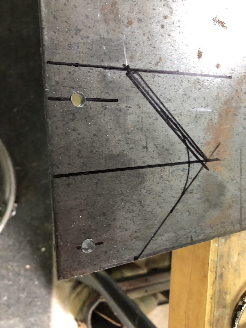

    Installed the hammer hangers from @ARCHIVE Garage a couple of weeks ago and hve been super pleased with them, the product quality, and customer support Eric provides. When I got them I did not opt for the cross tube as I have the means to make it and it seemed to be a fun little project even with limitted tooling.
    Just the hangers:
    I started with getting under the truck and creating a cardboard template. Not entirely necessary but helps to figure some fitment issues out and how I wantd to position the tube itself. Thanks @EatSleepTacos for letting me bounce a couple of ideas off of you. Sometimes it just helps to think outloud.

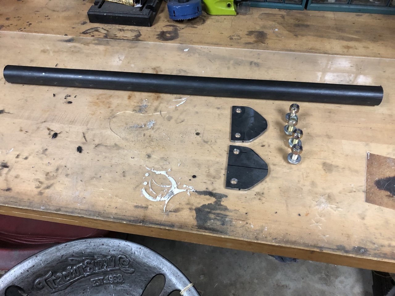

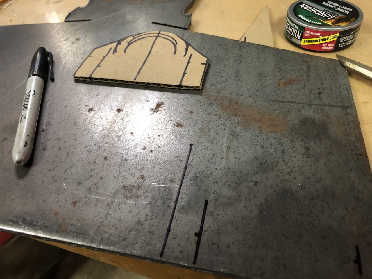

    I had plenty of 1/4" plate and extra grade 8 1/2" hardware so the only thing I needed to purchase was the tube itself. Next step was to transpose my measurements over to the 1/4" plate and draw out the plates and center punch for drilling. Then precutting the plates I placed it in the drill press and drilled a 3/16 pilot hole and finished with a 1/2" hole using the bits purchased from Archive for the HH installation. I then cut the plates. It was just much easier to handle the plate in one piece as compared to the smaller cut plates.

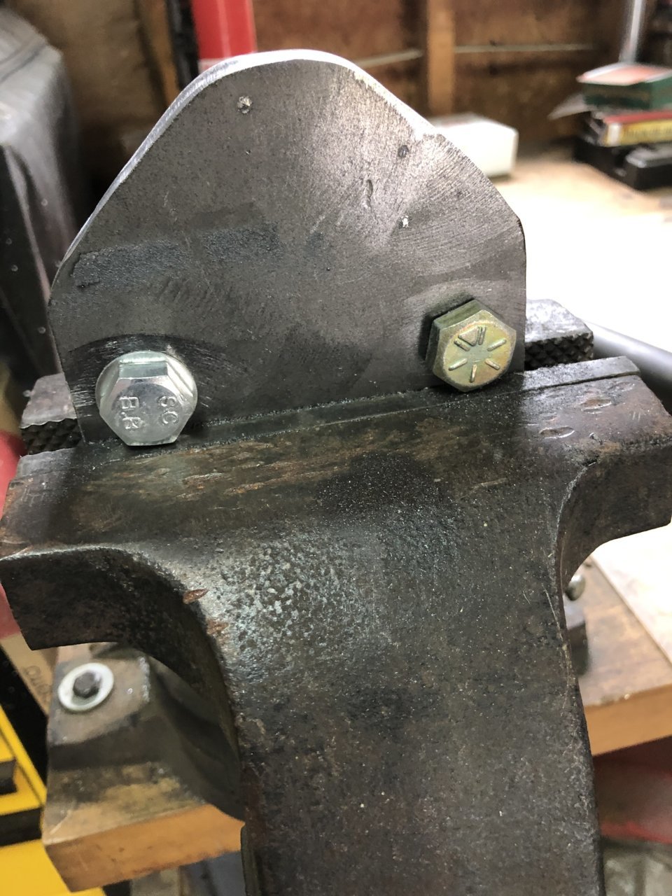

    I attached the plates to the HH for a test fit then bolted the 2 together and ground all the edges and rounded all the corners as one piece to keep things uniform. Necessary? Not really but for appearance sake and uniformity to placing the tube in a uniform location it helps.
    So all associated parts are together and ready for install.

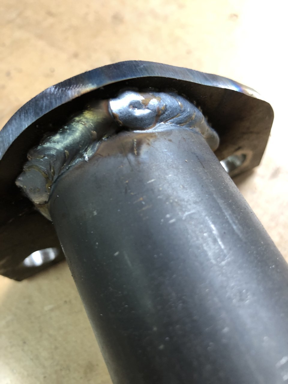

    So today I brought the truck back into the garage, installed the plates snuggly not completely torqued, measured and cut the tube and bevelled the edges, and tacked into place. I removed it as a unit and set on top of a couple of stands and welded all the way around. Felt good I haven't had the welder in my hand for a couple of months.
    I smoothed all the edges and knocked all the nibs off, sanded the tube, etch primed, and painted
    I installed it on the truck and torqued the nuts
    Thanks again @ARCHIVE Garage for all your help through this
    lynyrd3, Zebinator, Slashaar and 8 others like this.

    What is the point of the bar going across from side to side?
    lynyrd3, Slashaar and Casper66[OP] like this.
  12. Mar 29, 2020 at 7:17 PM
    #2652
    Casper66
    Casper66 [OP] grumpy ass
    Apr 3, 2016
    #183160
    32,001
    Culpeper, Va.
    '15 DCSB TRD Sport 4wd super white (sold) '13 access cab SR5 4wd
    piddly stuff
    It stiffens the rear section of the frame. The hammer hangers help by removing flex from the weak stock spring hangers and by tieing them together it helps remove flex from the rear frame section. If I did any rock crawling it is also supposed to help stiffen the hangers in the instance of rock impacts. I wanted this strictly for the towing aspect. It’s also supposed to help with just daily driving. I know the hangers themselves have really tightened up the rear. It doesn’t create a more rough ride but feels more solid especially in curves and bumpy roads. I’m sure @ARCHIVE can explain better than I can if I left something out
