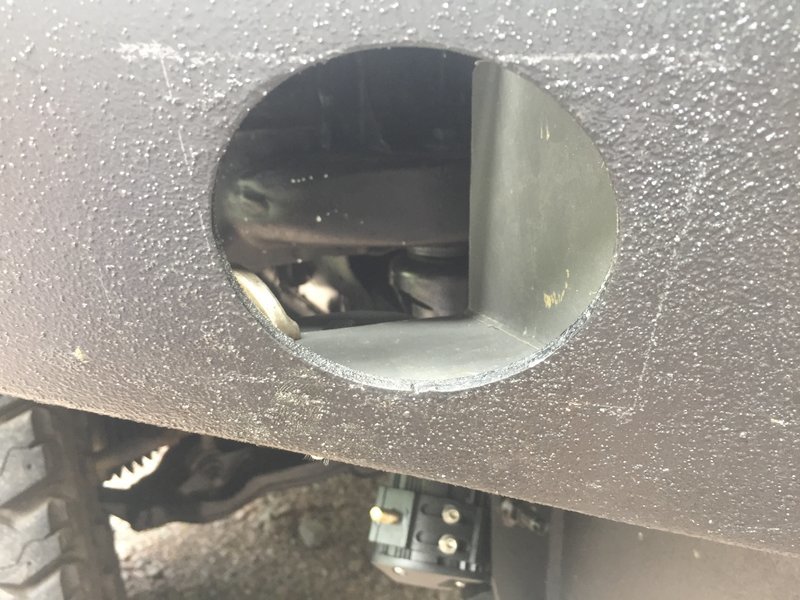

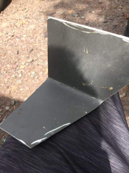

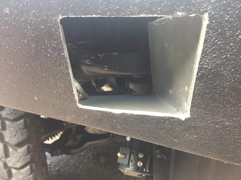

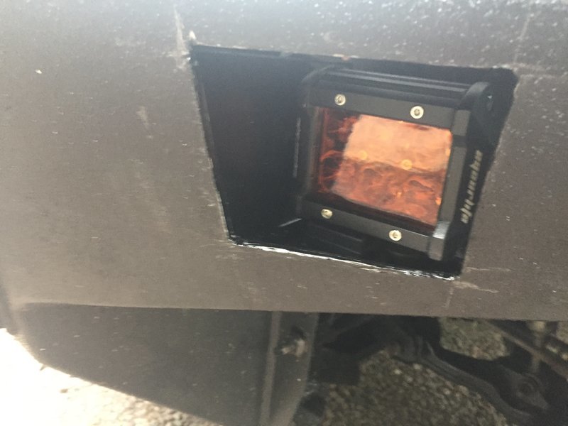

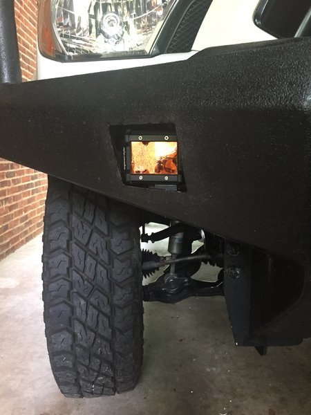

    The fit a square light in a round hole mod:
    Damn @Kemosabe asking me what I've been doing. I got outside today and decided to tackle something that's been bothering me. My fog lights hiding in the bumper which is what I was asking @Acerwin about yesterday. What a fiasco that was. It took me most of the day with my limited tools here to make half decent cuts in the bumper, fab up some aluminum fill plates, and get everything remounted and pretty well lined up. It's no fun trying to cut this stuff on a plate that's angled in 2 different directions. I may go back and make some adjustments but at least now I should get full bennifit from the lights. I'm going to do this a little different and do it with captions for the pictures.
    Bumper had round holes and with the swept back design the square pods wer forced to sit back in the bumper and were partially blocked
    I decided the best route here was to cut the holes out to a rectangular shape alowing the full light to be exposed. In the pictures it looks weird because of the multiple angles of the bumper surface I'm assuming. They kinda look more trapazoidal or something but they're really not. These pics show the marking and cutting of the hole.
    If the hole was left as it were there would have been a large open gap to the center of the bumper which would have looked like crap and let some of the light from that side of each light stay trapped behind the bumper defeating the whole purpose in this. I grabbed some cardboard and fabbed up a template for a blocker/ filler bracket to go in the bumper it runs across the bottom of the light allowing me to relocate it further forward and then up the inside to fill the void. With the brackets painted I mounted them, drilled a hole to relocate the actual light, mounted the lights, and touched up the cut edges. Like I was saying in the pictures the shape will look a little weird but everything was cut square perhaps that's the issue.
    Filler plate fit to shape and broke to 90 degrees you can see the multiple angles
    Cut hole with the filler plate you can see it along the bottom and up the rt side this was the passenger side.
    Everything mounted pics from both sides.
    here you can see the filler to the left of the light
    That was a job. I may get some edge trim just to dress it up some and may end up trimming a little more later. When the bumper comes off for a winch or reinforcements I may weld in the filler plate as a gussett but that will mean stripping and recoating the bumper.

    cutting this bumper really threw me for a loop the pictures make it look all wonky but it's really pretty square. It was a catch 22 kinda thing I couldn't tell what it would look like in comparisson with the lights until I could get the lights in place yet I couldn't get the lights in place until I cut

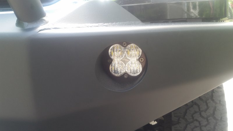

    James
    Anywhere is home
    2014 Baja
    Y'all are crazy trying to fit squAre lights on round holes!
    I took the easy way out!
    Nice job making a round hole squAre C!
