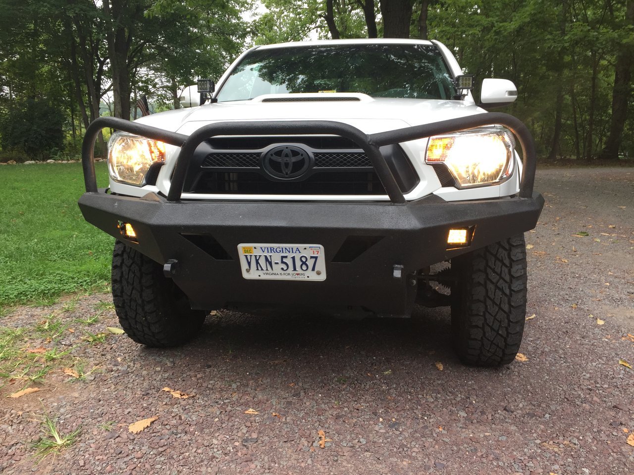

    Front Bumper:
    We got an early start this morning! My darling wife, AKA the boss, jumped up with me and went out before she went to work and helped me pick up and set the bumper. It's all aluminum so not very heavy but trying to be safe. I took my time and removed the light bar that came with the truck and set it aside, removed the plastic bumper cover, and crash bar.
    Christie came out and helped me set it and held it while I got a couple of nuts started. I shimmed the top out a little with washers to bring the back of it up a little. I got everything secured, trimmed the fender liners, and reinstalled the grill. While it was out I plasti dipped the emblem white to match as that was the only exterior chrome on the truck.
    I'm kinda suprised how good all this looks even with no lift and it's not hardly any shorter than the other truck was with a lift

    Kudos to Christie! No frigin in the rigin, looks good!

    Looks great with the bumper! She is resembling Casper 1.0 more & more as the mods continue to find themselves into 2.0

    Lighting:
    With the front bumper installed and this truck having factory fog lights I left the factory fogs in the stock bumper cover and spliced the Eurolyfe 18w LED pods with amber films into the factory fogs BAM! done easy peezy.
    I removed the cowl, trimmed it to fit and installed the Rago Fabrication ditch brackets. These bolt to the fender and cowl and are pretty damn solid. I attached a set of Caliraised 27w LED side projecting pods to the brackets.
    I removed the tail lights and installed the custom fabbed, by me, light brackets to the rear bed corners along with another set of the eurolyfe 18w LED pods. I figure the cheap pods give me all the light I need in the rear and if they get knocked off no biggie.
    Wiring time woohoo! I ran a positive and negative wire in loom from the engine bay drivers side fender where I installed an aluminum fabbed relay mounting bracket all the way through the frame to the rear of the truck and attached to the rear facing lights. I used the Caliraised harness and ran that to both ditch lights. The signal wires were run into the cab and a pair of CH4x4 small toyota push switches were installed into the blanks below the heater controls. I don't have alot of problems with basic wiring but it'snot my favorite thing to do.
    Shew I'm glad that's over
