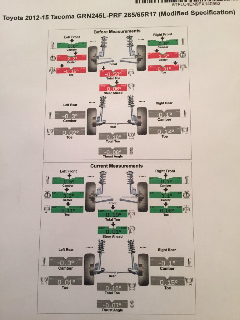

    Alignment sheet for today. The uca's really helped with the caster just like they should have. Truck tracks strait and rides great. Between the lift and tires, lights, and when I get armor reinstalled I should be safe from the speed bumps and mud puddles in the camp grounds
