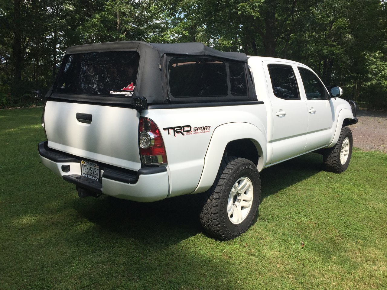

    Thanks, yep I've been wanting one I believe this will suit my needs best. Glad to see you got all your stuff done yesterday.

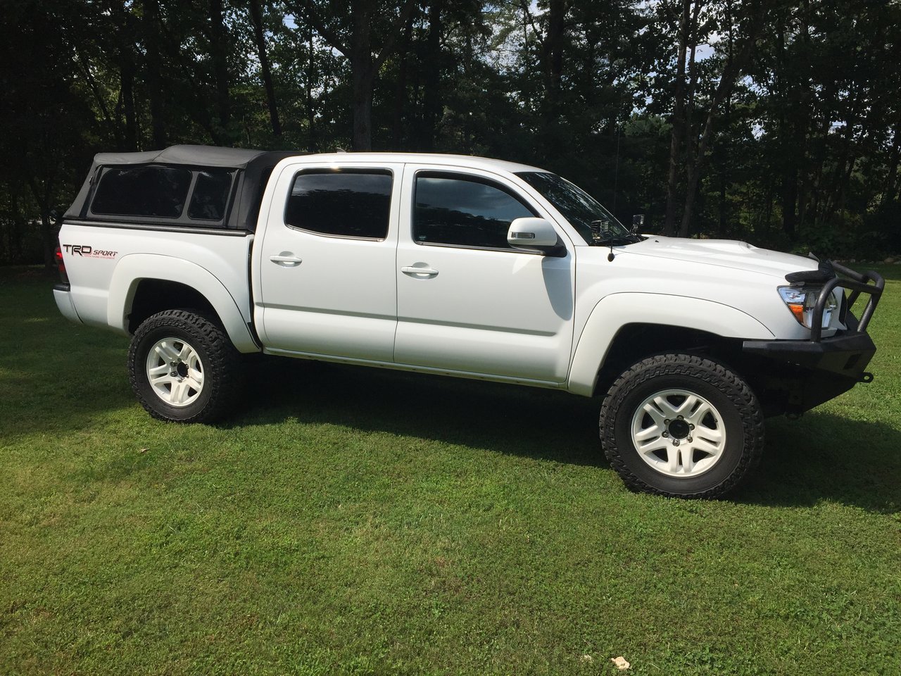

    Thanks! I'm just glad all this worked out well with the lift and topper. I saw your prinsu application and DIY cap rack very nice. That should offer you a ton of storage and versitillity. I may investigate a prinsu for the cab in the future if I end up needing the extra space. Right now between the bed and camper i've got all I need for now.

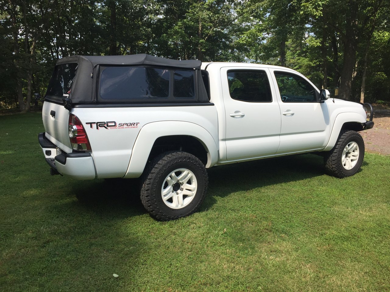

    Truck looks good with that bestop! Glad you found one! And has you said it will suits your needs! Lightweight and removable quickly! Not like my shell that takes at least 2 people! And your rear lights definitely blends in it! Love the way your truck is turning!

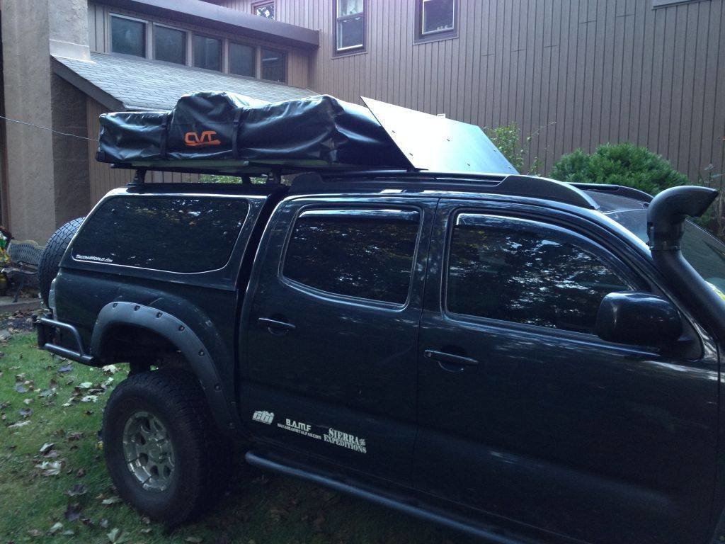

    Dredging up some info from your previous truck: those LED pods you mounted in the rear bumper. I bought the same ones with hopes to install them the same as you did but have not gotten around to it yet. What did you make your cuts with? Is there an exact location they need to be in order to fit without contacting any bracing behind the bumper?
    Thanks in advance,
    Casper66[OP] likes this.

    I just used a dieginder with a cut off wheel on it to cut the holes. Yes where I had the lights is the only location to put them as anywhere else the bracing is in the way. You'll have to get under the truck and locate the bracing, center the gap between them on the exterior of the bumper and mark where to cut.

    Your truck is coming along nicely Chris! I really like the soft topper! Glad to see things are all coming along nicely for yah! it will look damn good once your amour is all mounted up!

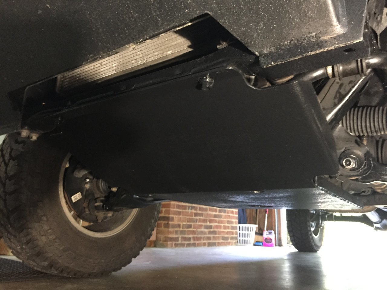

    SOS ifs skid:
    So pretty morning I got a wild hair up my ass and decided to test fit my ifs skid. For those of you who remember I'd ordered a full set of skids for the other truck and had to modify them for the 4cyl. Well I dropped the stock guard and rolled the ifs skid under the truck on a jack to see if the oil drain hole I cut would line up or how much I'd have to change it. The damn hole lined up perfect so I threw a little anti seize on the bolts and tightened her up. I took some additional measurements for the trans skid and will, as expected, have to cut out the 2" I added and reweld it. That should be all the mods needed to make these fit as the t-case skid attaches to the frame with holes you have to drill and it already has the exhaust bump out on it.
    Getting there one step at a time I need to start cutting the frame plates for the sliders now.
