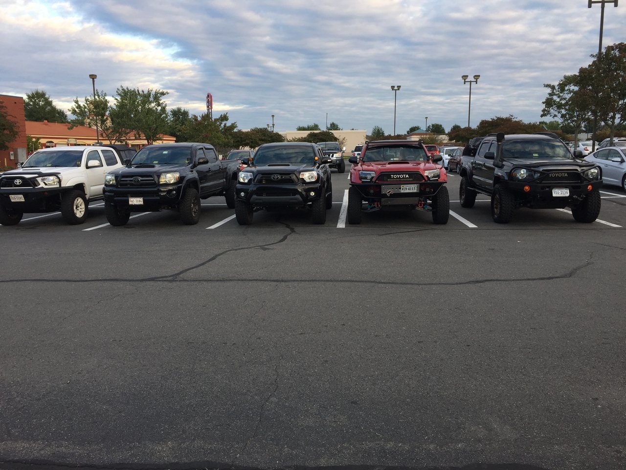

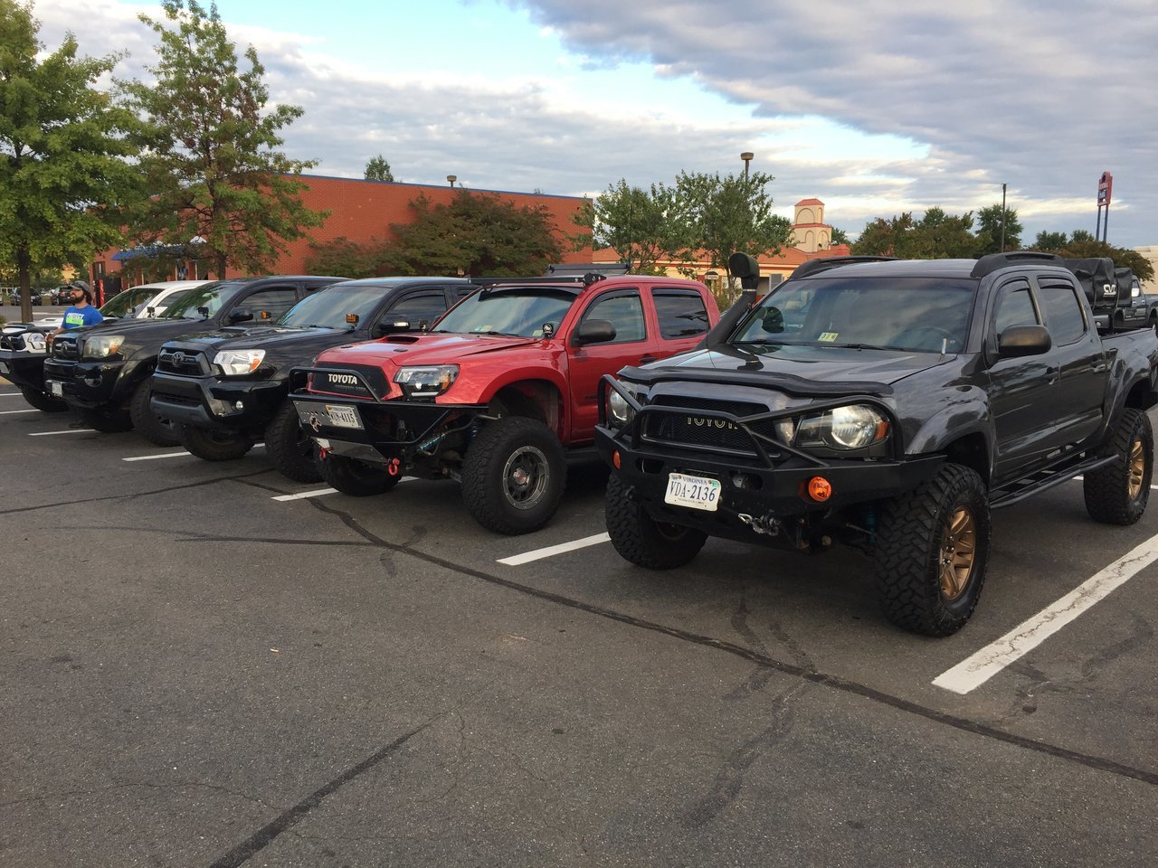

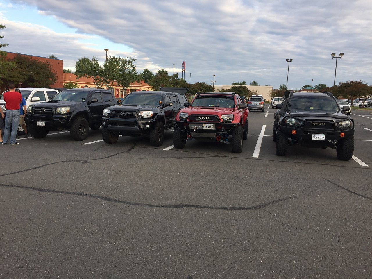

    I agree I had a good time. It would be nice to maybe have a mod day sometime as well

    Lets plan it out in the next few weeks! I like the idea of getting some tools and meeting up at a spot with food and stuff. I don't have any current projects myself besides creating an RTT rack, but I can always help wrench!

    Good to finally meet you guys man! Hope to do it again and make it a mod/wheel/camp/ drink beers kinda meet. Also thanks for the bracket it fit perfect.

    If I had known I would've joined! Wife was out of town so it was a Tacoma filled weekend for me.

    Sounds good man, this happened rather quickly so many didn't know.
