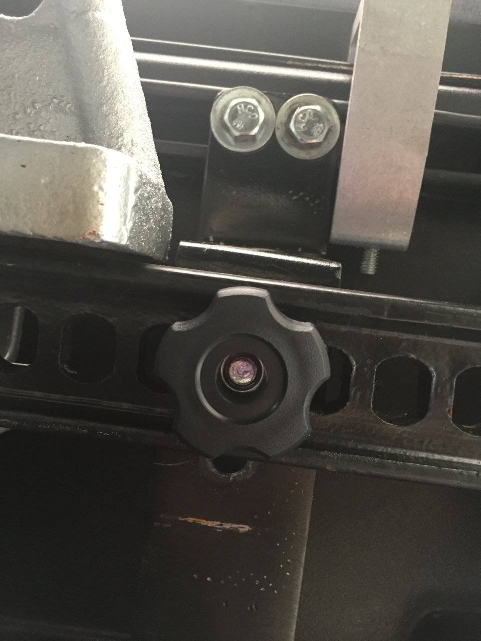

    After installing the Hilift I got to thinking although the 3/8 lock nuts held to jack secure it would make it more difficult to remove. I decided to try these. I found them at Lowes and for a couple of bucks a piece I figured worth a shot. They seem to hold the jack securely I'll just have to see if they stay secure.

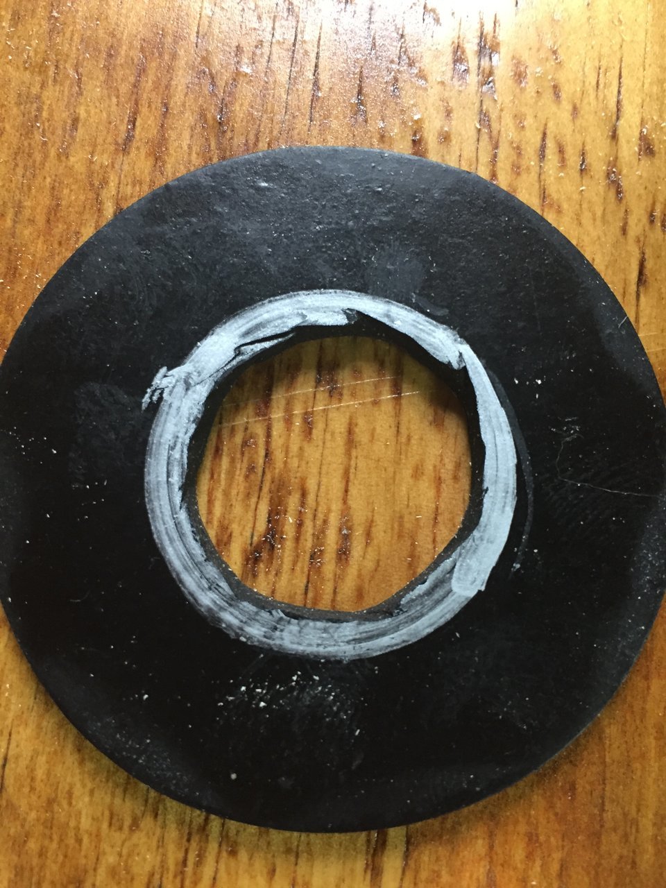

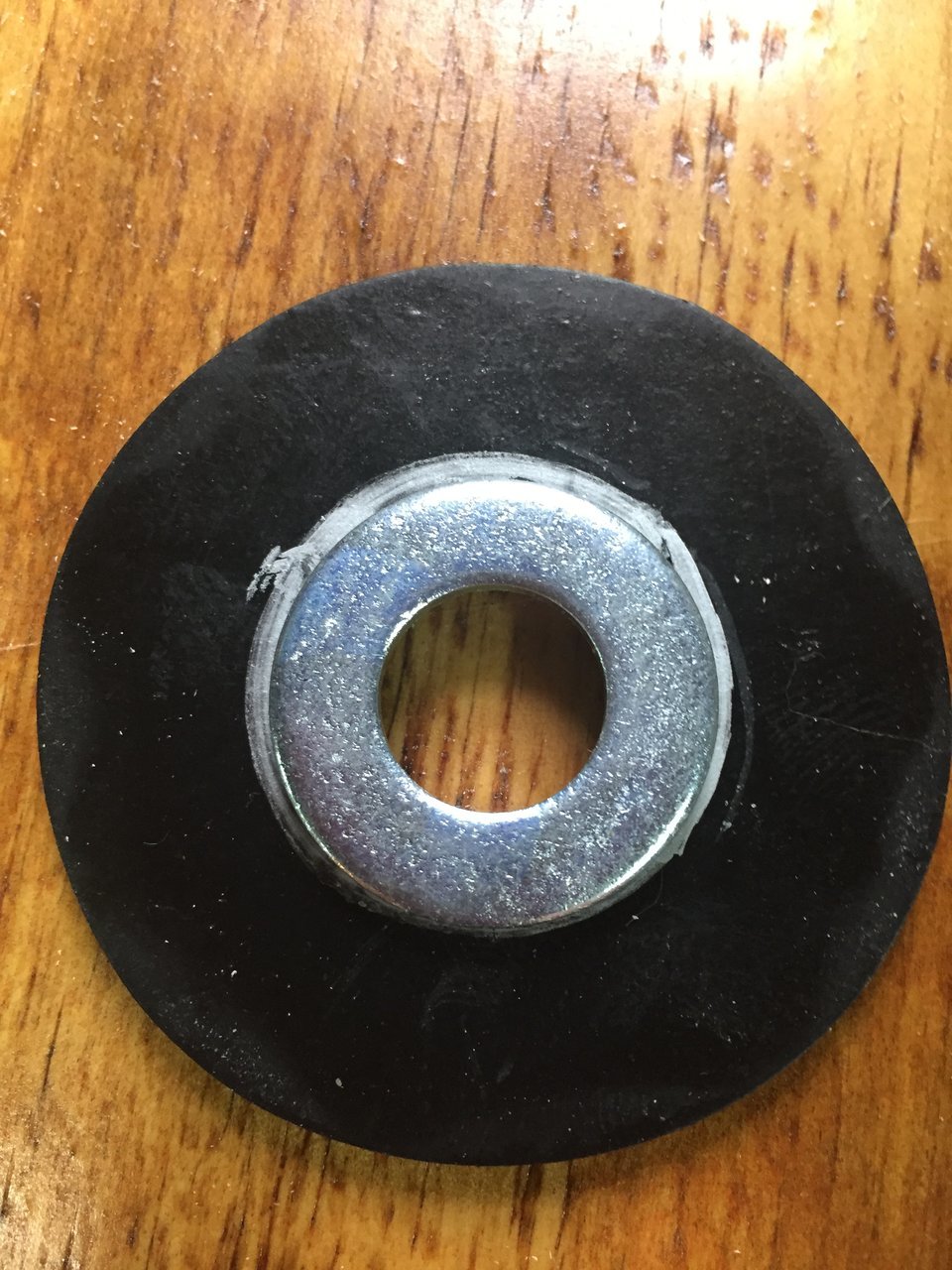

    While at Lowes I looked for the washers @JimboAnz suggested to keep the front shackles from flopping around, of course they don't carry them anymore. I dug through the misc washers in the hardware section and found these big rubber washers. The inside diameter was too small but outside was perfect. I centered a 3/8 flat washer on them, marked them with a silver sharpie, and cut with a utility knife. They work perfect, I tightened the shackles and no more flopping around and they blend rt in with the bumper.
    There's one on each side of the mounting point so 4 total.

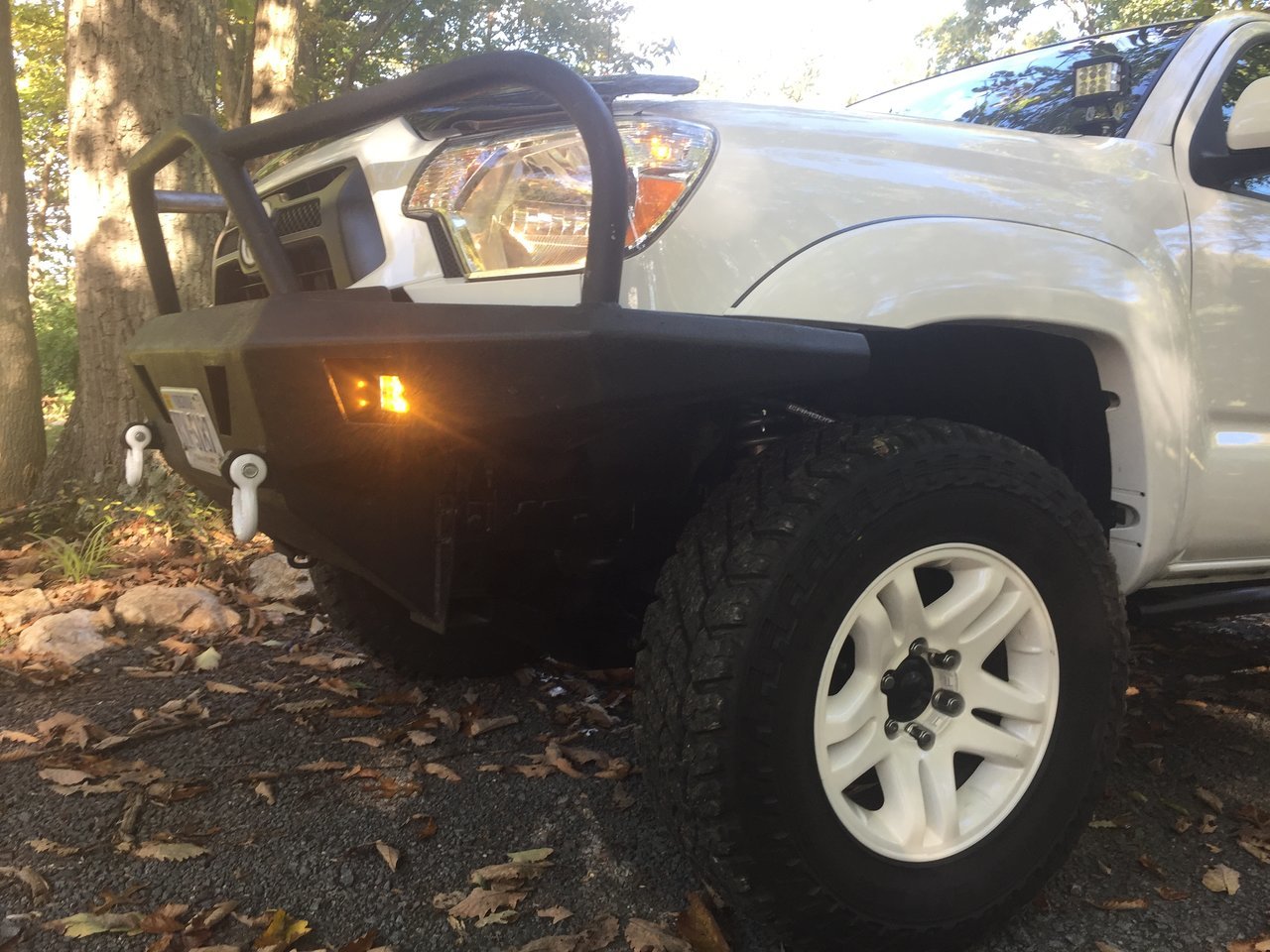

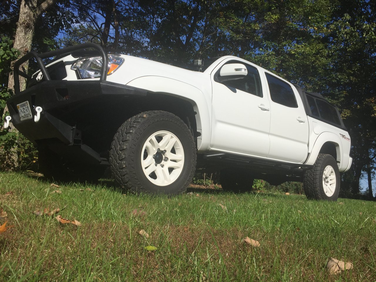

    Out where I live sometimes you can get good pics rt in the front yard. Probably stupid I just like taking pics oh well
  11. Oct 25, 2017 at 8:16 AM
    #1131
    TacoFMS
    TacoFMS Bubble bubble bubble pop
    Jan 24, 2010
    #29938
    8,004
    Justin
    Louisa County, VA
    Just a vehicle to take trash to the dump
    One or two things modded... Check out the build thread
    Needs to stop taking pictures and start getting the maintenance done on that truck!
