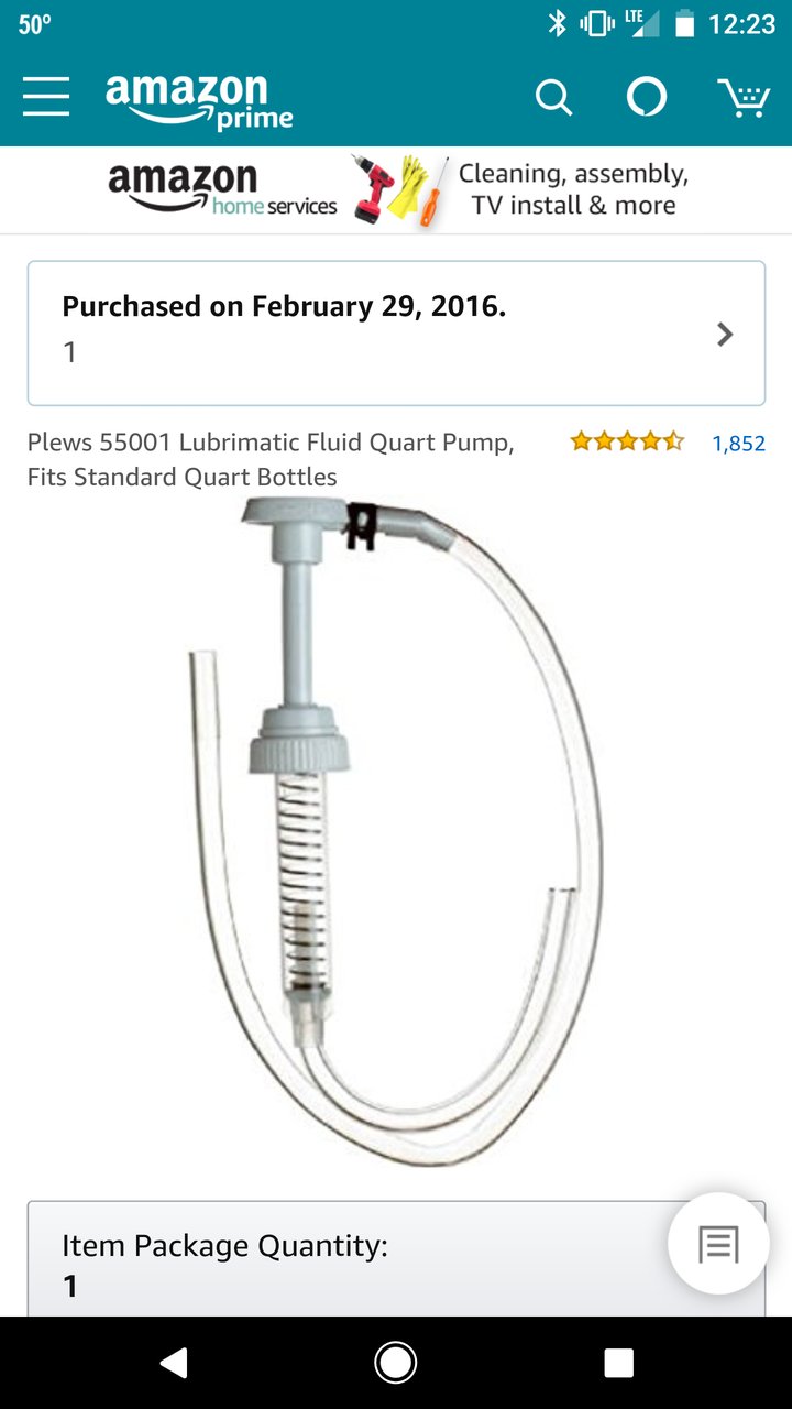

    What pump are y'all using for the fluids? I ordered the Lumax at the bottom of the page and either I'm a dumbass or it's a piece of shit. It was very hard to pump and was getting air in the tubes. The air doesnt hurt anything but it interupted the oil flow. I checked and everything was tight on the pump itself. Maybe some of you have used something better.
  11. Nov 3, 2017 at 8:25 AM
    #1171
    buyobuyo
    buyobuyo Read The Fucking Manual
    Jan 24, 2008
    #4417
    6,291
    Jeremy
    Camden, AR
    08 PreRunner SR5, I4, Manual, Silver
    A thing or two...
    The lumax is the pump that i use. I don't remember having any issues with air bubbles on my last diff/tranny service. Pumping is stiff because of the weight of the oil. I've read of people putting the bottles in hot water so the oil flows better. I haven't tried it myself.

    I just used an el cheapo from Amazon that worked well. The first one i accidentally broke, so i bought another.
    Its slow but works. I have read people saying they make ones with automatic pumps that do it for you, but never researched them.

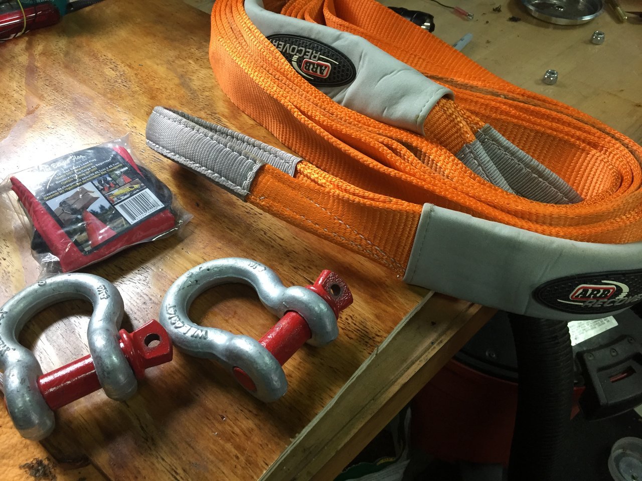

    Added a few more recovery pieces today Smittybuilt shackles, ARB recovery strap, and some other misc. stuff.

    I'm a huge fan of that strap. I've used it many times (even a couple days ago) and it always works great.

    Yeah I love that it's designed to stretch. I can get a small running start, and slingshot the stuck truck free. You'll love it!

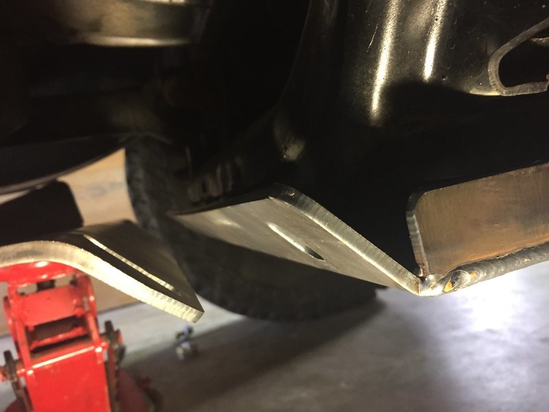

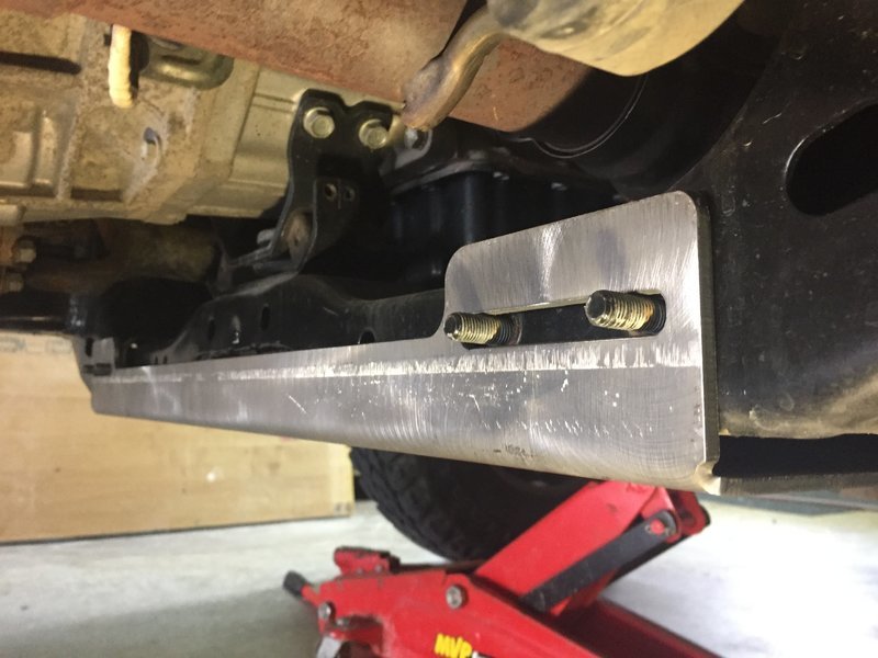

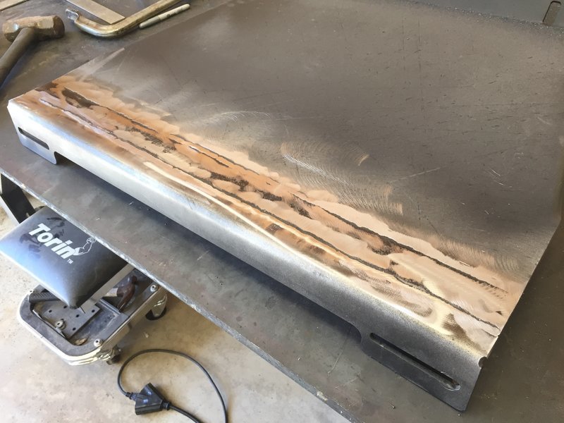

    For the mid skid:
    All you did was cut it and weld in a 2" wide piece to make it fit?
    Casper66[QUOTED][OP] likes this.
  18. Nov 14, 2017 at 1:37 PM
    #1178
    Casper66
    Casper66 [OP] grumpy ass
    Apr 3, 2016
    #183160
    32,001
    Culpeper, Va.
    '15 DCSB TRD Sport 4wd super white (sold) '13 access cab SR5 4wd
    piddly stuff
    Yes sir. The ifs skid works great so does the t case skid. Just cut across the mid and add a 2" piece of 3/16. I had an automatic. I would think a standard would be the same. If your in sure just make the cut and test fit. Measure the gap and it'll tell you what you need
