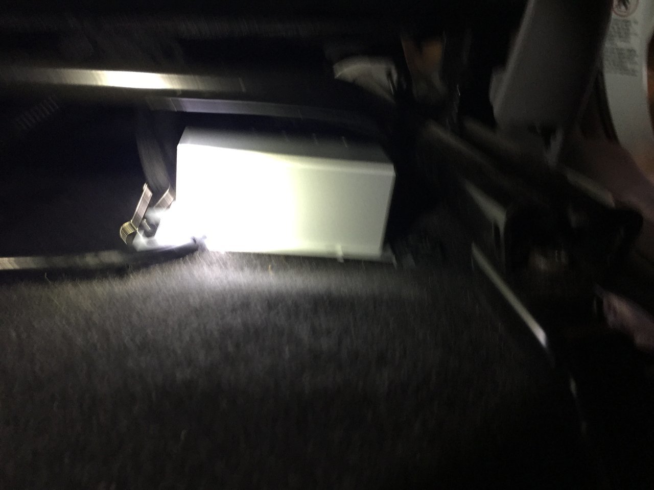

    I popped the sill plates on the driver's side and unbolted the seat so I had a little more room to work. I pulled the carpet back and ran the antenna cable through the grommet under the driver seat. I added a considerable amount of length to the positive and negative wire, put them in loom, ran them through the sill with the factory harness and up and out of the firewall grommet. The negative is grounded to the body ground on the fender and I installed an inline blade minifuse to the hot wire. Much more and I'm going to have to look at a Blue sea panel or something comparable.

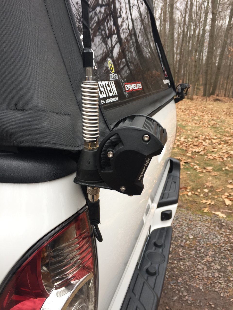

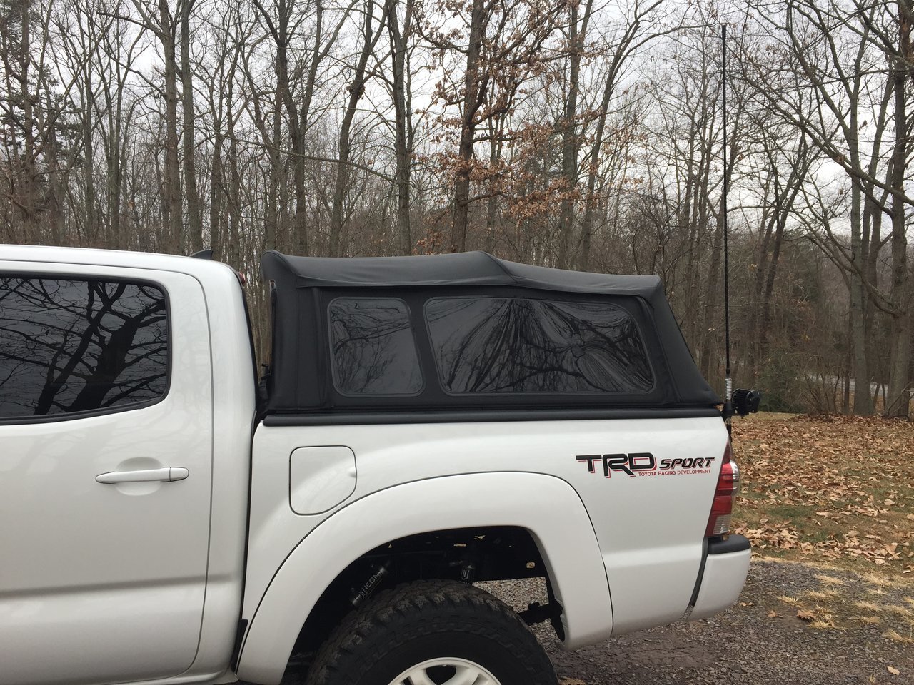

    The antenna cable was run back through the frame, up and out through the tail light, and attached to the antenna base munted to the C&C Fab ( That's a joke it's me) antenna / light combo bracket and the 4' Firefly was installed.

    Remote box under the seat

    Antenna / light mounting on the rear

    Looks good, Chris. What base is that under the spring? That's the part I'm having a hard time figuring out. The antenna and spring are easy. :rofl:

    It's the base off an old Wilson antenna I had in the garage. I was trying to find the regular base for the firefly and spring and remembered I had that

    I unbolted the seat and popped the sill plates, moved the seat back out of the way, and when you lift the carpet and look under the seat there is a large rubber grommet where the wiring harness goes through. In fact if you look up from the bottom you'll see the grommet right along th frame. I ran the wires and antenna cble through the vent holes in the carpet under the seat and then down through the grommet. After that I just fished the antenna cable down through the frame then up and out through the tail light

    Nice/Clean install! My antenna is also back there and I am able to get a really good swr! Is the tip of your antenna tunable with the screw or you have to cut?
