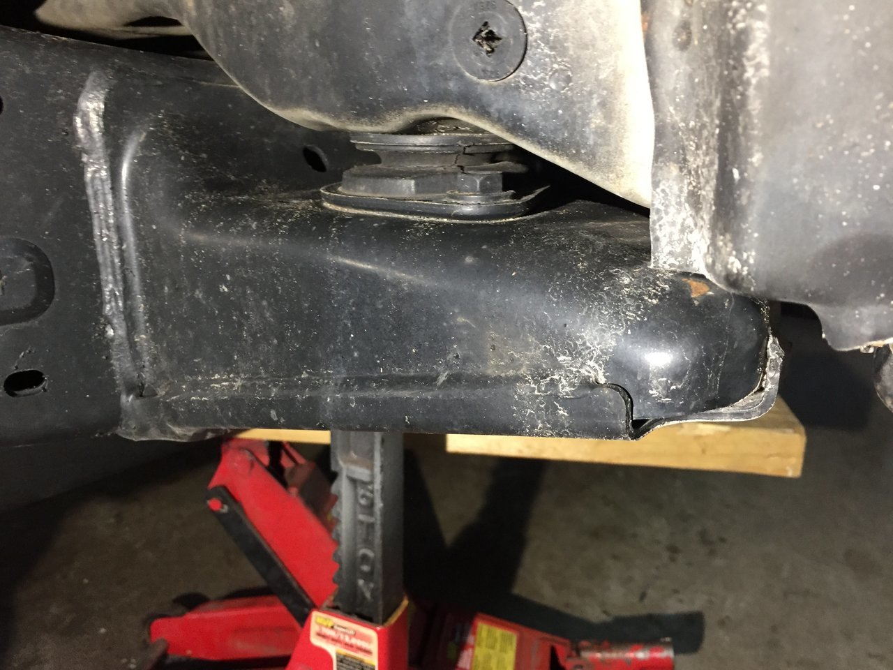

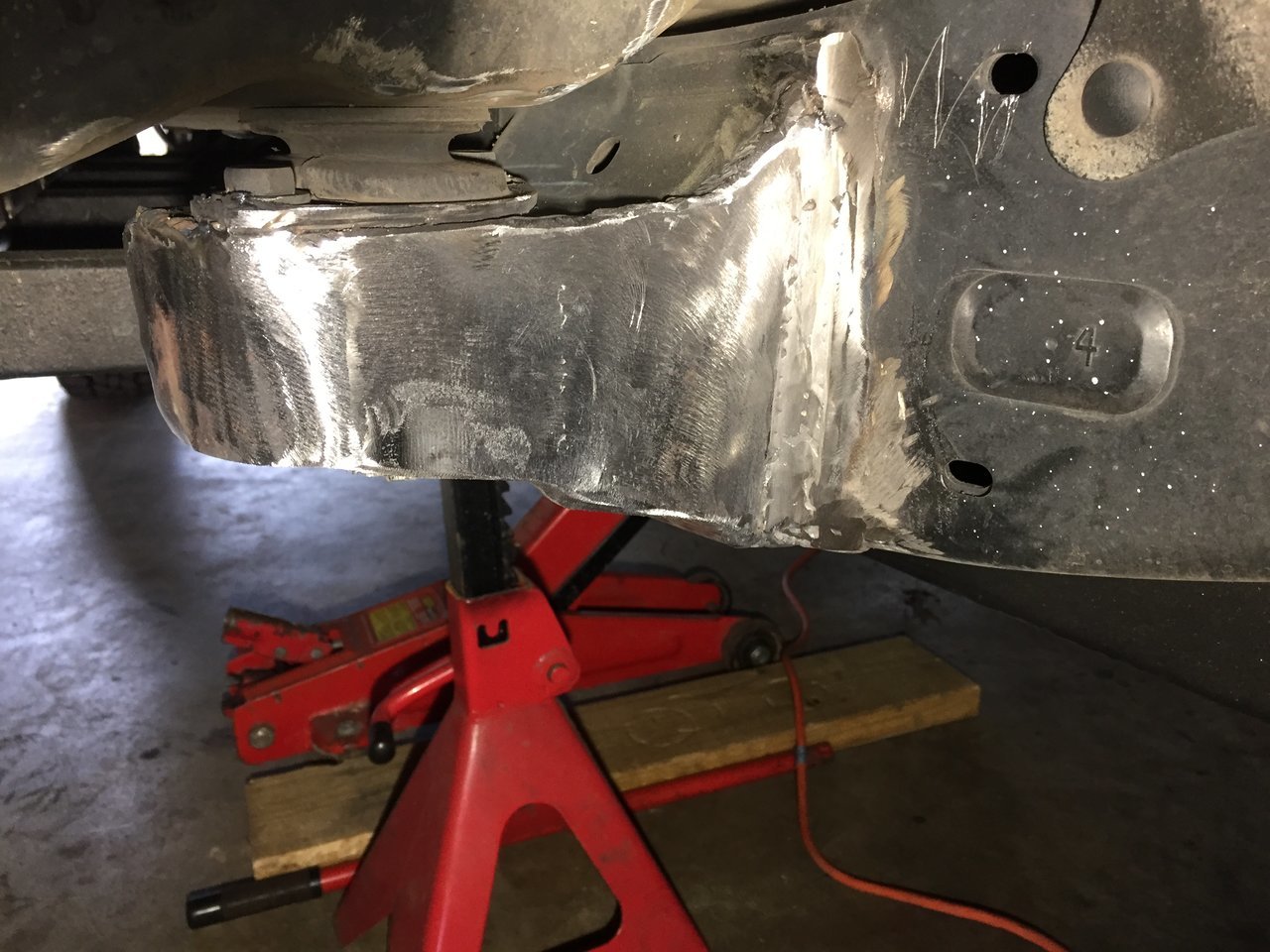

    CMC:
    Rainy day so decided to play with the welder some. I picked up some steel yesterday and since I was home alone today I went at it. I didn't need a CMC but said what the hell and did it anyway and if I was going to do it I may as well do it all. I don't buy premade plates or anything i just get some 3/16 plate and fab my own as i go. I've done the welding part of several of these but never the whole process so I had a bit of figuring to do. After some inspiration, I decided to cut, cut, and cut some more and ended up with more cut off than usual but figured why not push it on my own truck? As I went I figured out a couple of different approaches to the plates also.
    I just piddle with my own stuff anymore. I do enough fab work at work. Not everybody may like my approach to this and that's fine to each their own. I had fun playing with the welder and getting to put it in different positions and see how it worked. I deffinately had to turn the speed up a little for the overhead parts,which was expected, but i think it all came out well
    Stock:
    Chopped all the way back to the frame and the outer corner tucked and rounded
    I got bold and cut even more on the passenger side although it probably doesn't show

    MQQSE
    MQQSE I take naps
    May 6, 2010
    #36646
    54,099
    MooseMan
    Palmer, Alaska
    "Stitch" & "Sumbitch"
    That’s pretty cool! Good lookin’ work too. :thumbsup:

    Good work Chris. Did you just grind it off or sawzall?
    Casper66[OP] likes this.
  16. Feb 25, 2018 at 4:22 AM
    #1556
    Casper66
    Casper66 [OP] grumpy ass
    Apr 3, 2016
    #183160
    32,043
    Culpeper, Va.
    '15 DCSB TRD Sport 4wd super white (sold) '13 access cab SR5 4wd
    piddly stuff
    A little of both I cut what I could with a grinder with a cut off wheel and sawzalled the rest

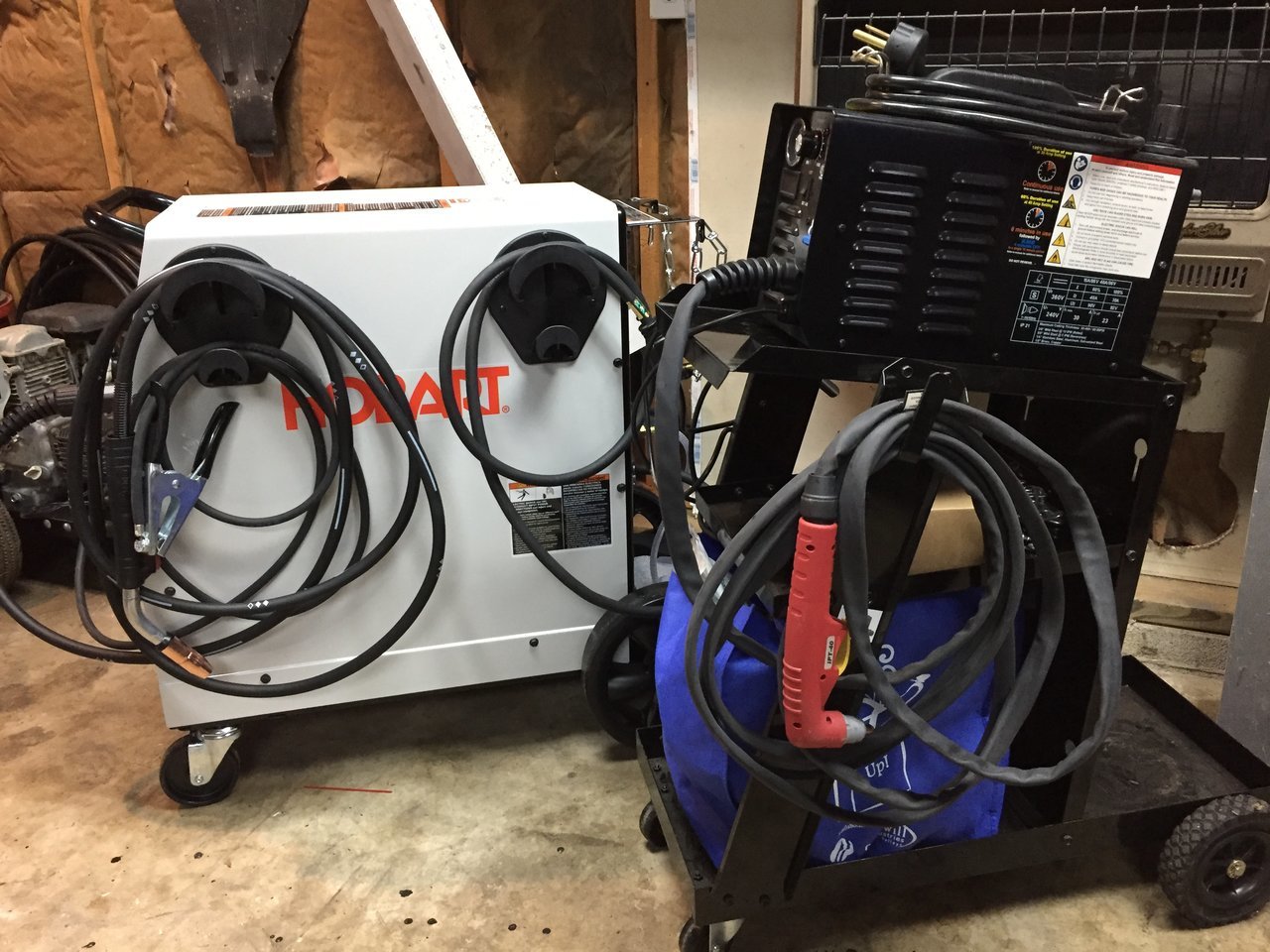

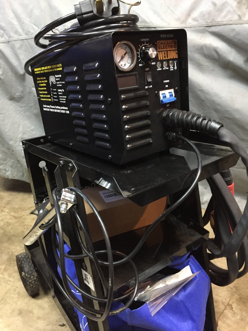

    what kind of compressor do you run with the cutter? (want) (also want a tig) (and a brake) (and more skill! ha ha)

    IR 60 gallon tank 220 compressor
