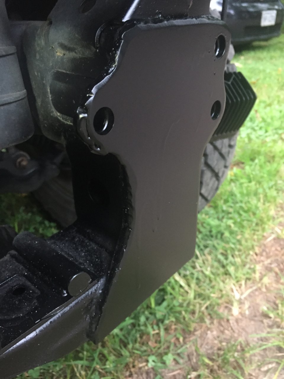

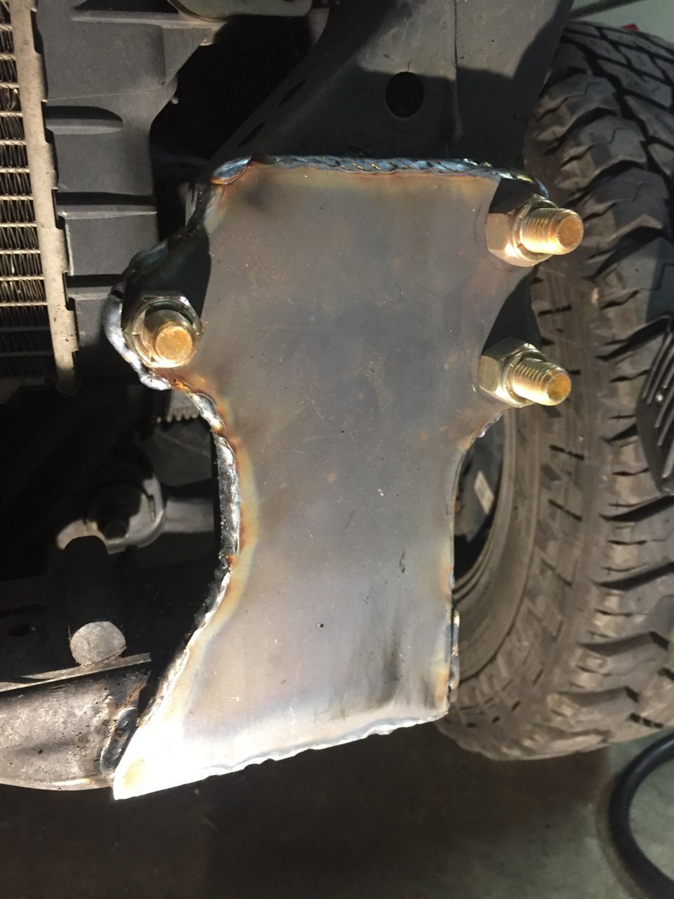

    I finally got around to welding on my frame reinforcement plates for whete the bumper mounts in front. Not an original idea I had seen these marketed on vendor’s sites but din’t like that they only beefed up exactly where the bumper mounted.
    I removed the bumper and made a cardboard template of the area I wanted to cover, transfered to 3/16 steel, and cut them out with a plasma cutter.
    The only kinda pain in the ass was removing the factory studs after that it was pretty strait forward. They’re welded solid all around and the bumper will now ne remounted with grade 8, 1/2” hardware.

    Looks good, Chris. Are you planning on welding the bolts in place?
    I have the SOS plates on my truck. Their instructions have you put in the bolts from behind, like in your first picture, and then weld the bolts in place because you can't get to wrench in there to hold them while tightening with the bumper mounted.
    MarX and Casper66[QUOTED][OP] like this.

    Does it push the bumper away from the truck the thickness of the plate? Always made me wonder.
    MarX and Casper66[OP] like this.

    Yes.

    I thought about welding them on and I may have to but I’m going to try without that first some are hard to get into with the gun

    I don’t reslly see how it couldn’t to be honest. I don’t know if you’ll even notice 3/16 of an inch though. The idea of makeing this area stronger with the intentions of a winch someday outweighed my concerns over a minor difference in appearance. You know I’ve always been anal about looks, apparently not with myself, but what do you always say? Function over form

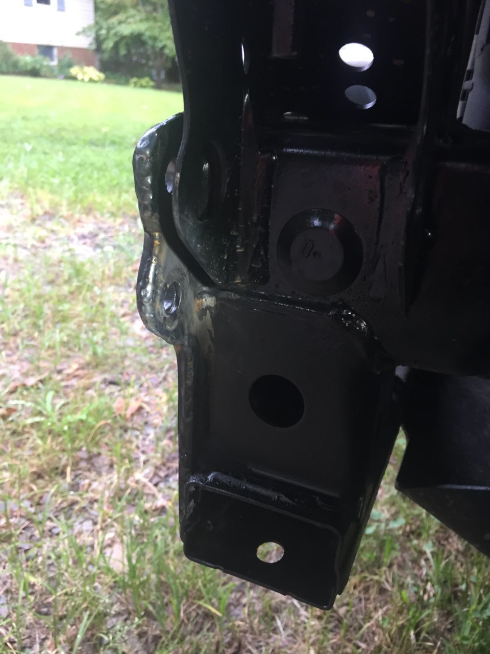

    I got the front end back together. I wasn't entirely happy so I took it back apart and tweaked a few little things. I did finally get the frame tie in braces/ brackets installed. They started as just the flat brackets until @TacoFMS explained how they can be actually pulled strait so i gussetted the top and bottom and added 2 vertical gussetts hopefully these hold. Now I need a winch and I may add a cross brace from frame to frame to tie into the winch cradle

    Between the plates and larger bolts and now these tie braces that bumper isn't going anywhere

    You know I wouldn't think so. It's aluminum though I got it when I had the 4 cylinder Tacoma. I've been devising a cross brace for the frame. It is a 1" square tube maybe 1 1/2" I can't remember what I bought it was a whie ago. I want to weld it in behind the vertical section of the winch cradle and then run 3/8 bolts through it and attach it to the winch cradle. My thinking is between the braceing at the mounting points and thecross brace it will make the pull more "off the frame" than stressing the bumper. The one trip I had with the camper , so far, we had to use @Wild Crow winch to remove a tree and I found even more of a use for the winch. I still haven't figured out which one I want yet. The guy I ride to work with gave me a Ramsey 12000 lb winch but it needs a little work and I'm not sure if it even works

    To answer this now that the bumper is back on. Yes, it did but its so small you can't really tell. 3/16 plate isn't very thick.
