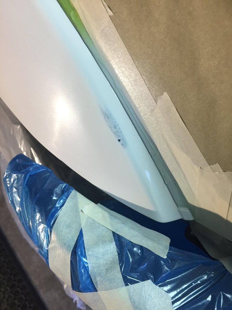

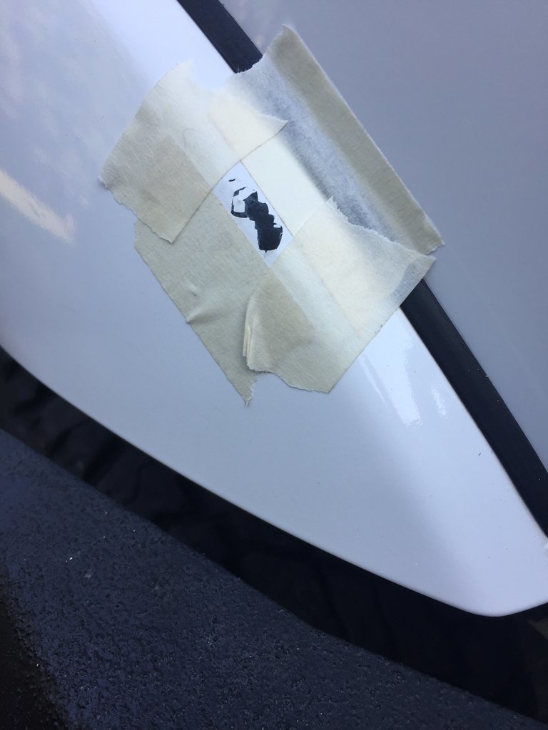

    The offending area the paint was ripped off in an area about the size of a quarter
    The first step is to wipe the entire flare down with a mild reducer to clean and strip any wax residue or other contaminates from the area your working. I then wrapped a small piece of 600 grit wet/dry paper around a small piece of stir stick and wet sanded the area in a criss cross pattern until all the edges were feathered out and I achieved a flat surface. Use a piece of 1500 grit wet/dry paper and wet sand the whole rest of the flare in simple back and forth strokes until you remove the sheen from the surface. You can just hold the paper in your hand to do this part as your not trying to flatten anything just scuff the surface to promote good adhesion. Also go over the blemished area with the 1500. Dry the area your sanding periodically with a paper towel and it'll help you insure you haven't missed anywhere. Remember, other than the affected area all your trying to do is scuff the surface don't go too deep or you'll have more to paint.

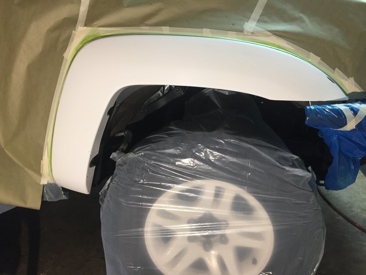

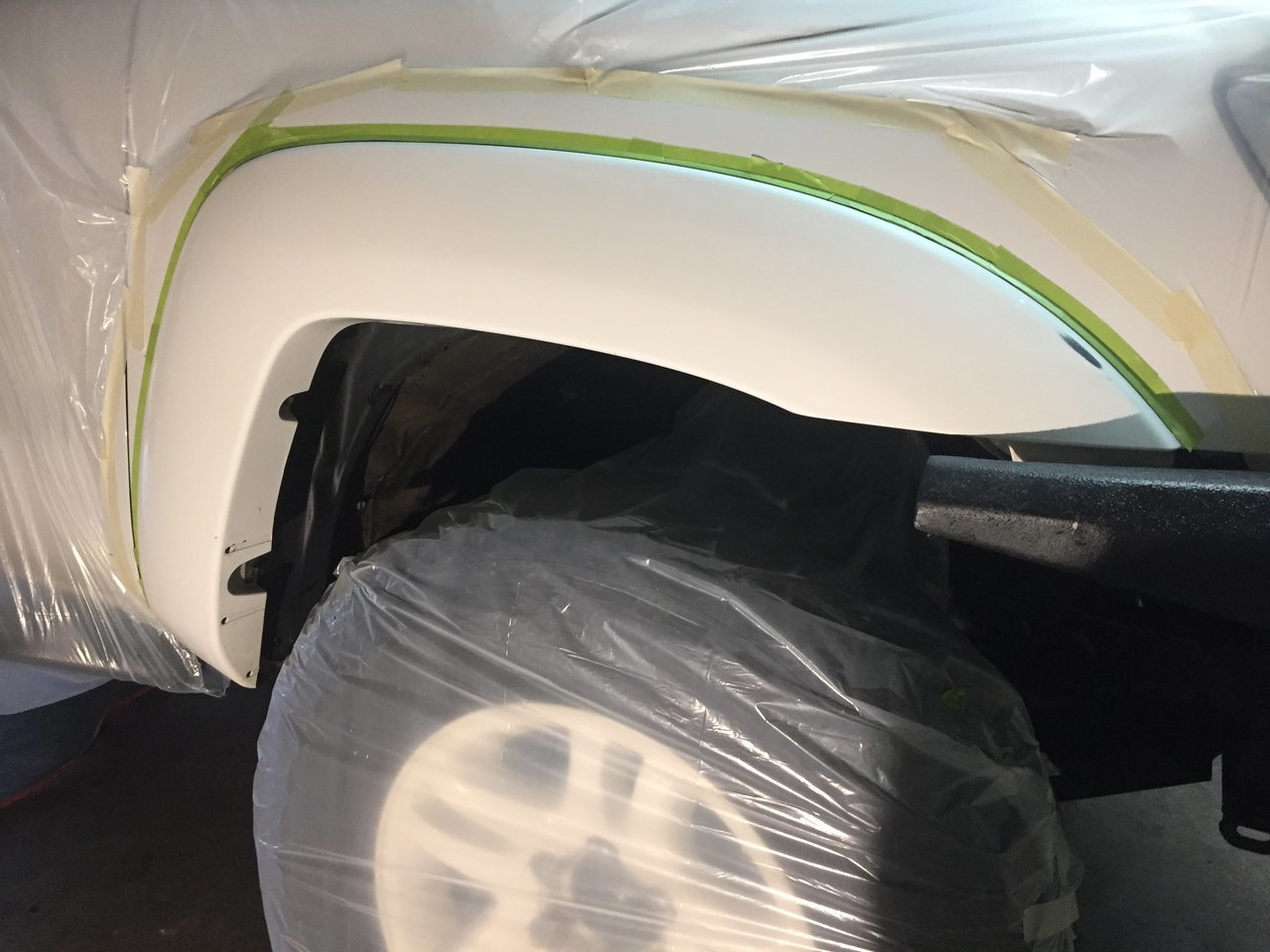

    Taping: Tape the area around where your working to isolate and keep from getting overspray in places you don't want it. A little extra work now can save you alot later. I started by using good 1/2" body tape to outline the flare covering the black edge of the liner that protrudes. Take your time with this part and make sure all the black is covered yet no tape is on the flare. I then covered the rest of the truck with cheap plastic drop clothes I got from Lowes for $1.98 apiece. Trim the plastic so it's a couple of inches away from the tape. Come back around the flare and cover the area right around where your painting with masking paper, newspaper, something other than plastic. Your wondering why I didn't just run the plastic right down to the tape? You don't want plastic right next to where your painting, when your painting you'll get overspray on the plastic which isn't good. If you have plastic right next to where your painting the overspray you get on it can either flake off while yor painting or untaping and fall into the paint ruining your work. The overspray will soak into the paper and not come off in these circumstances.
    Plastic is run down near the tape and I used what I trimmed off around the wheel opening to cover the front tire and suspension
    Paper is run all the way to the flare and overlaps the plastic

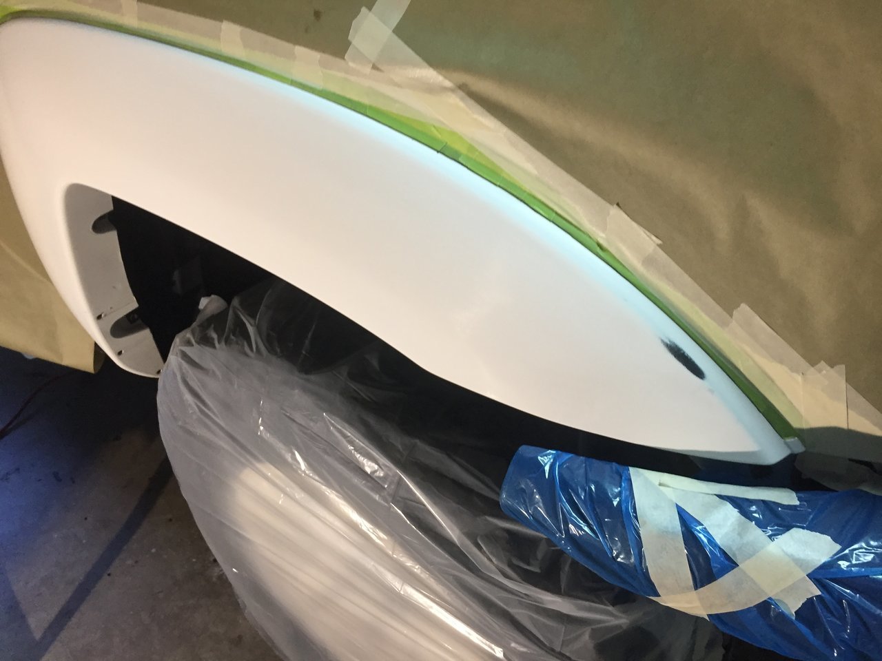

    Painting: When the taping was complete I wiped the flare down again with a mild reducer, blew it off with compressed air, and wiped with a tack rag. A tack rag can be purchased with the paint supplies at your autoparts store and is simply a piece of cheese clothe that has been impregnated with a sticky resin to capture dust. Wipe lightly your only trying to capture dust. I then sprayed an adhesion promoter only on the areas that were to be covered with paint. I began dusting only the areas that reuired color with paint. I used light coats to gradually coat the areas until I achieved complete coverage and then added an extra coat just to make sure. After the completion of the color phase I let it flash, dry, for about a half hour. I then gently wiped the tack rag back over the flare, make sure the paint you applied is dry by touching the paint on the tape or paper right by it. 3 coats of clear was then applied over the entire flare to tie it all together and bring back your desired finish. Afterwards I let it sit for about a half hour before untaping checking for dryness first on the surrounding areas.
    This is after the adhesion promoter and 2 light coats of color

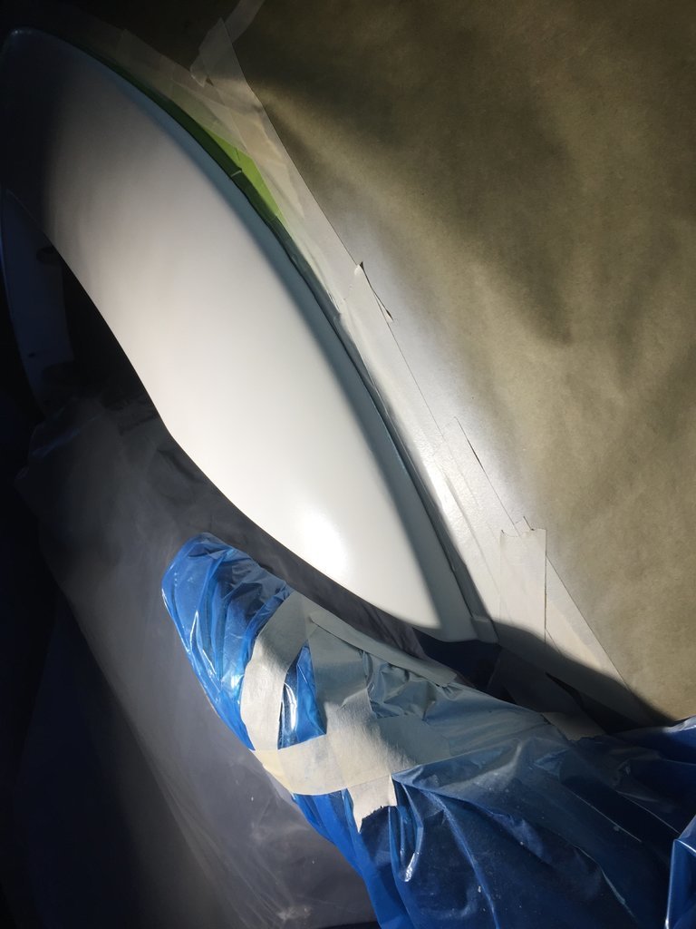

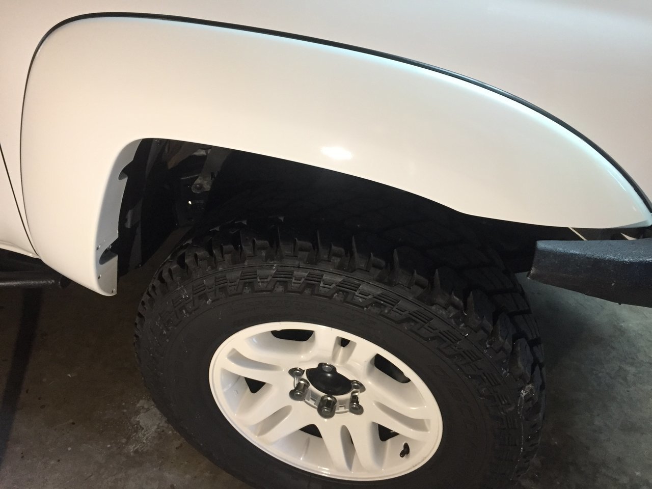

    Here I have achieved complee coverage. I'm not sure how well it'll show up in the pictures but where I painted it's slick and shiny looking yet around it you may be able to see a haze. The haze, or overspray, is the actual blend yep this is a blended repair. Have you ever wondered how guys paint cars and they'll change colors or tints and you get a really cool fade from one color to another? Same thing just with a larger area and using different colors. The actual fade is just the overspray from one color over onto the previously applied color.

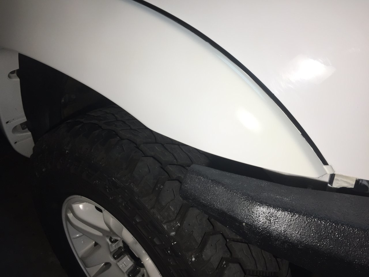

    Here is the finished product. By aplying the clear over the whole surface you achieve a uniform finish allowing the touched up area to blend right in with the facotry color
