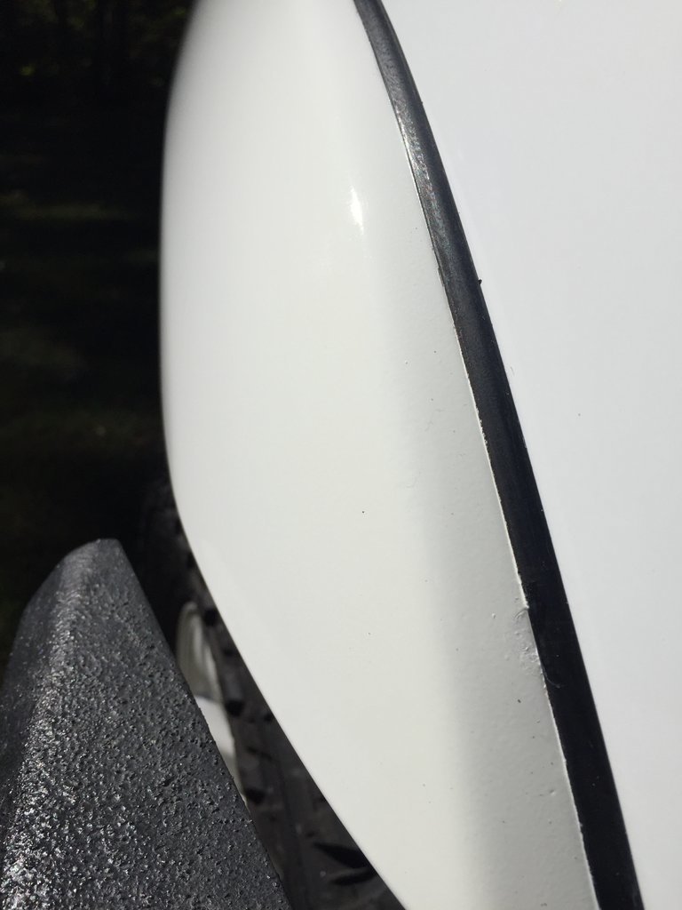

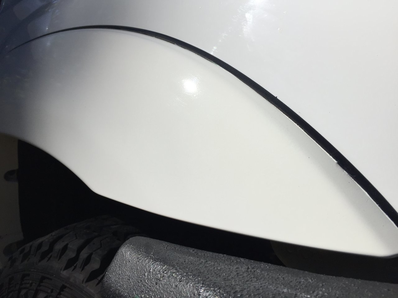

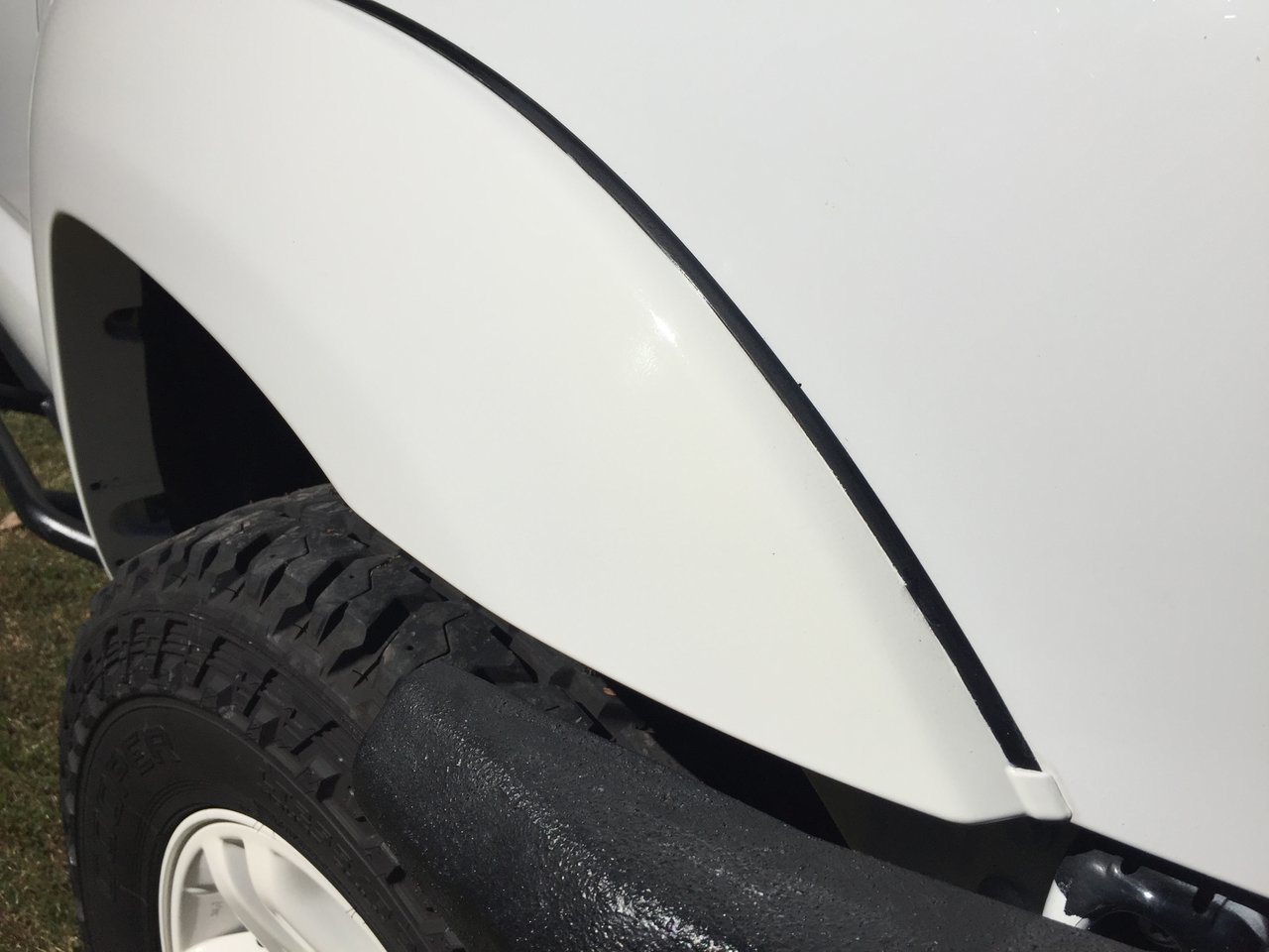

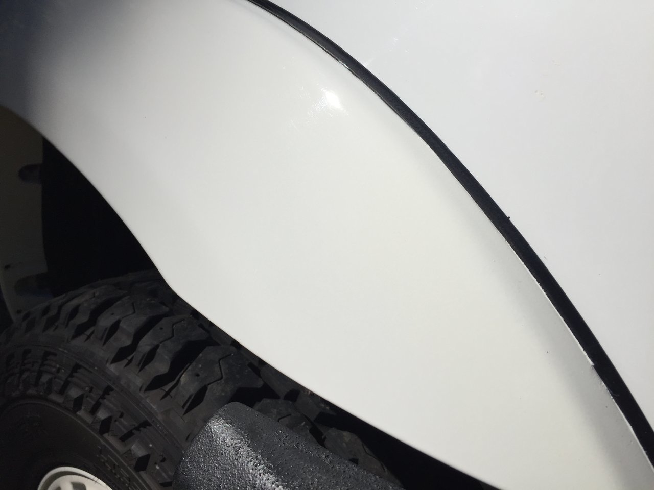

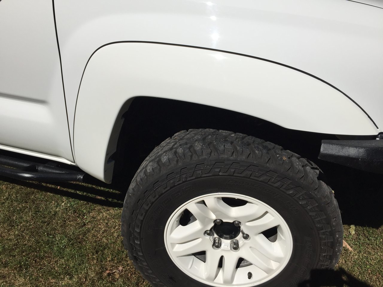

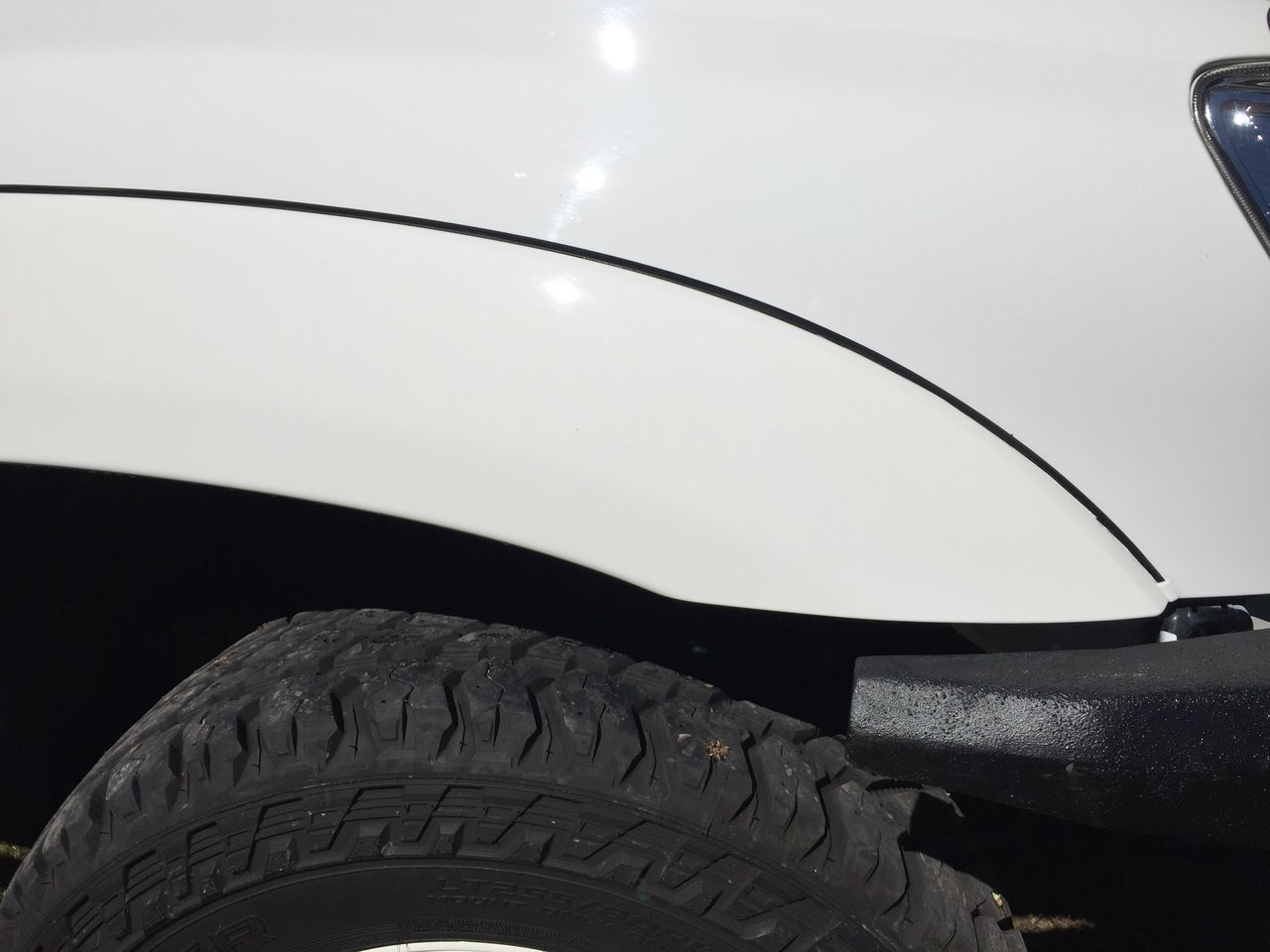

    Here are some shots now 4 days later in the sun and you can judge for yourselves. I only wanted to do this to help somebody nobody saying this is the best way to do it. You all can make your own minds up on that.

    Would be cool if you could get a shot of the clear from an angle. I assume the white was the color matched duplicolor can right?
    Casper66[QUOTED][OP] likes this.

    yes it was the 040 super white duplicolor color match

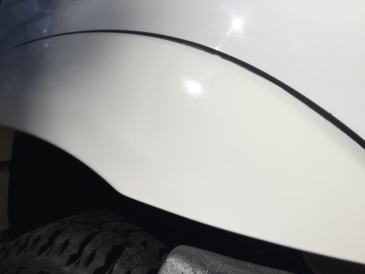

  14. Oct 2, 2017 at 11:21 AM
    #34
    Casper66
    Casper66 [OP] grumpy ass
    Apr 3, 2016
    #183160
    32,042
    Culpeper, Va.
    '15 DCSB TRD Sport 4wd super white (sold) '13 access cab SR5 4wd
    piddly stuff
    here hope this helps white is not the best back drop for a visual comparison through pictures it's just as slick as factory " to me"

    Thanks for the photo...will have to check it out in person next time.

    James looked at it this weekend and had to ask where the repair was. To me that's not bad for a DIY, in your garage, aerosol repair

    Yea it filled it in well, just curious about the clear coat as to me I cant see it in the front of the flare, but with it being white sometimes its hard to see a clear coat at all.

    That would be the trick it matches the other flares in texture and finish. Remember, I never said this was the best repair, merely a stisfactory repair someone could attempt at home. For the best repair the flare should be removed and taken to a good body shop, if you could find one that was not so bogged down with insurance work that they were willing to do it.
