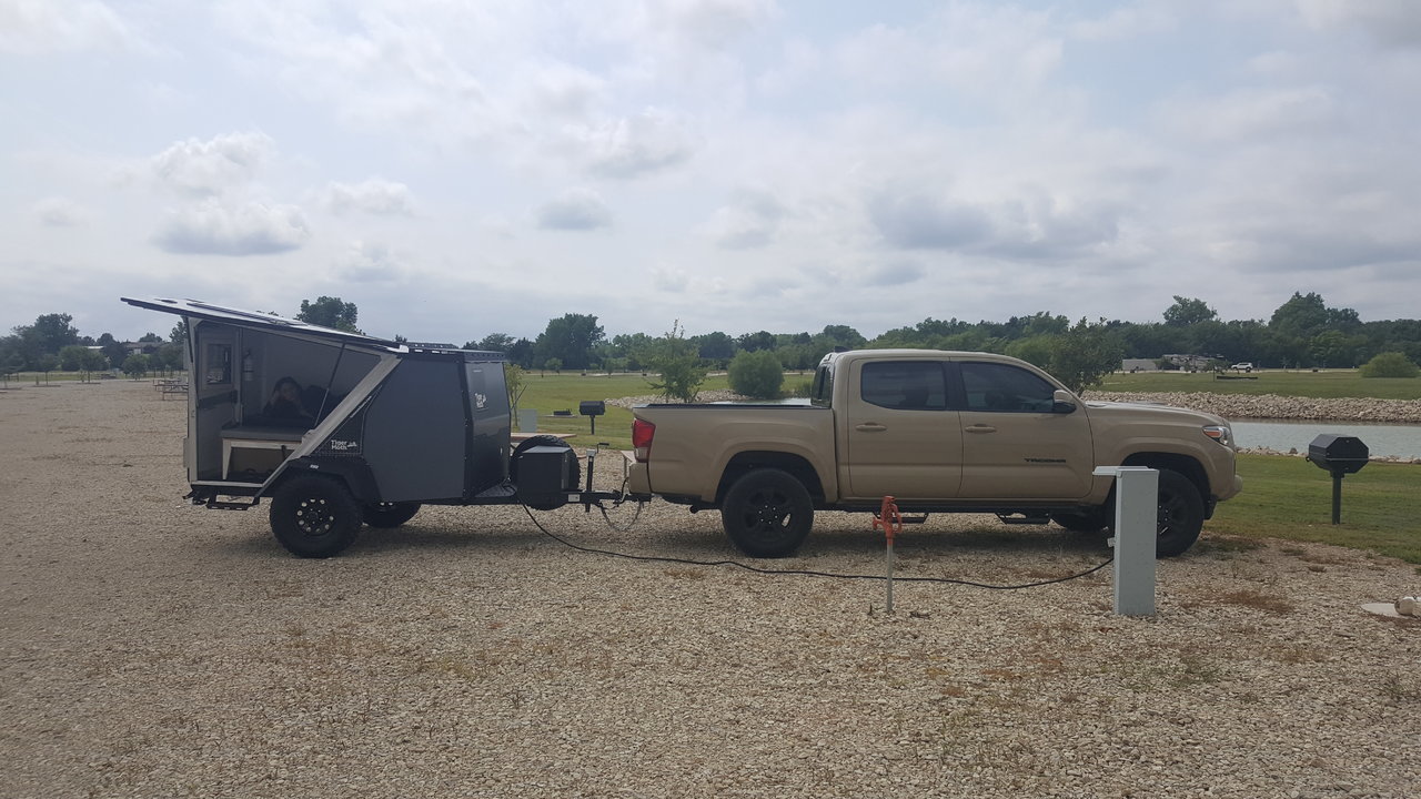

    I've been having to back teailers up since before I started driving with tractors and farm equipment and stuff. I thought as short as this is it may be a pain but it has not been at all. The camper tracks rt along and does a wonderful job. Reversing and arking in our slot was super easy and with the anderson leveler and the 2 additional stabalizers we had it plumb and stable in minutes. I did plumb the trailer and put a level on each of the top front corners (truck side) and 1 at the bottom in front of each fender so I don't have to look far to find if I'm level or not. It really seems to be a wonderful piece of equipment. I cant say as the truck towed it super easy the 4cyl didn't like it going through the mtns at all. A change ay have to be made

    We leave our dog in the teardrop with the AC on while we shower, hot springs, etc. It did take a second trip to get her to go and enjoy herself, first trip she stayed in the TD and just looked out the window for three days. Now when I bring out the camping box, she is all over it, ready to go.
    You don't look like you have a surge protector in line with the pedestal. That is a must if you have ever read the horror stories about campground power. Open grounds, fluctuation in power, reversed power hot and neutral. If you burn out your power converter, might not be covered by your warranty.

    Thanks I guess I'll be looking at one of them now also. I've bought all the adapters now I'll have to find one of those. Is that what you sent me the link for earlier?

    Yep, doesn't look like any in stock but that is a good price. You could probably fabricate your own locking cover for it but I just put a lock on the pedestal cover.

    Amazon shows one with the same part number as you linked me for $83 prime so free shipping IDk may order one tomorrow. Or the one you linked me. hanks for the tip. I don't have much of anythig electrical but may as well protect it

    Something cheap for you then... I don't remember if you were going to get a small generator for boon-docking but if you are, read this and make a neutral-ground plug. It will make the surge protector work properly on a generator. It looks like his site has falling to the image death star but the article explains all and you should be able to figure out how to make one.
