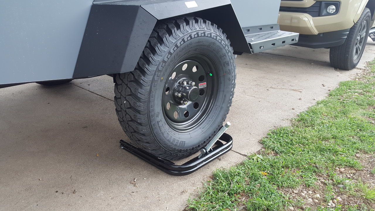

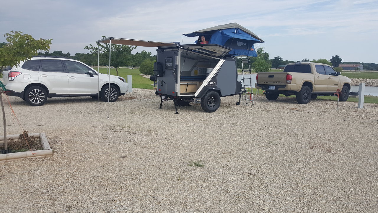

    Finally got it out last night. The front Thule bar was sagging really badly. I will try and reinforce. I did purchase the BAL wheel chock and leveler. I really like it.

    Man that's a cool set up glad to see ya getting it going. We scheduled a trip for Labor Day weekend this morning ready to go!
  10. Aug 12, 2017 at 6:27 PM
    #250

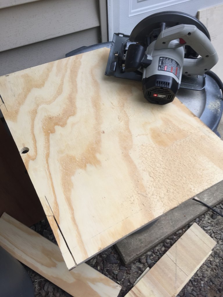

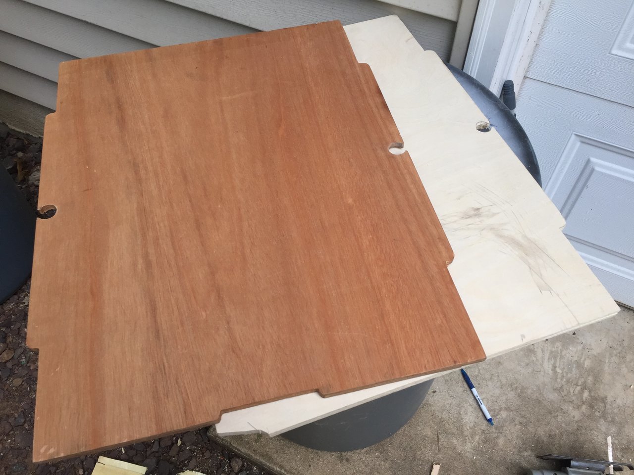

    My wife's birthday was last week and one of the things she asked for was a new Dutch oven. She has one ,however, it's not one with legs. She wanted this one for baking with charcoal when we go out. I got her a nice Lodge Dutch oven and she ordered the carry bag for it. Then she said they suggested you make a board for it to sit in/ on to protect the cover from the legs poking through and could also be used as a trivett. I used their suggestion of using the lid as a pattern so I marked it out on a piece of 3/4" plywood and cut it out with a jigsaw. Of course I wasn't satisfied there and didn't want it to be able to move around so I centered it and marked where the legs were and used a step bit to drill tappered holes for the legs to sit in. Sanded it smooth, rounded all the edges, and stained.

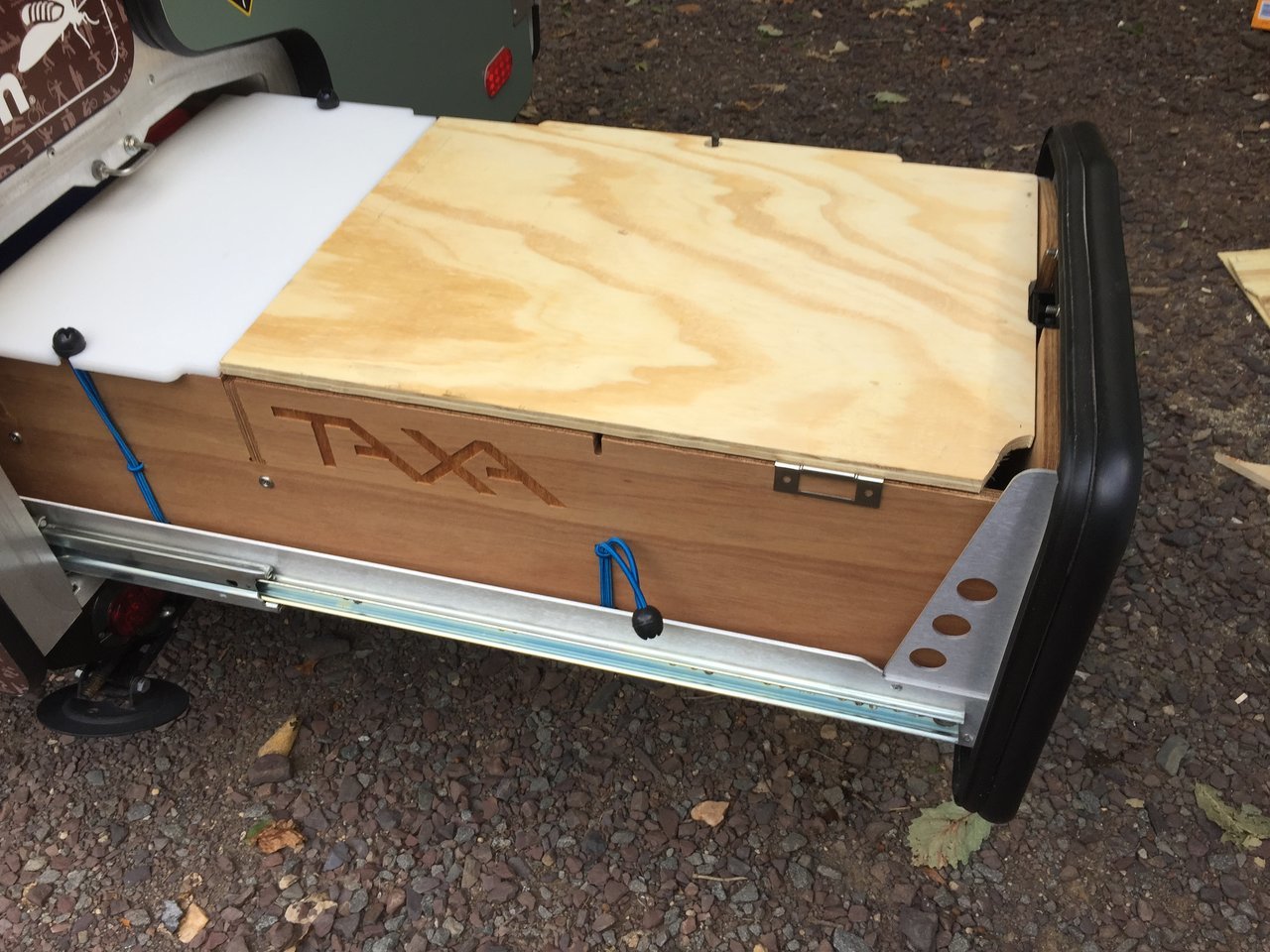

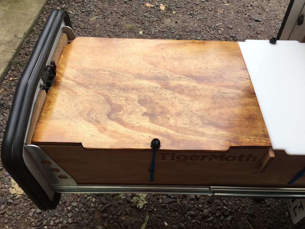

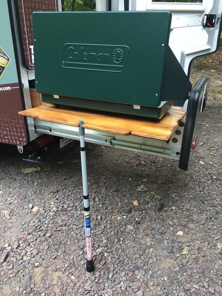

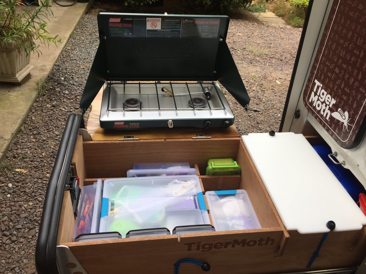

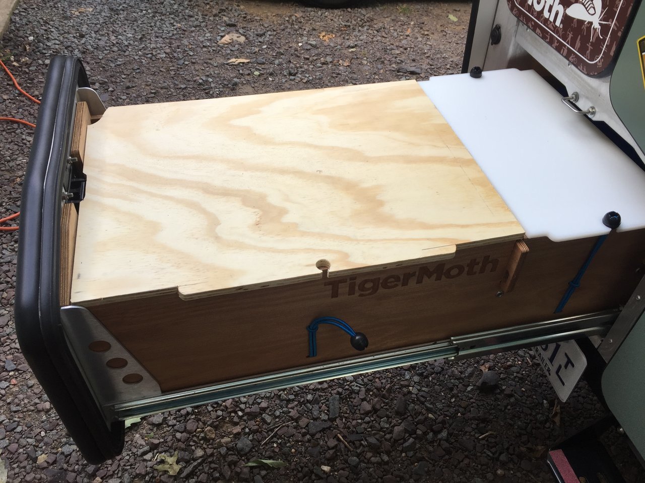

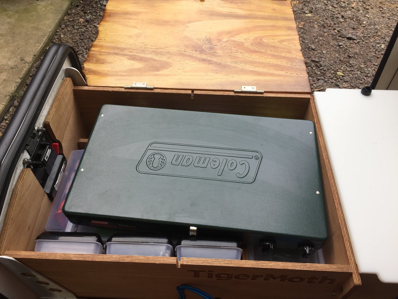

    Kitchen Mods:
    The 2017 Tiger moths have a pair of brackets under the cover in the large compartment of the cooking area. These brackets are used so that when you want to cook you simply lift the cover and the brackets secure it on top of the back edge of the compartment so you can set your camp stove there and cook allowing full acces to the interior of the compartment for untensils and cooking tools, spices, etc. Our 2016 didn't come with these brackets so I asked for a pair. They're well made and powdercoated, however, trying to install them I discovered our main compartment must be narrower than a 17's and the brackets would not fit with the stove in there.
    Simpe fix: Install the brackets and store the camp stove somewhere else. I guess I like a challenge and a fun project. I bought a piece of 1/2" plywood and used the original compartment lid as a template to cut a new lid with some minor adjust ments to allow for hinges and the radius of movement with the lid.
    I cut the lid roughly into shape and kept refining it until I reached the desired result. I then sanded it smooth rounding all the edges and stained and applied 2 coats of polly to protect it from any spills. I attached it at the reear with 2 stainless hinges so when closed it secures with the original strap. When flipped over into the open, or working position it reuired outer support. I went to Lowes and found a telescoping paint roller rod. Note it had to be one that would twist lock so I could set it at any length as the ones with the click locks are at set lenbths. This will allow me to level it in any terrain or circumstance. The rod had a rounded swiveling end so I cut it off and applied a rubber foot like you put over the end of the leg on a step stool so it's also non slip. A happy circumstance found that the threaded end of the rod also fit perfecly into the hole in the board where the securing strap attaches while in the closed position. When your done cooking or for normal stowage the camp stove closes and rests in the compartment along with all the supplies in the compartment and the rod collapses and stores inside the compartment as well.
    I believe I have decided to remove the water container and use that as storage space. I will then make another lid that will flip over from that position to use as a working surface we'll see I guess.
