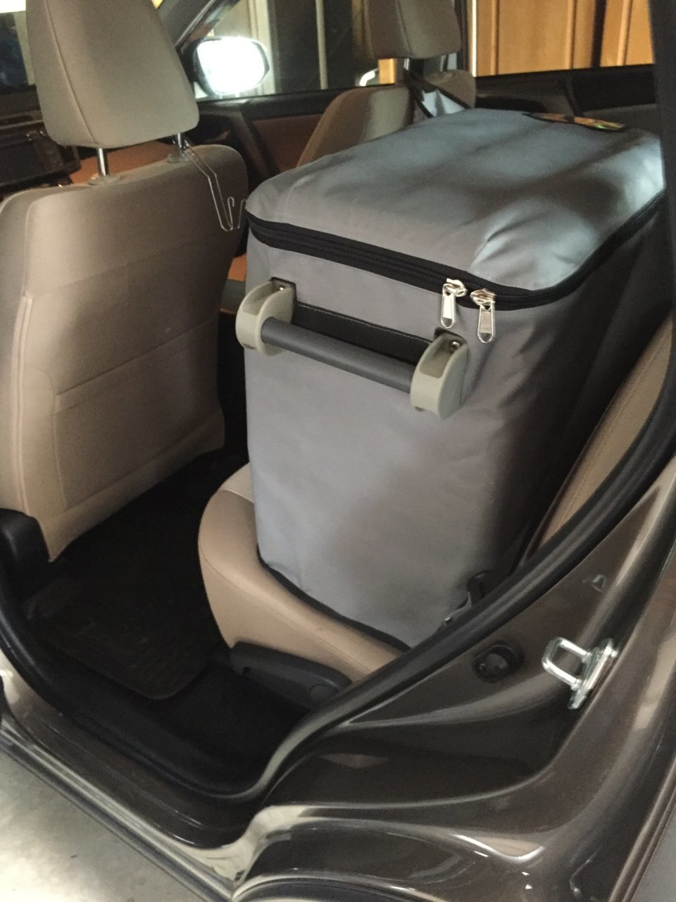

    We just got back from a trip to Charleston and we took the fridge for it's first trip. It secured nicely in the back seat and we used it in the hotel room. Everything worked perfect the whole time.

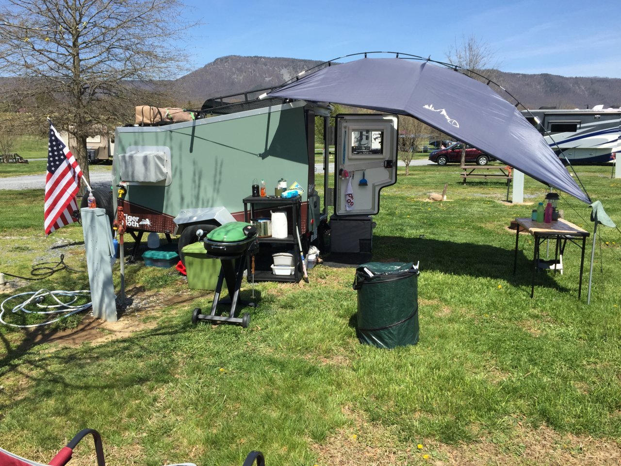

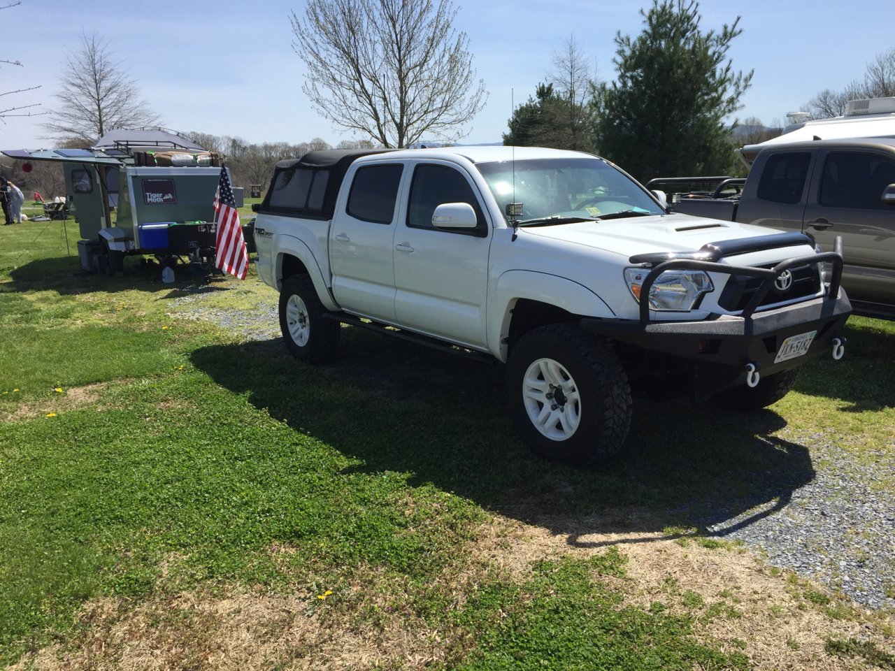

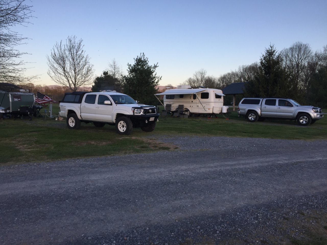

    Outlanders River Camp 2018
    Took the camper out for it's first run for the year! What a great weekend! A 50+ buddy from Delaware came down for the weekend to camp with us. It was just a short run over to Outlanders in Luray just over the mountain from home but wht a beautiful place. Maiden camping trip for the fridge and it worked flawlessly.
    had to strap it into the truck
    We met there Friday afternoon and setup, had a great dinner and a fire as it got cold at night aroung 30.
    Saturday was the big day as we decided to invite a couple more of our 50+ crew who were pretty local to where we were.

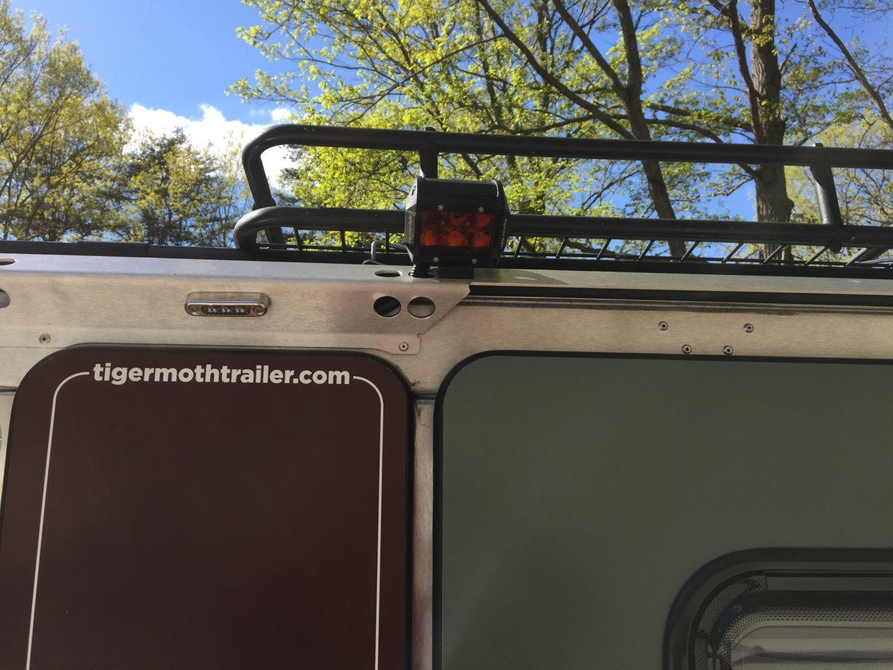

    Auxillary Lighting:
    We discovered we'd like additional lighting at night as the little LED amber light that came with it just wasn't cutting it. The Tacoma donated it's floods with the amber Laminex films. I just jumped off the existing wires for the original light (which I did retain) and installed one in the middle of the rear angled down. I jumped the wires off it to the front right corner of the camper and mounted the other pod light to the cargo rack on the roof. The lights are small and unobtrusive I guess we'll see tonight what they look like.
    Front rt corner light:
    Rear light:
    No the wires will not be left loose I just didn't feel like driving to town for some more wire loom and I need to get some adhesive backed tie downs for the wires.
    I did order a set of Caliraised amber pod lights to replace these

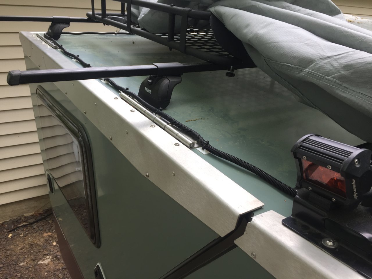

    I finally found the pieces I needed to secure the wires on the roof of the camper for the pod lights. I encased the wires with loom and secured with adhesive backed plastic pieces to the roof along with zip ties.

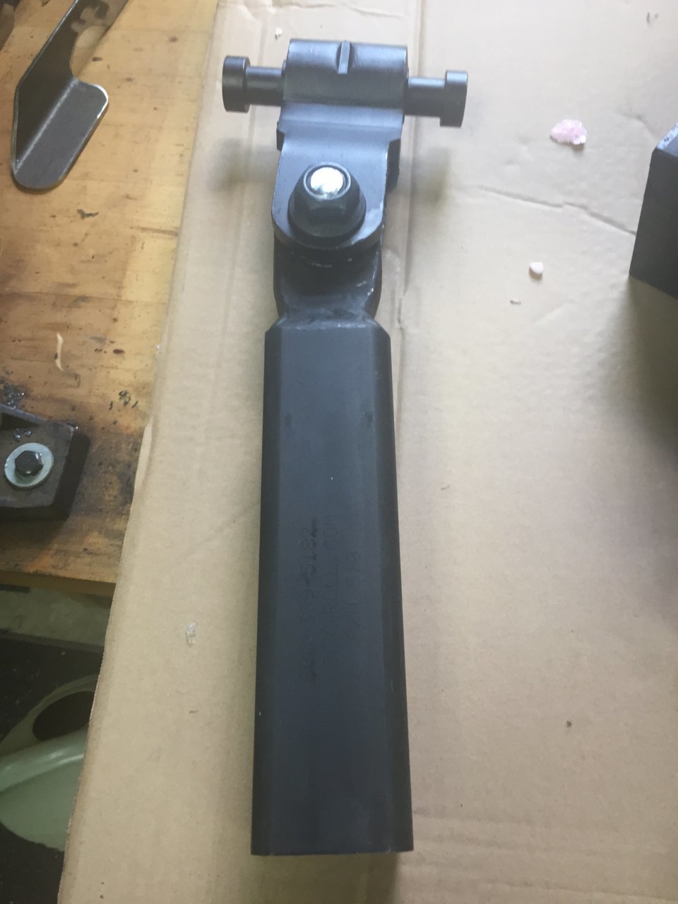

    It's gonna be a fun week, other than working, I ordered the "lock n roll" hitch with a 4" drop for the truck and the trailer side as well. I'll be stripping all the stuff off the tongue this week and opefully Friday get the steel I need on the way home.
    I'm going to start with cutting the coupler off and extending the tongue by 2' along with adding the new coupler. Then when i can start cutting steel and getting ready to build the storage box for the tongue to house the fridge. This is going to get fun!

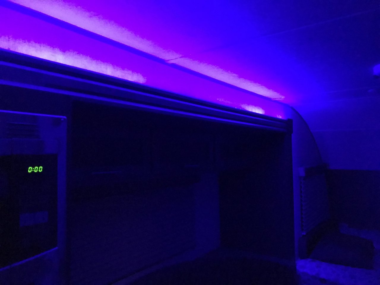

    Not this year yet. It just got warm enough a couple weeks ago to pull the cover off. Thanksgiving weekend has been our only outing so far. But we did do this...
    Mood lighting.:D RGBW LED lights pick a color and intensity for the occasion.
