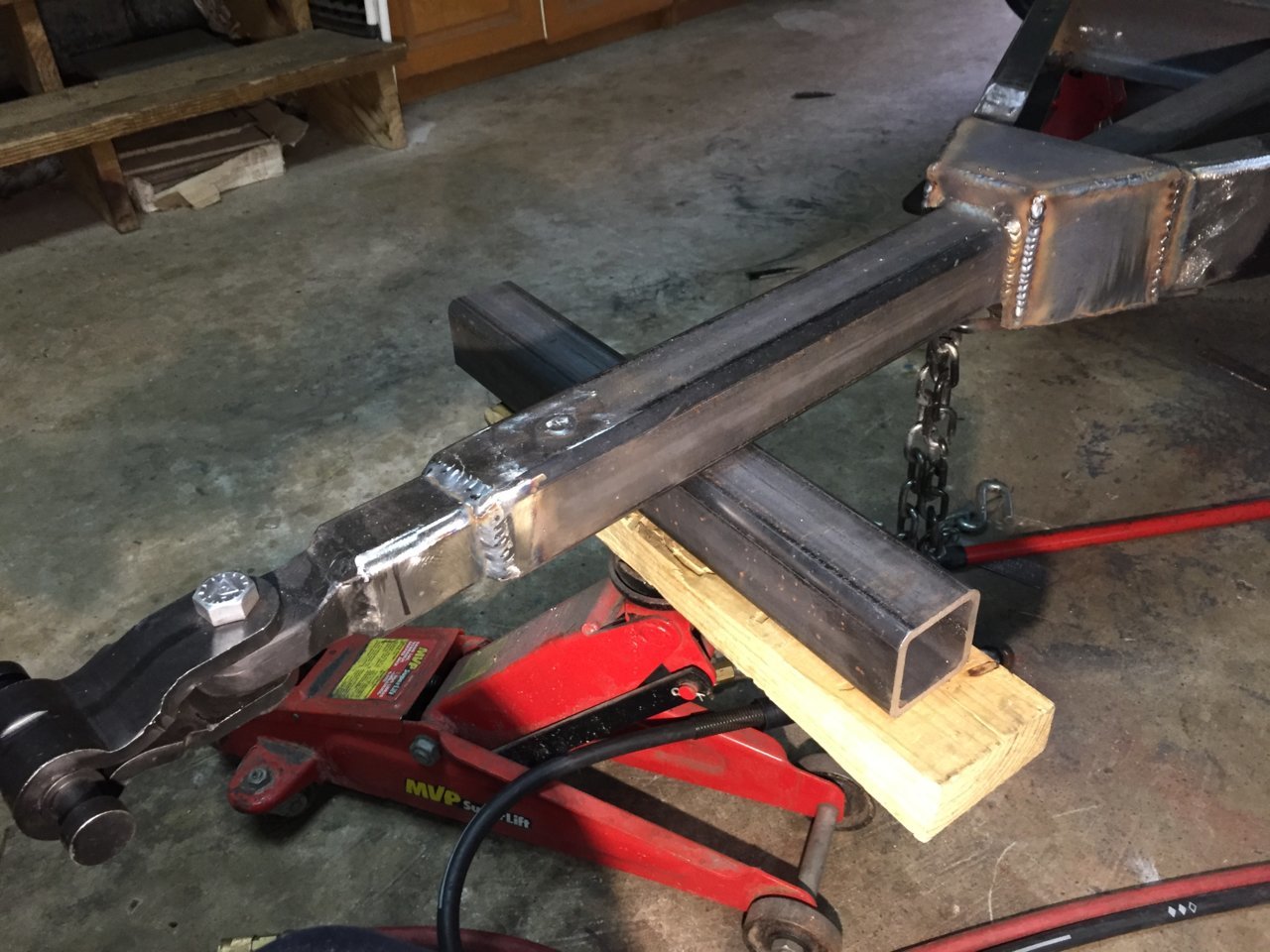

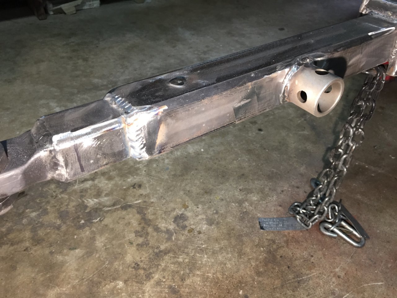

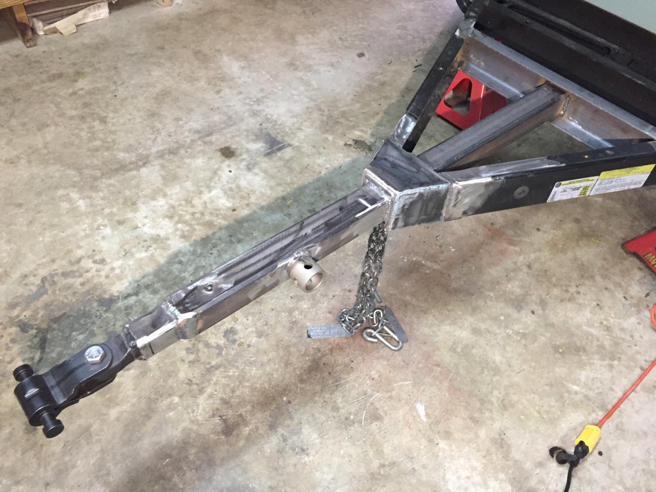

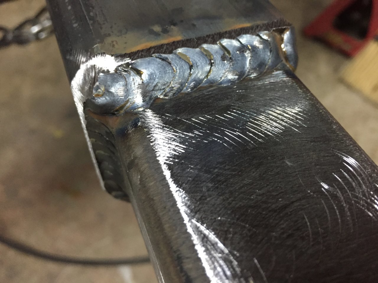

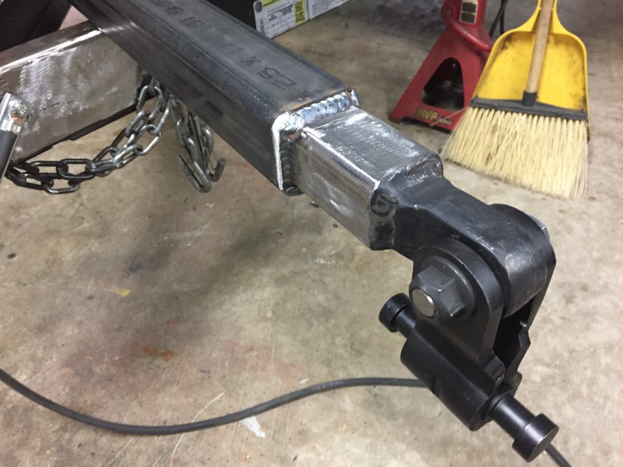

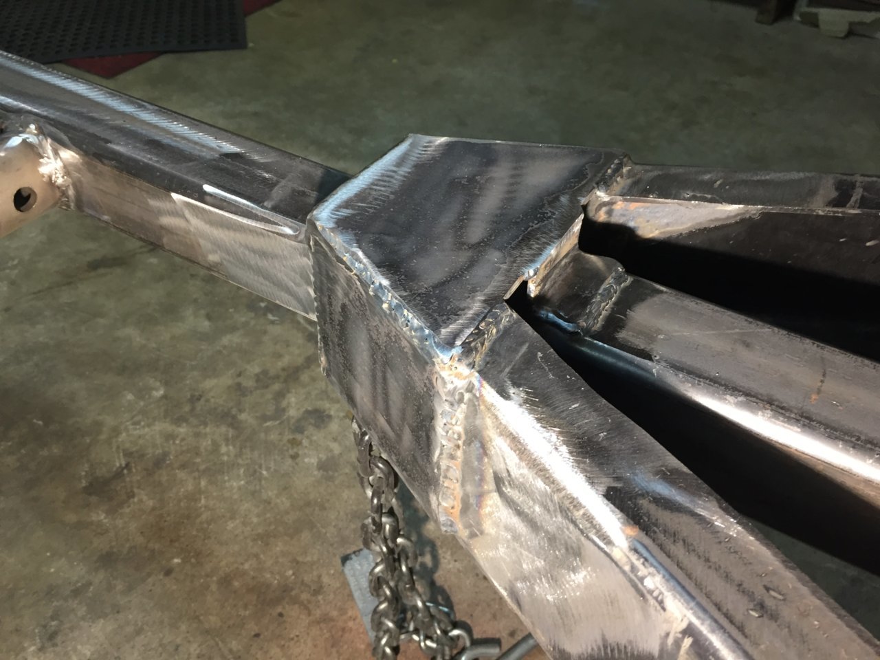

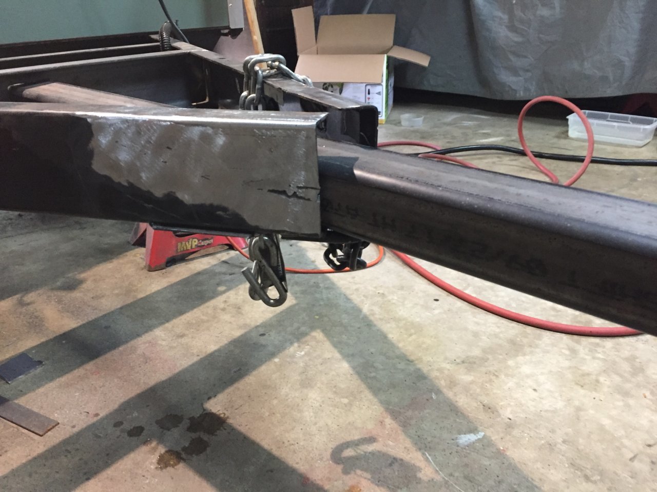

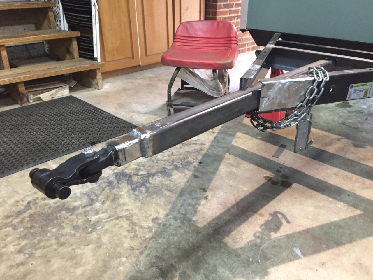

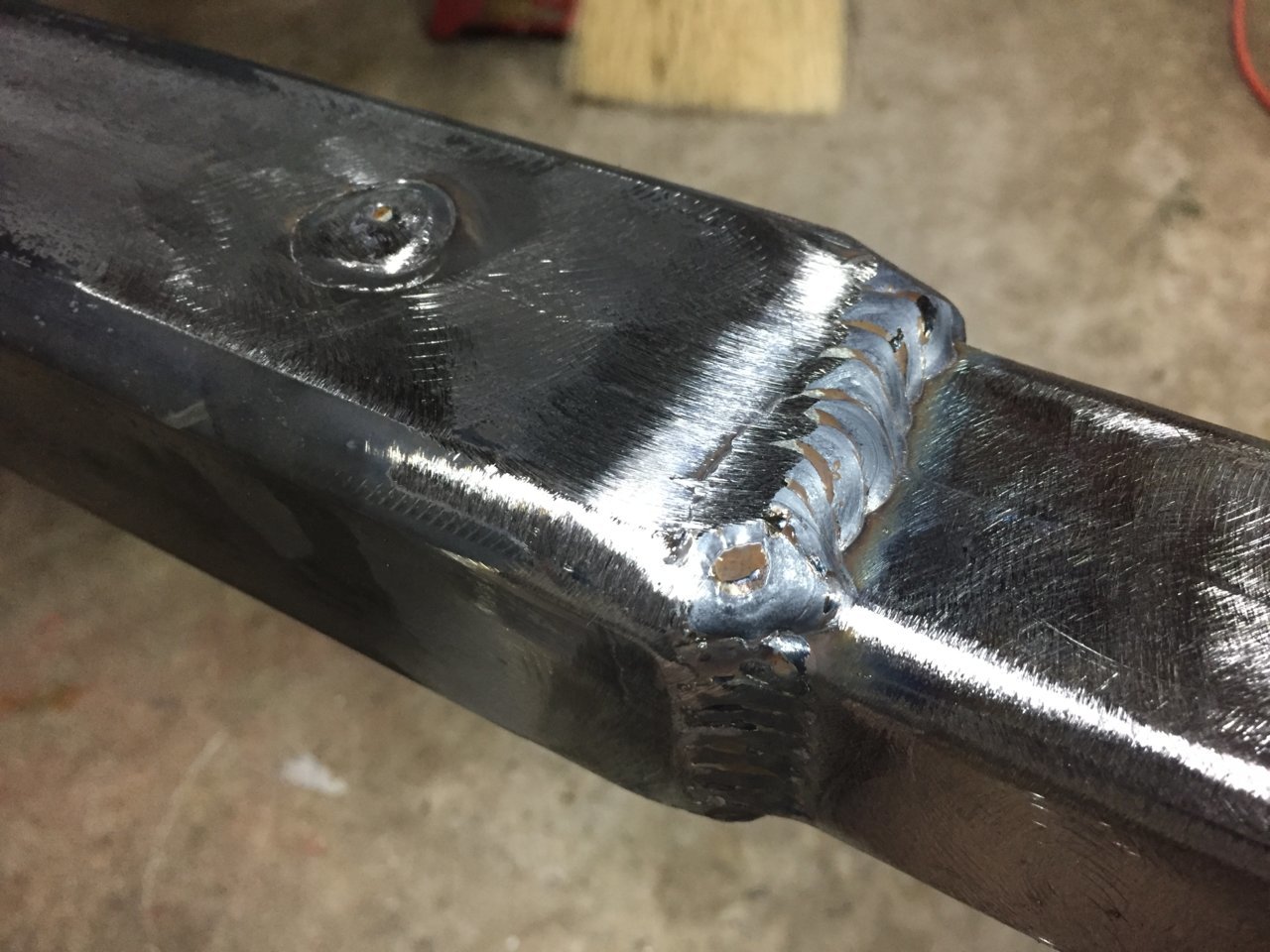

    Tngue exstension and Lock n Roll:
    So last weekend I stripped everything off the tongue and we moved it into the garage

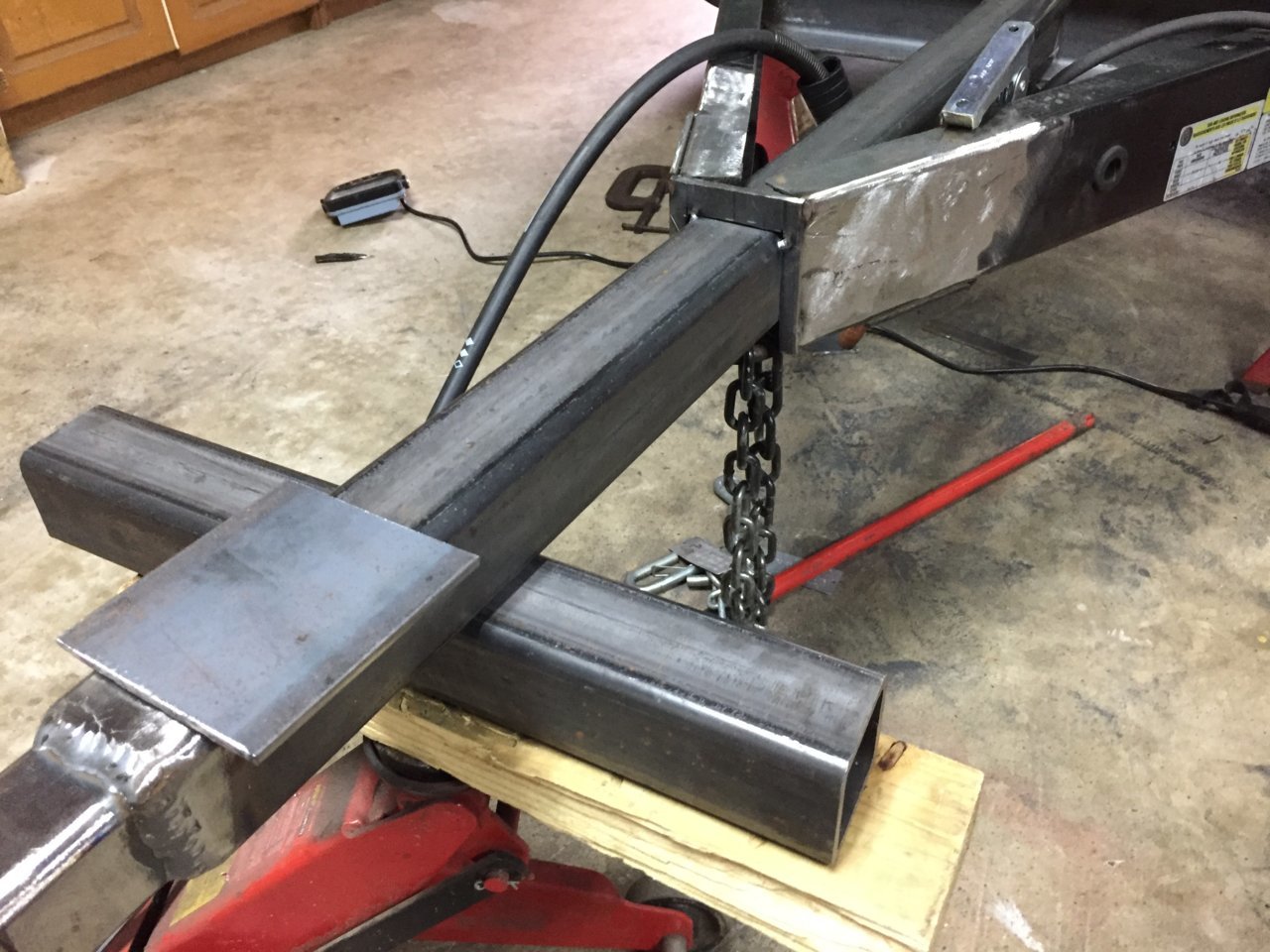

    During the week I got the new cross member cut, fitted, and tacked in place.

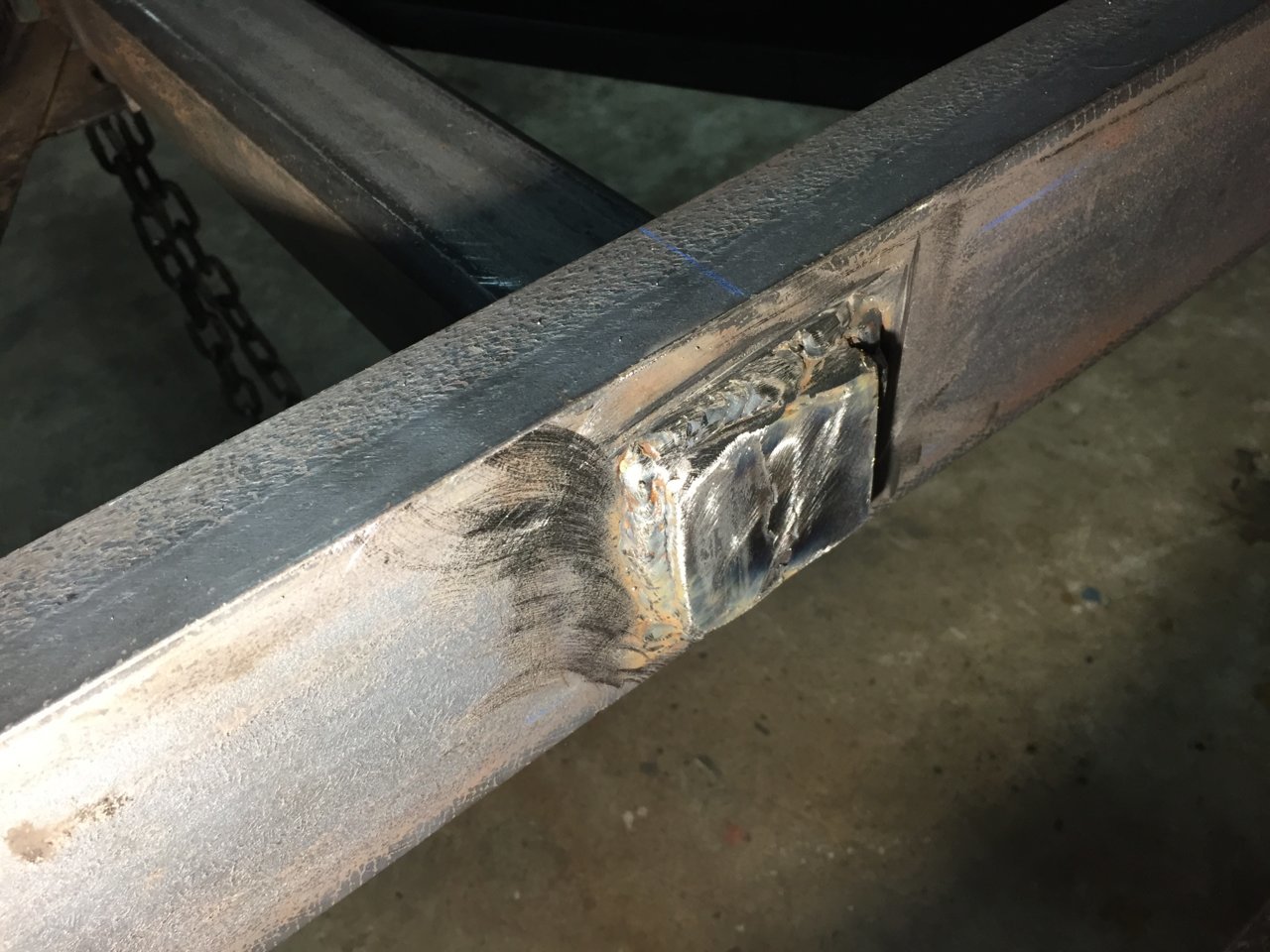

    Thursday I got the correct tube to extend the tongue with so I inserted the Lock n Roll hitch end and welded it all together. It was welded solid on the end and I drilled 2 holes in the top and bottom of the tube and plug welded.

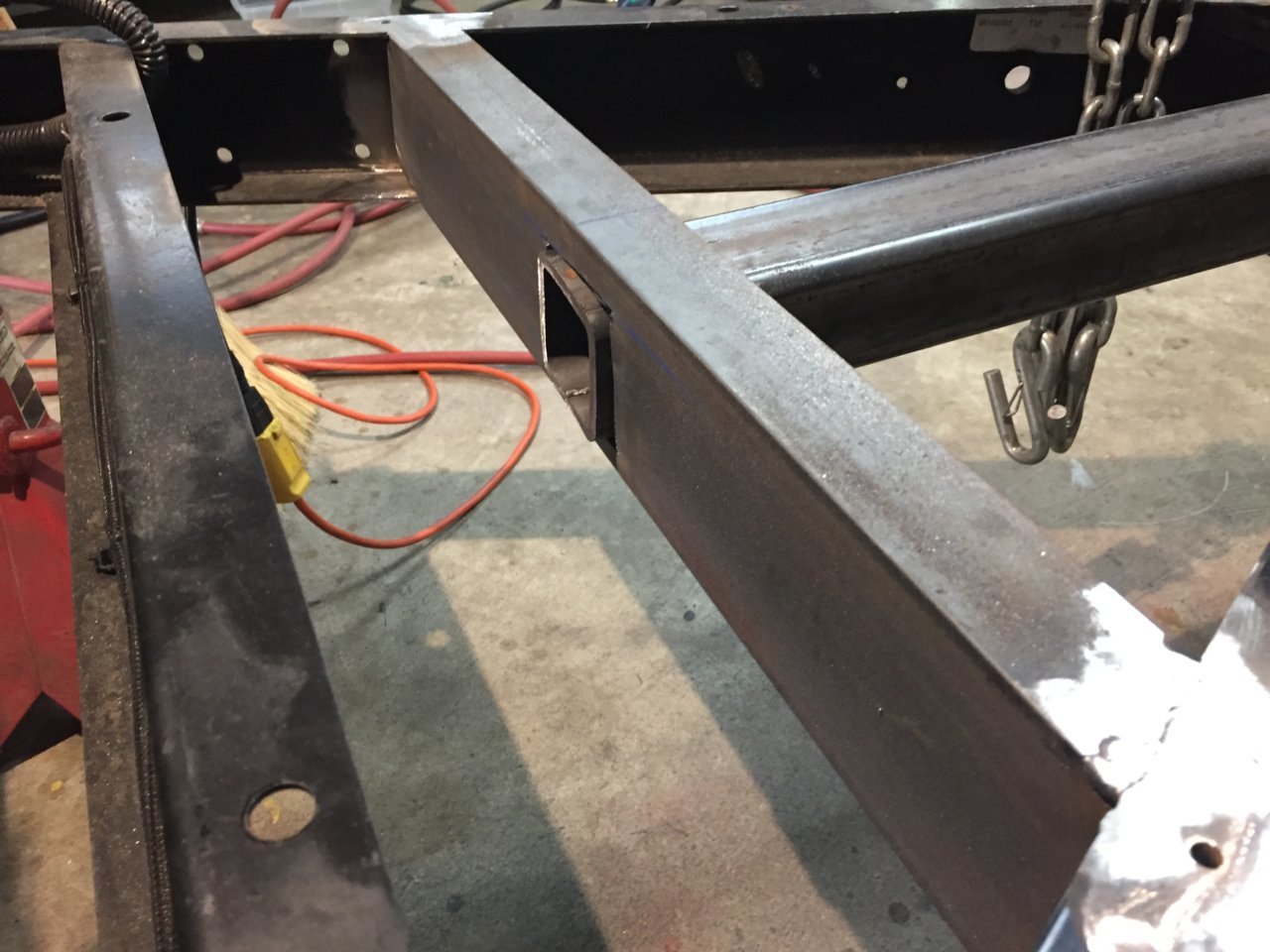

    I decided against just but welding the tube to the cross member so I cut a square hole in the cross member to slip the tube through so it could be fully welded on the bac side and welded on the front side also. The cross member was welded in completely. The new tongue was then put in place, plumbed, squared and tacked in place.
    I fabbed up plates and capped the end of the frame and welded everything solid including the tube going through the cross member and the tube was capped.
    The weld on ring for the tongue jack was installed
    I cleaned it up and hit the bare spots with etching primer and sprayed with DIY bedliner.
    Tomorrow will be extending the wiring harness then on to planning the next phase the box for the fridge and storage

    :thumbsup: nice work! that looks good. now time to test it:mudding:

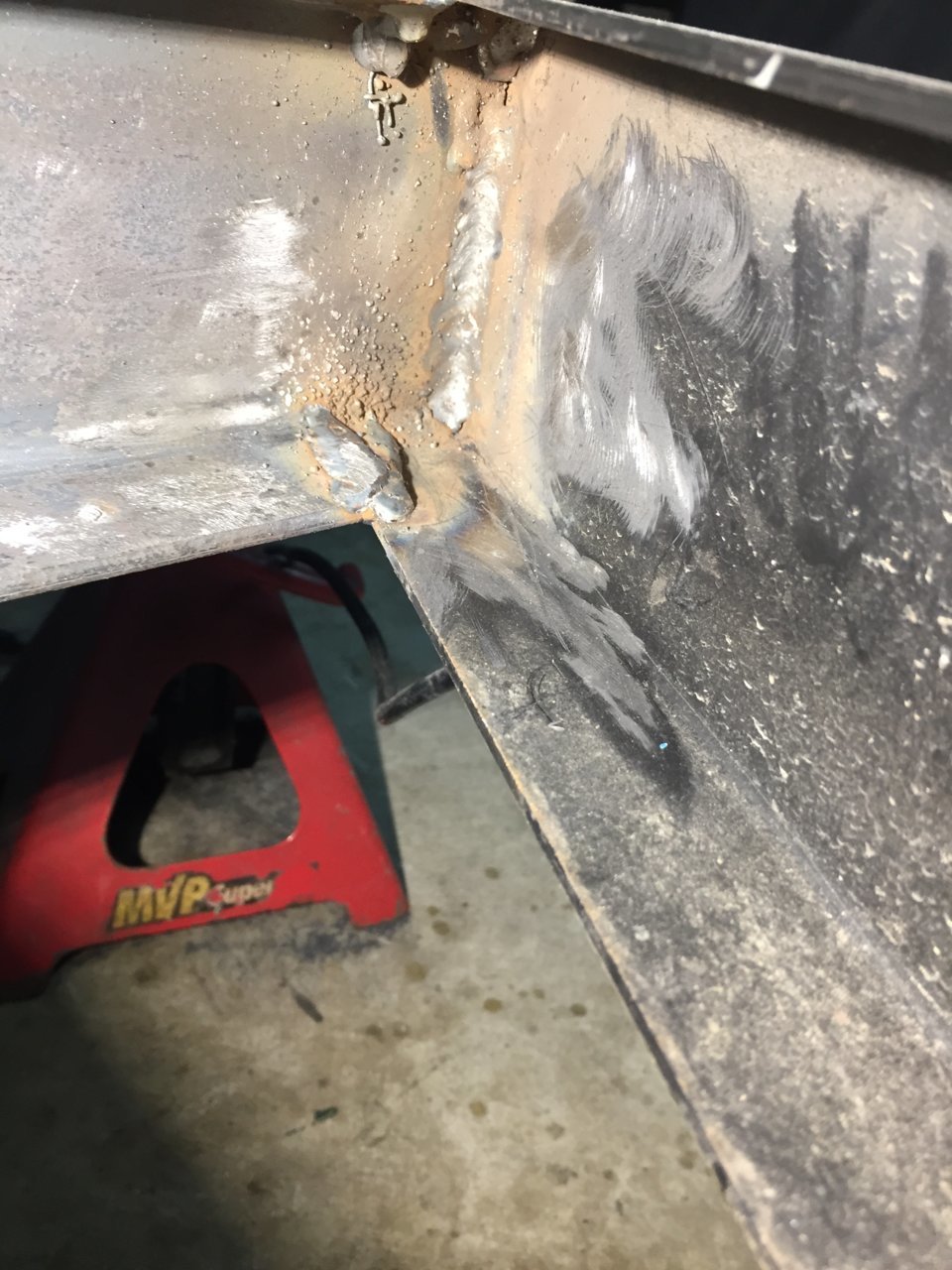

    Finished it up today. I got out and started working on it thinking all I had left was extending the wires. As I was doing so, it dawned on me that the safety chains would no longer reach either so i had to come up with a plan for that.
    I cut the mount off for the chains. I had a piece of 7/16 or 3/8 bar on hand so I shaped it like I wanted and cut away the excess. I placed it and welded it under the tongue and it was secure, but me being me, I was affraid if it got hit it could bend so I cut a couple of gussets and installed them. Everything welded solid. That's kinda what I enjoy about this stuff, I can make stuff and if I change my mind or have a better idea I can just cut it off and do something different.
    And done wires all run and secured, I drilled holes in the tongue and frame plates, tapped the holes for 1/4" bolts and clamped with insulated clamps
