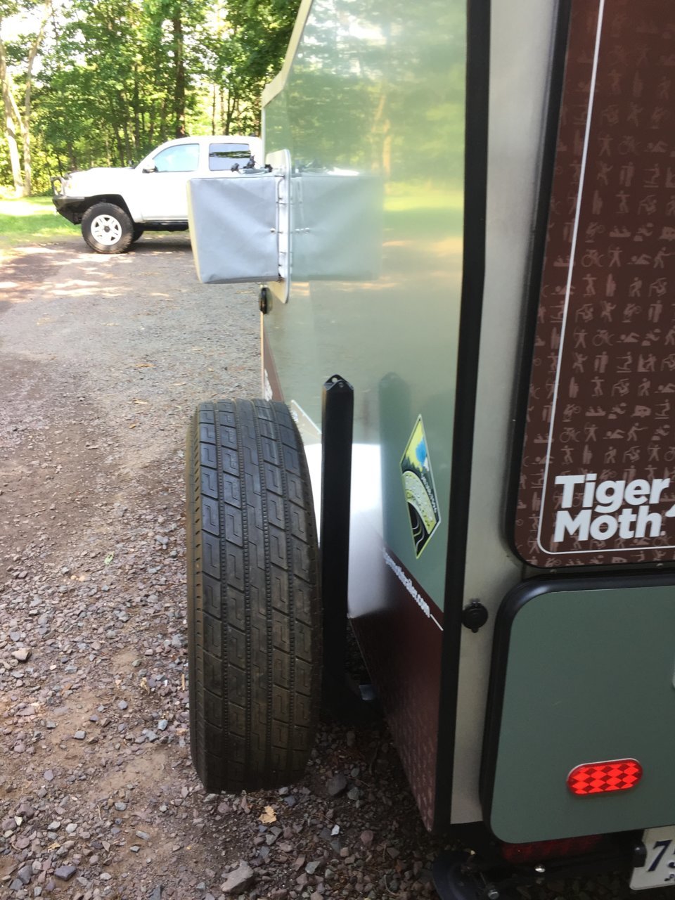

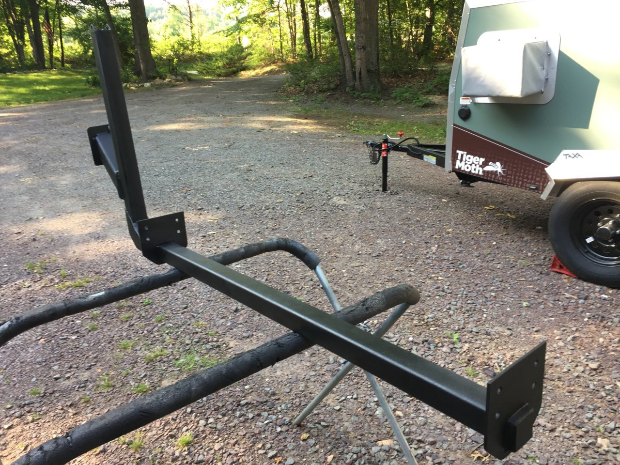

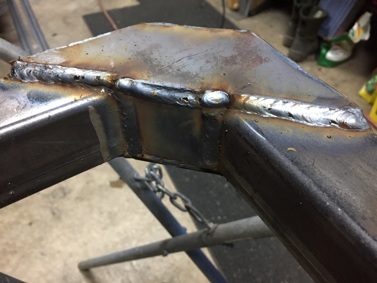

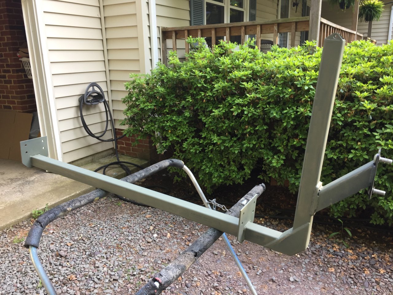

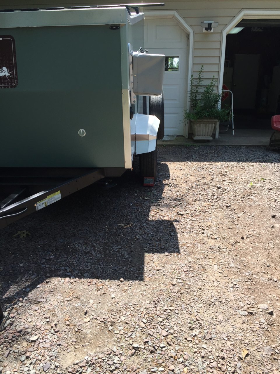

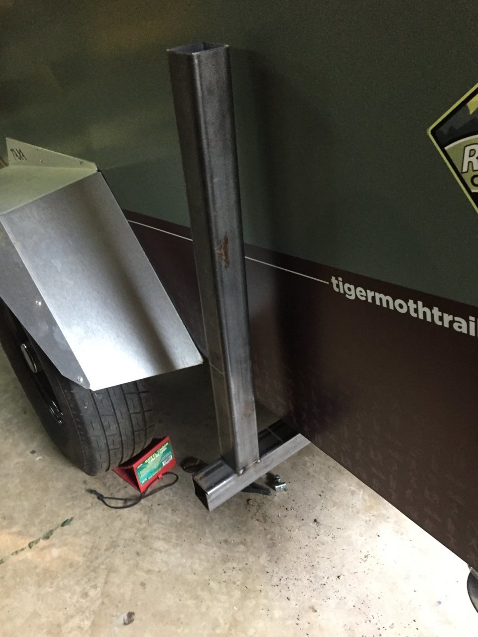

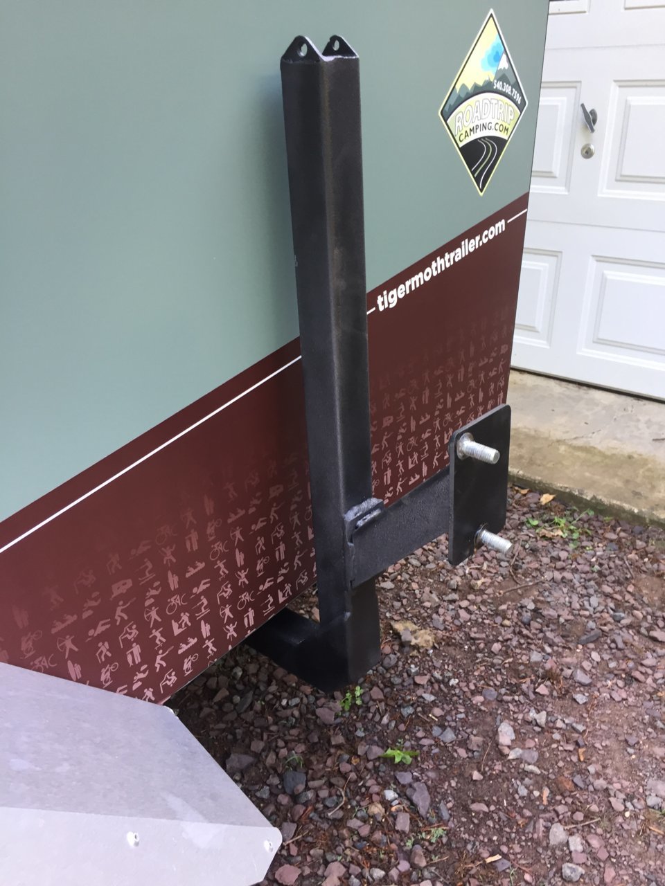

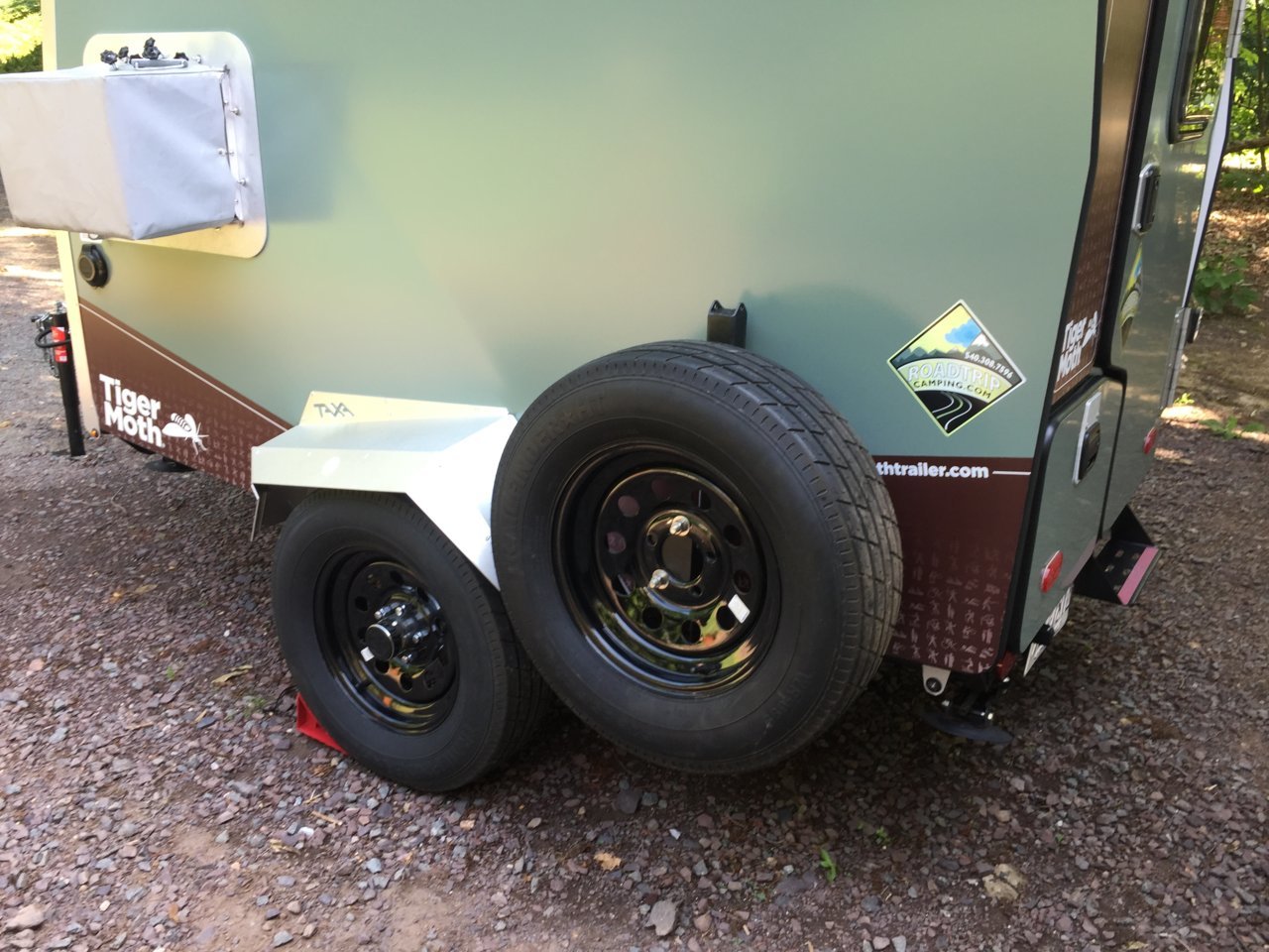

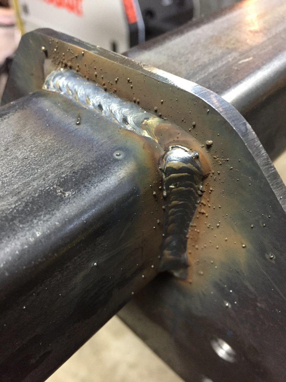

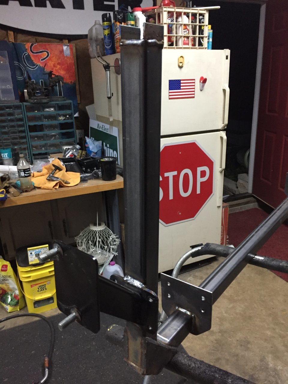

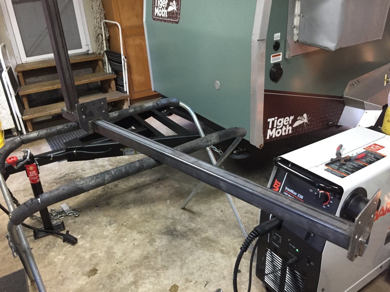

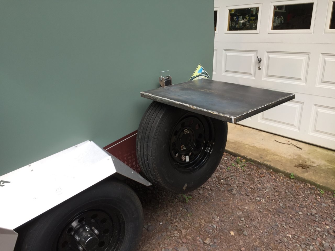

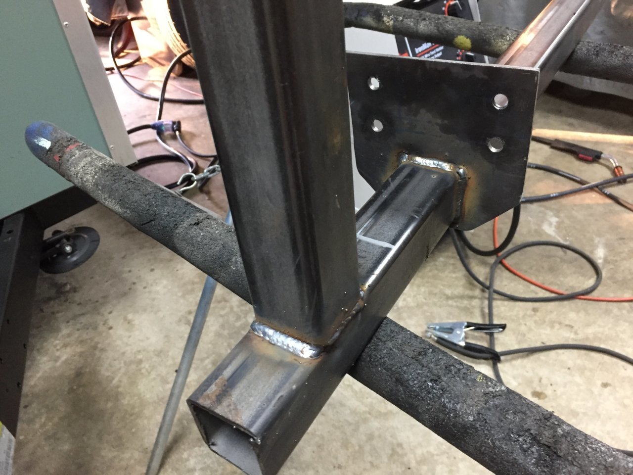

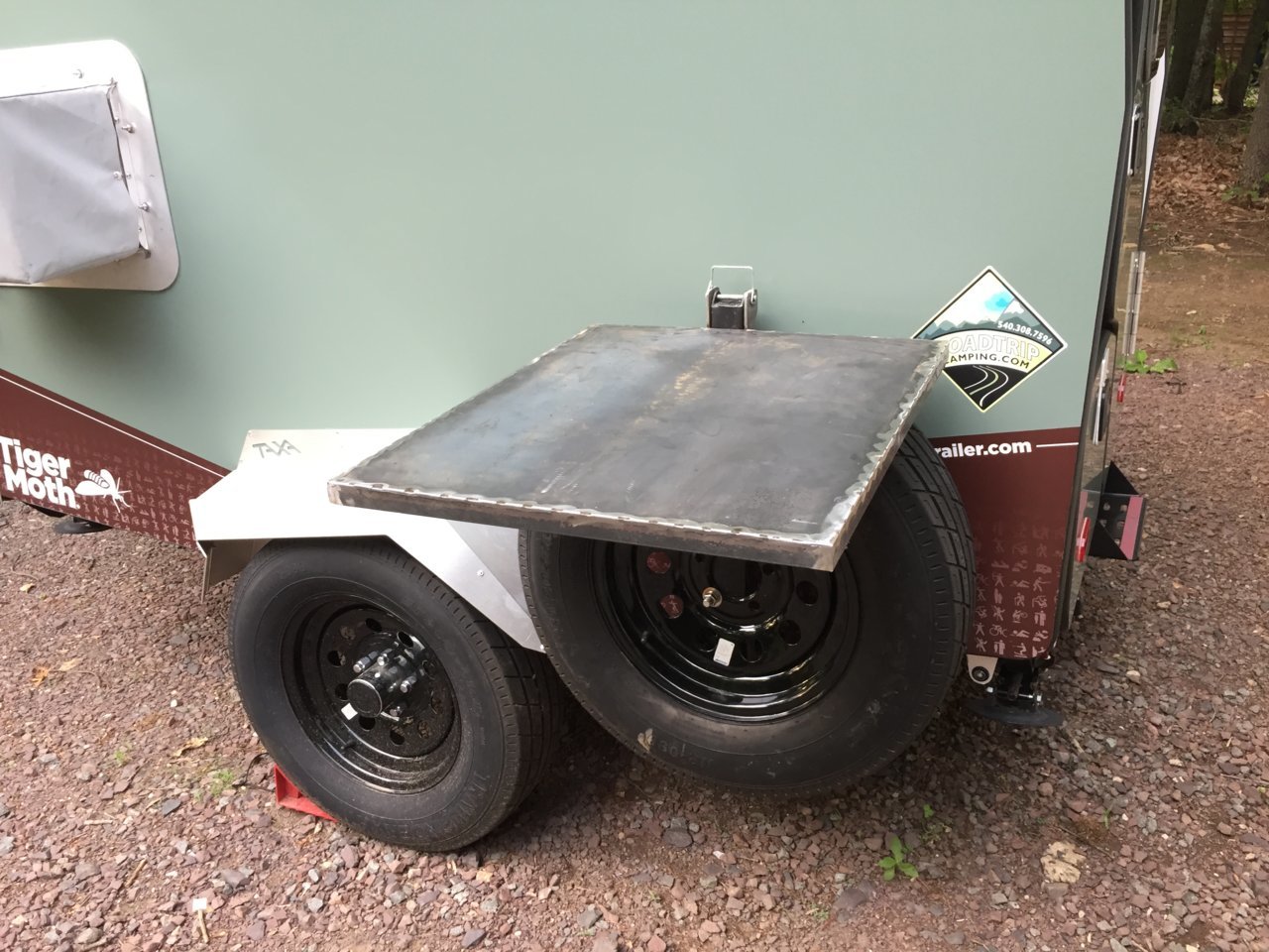

    Spare tire relocation:
    So with the tongue exstension and the storage box that will be going there I lost my mounting point for the spare tire. I pulled a little inspiration from a guy on the Tiger Moth FB page, how he had a fabricator mount his spare for him. He went with 2 I'm sticking with a single. If i need another it can go in the roof basket.
    With the extra weight that's going on the front with the box and fridge I decided to mount the spare low and to the rear to give at least some off setting weight. I got some 3/16 plate and 2" square tubint and went to work.
    First I cut a couple of 3/16 frame plates, drilled 4 holes in each to mount to the frame with 3/8 bolts, taper cut the bottom of the plates and 2" square holes for the tubing to go through. the frame plates were mounted to the frame in the rear 1 on each side of the frame and the bolt holes are straddling a frame cross member so the tubing will line up with the cross member. After mounting the frame plates I cut the tubing a little long and ran it through the frame plates, lined it up and tacked it in place. The vertical post was then plumbed and tacked in place.
    I removed it from the camper and put it on a stand and welded everything solid, All the tubing was capped, and the outer corner was gussetted and boxed
    The top of the vertical post was capped with angle and later cleaned up and holes drilled which will allow me to make a removeable table or shelf that will rest on the tire and can easily be removed and stowed for transport..
    Everything was cleaned up, sprayed with etching primer, and sprayed with bedliner
    I got it mounted to the frame everything lined up so far so good

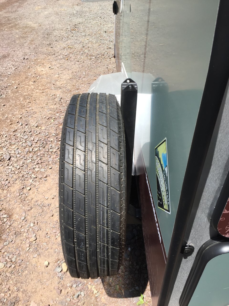

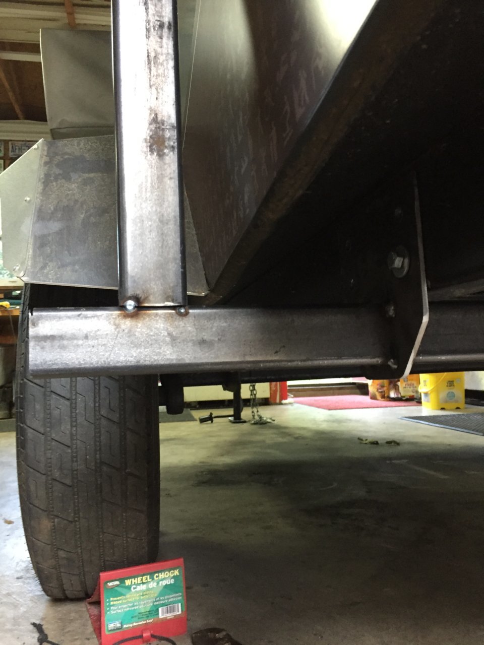

    I mounted the spare and didn't really like what I saw. Everything worked fine but the tire stuck out past the fender of the camper and well it just wasn't what I wanted.
    Ok I'm a little anal about things but just not what I wanted. The tire was secure but I just didn't care for how far it stuck out. I measured the distance between the tire and the vertical post, removed the tire, removed the mount, cut 2" from the arm exstension that went from the vertical post to the mounting plate for the tire, welded everything solid, and remounted the assembly to the camper. This is what I get for thinking it was fine to repurpose the factory spare mount and use it with this bracket, it works now. When I remounted the spare it now contacts the vertical post, the wheel mounting plate, and is even with the fender. So, all ended up good just what happens when you think you can cut corners to save time.
    Now on to building the tongue box but it's humid as crap outside so took a break

    Good day playing! Spare tire mount done and got a good start on the box for the tongue

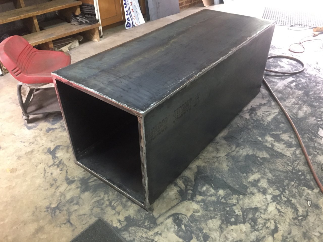

    Shit i cut and welded all 3 days last weekend then came home tonight and finished up a table project. The box itelf is done except the doors. The took forever to weld trying to take my time and not get the steel too hot.

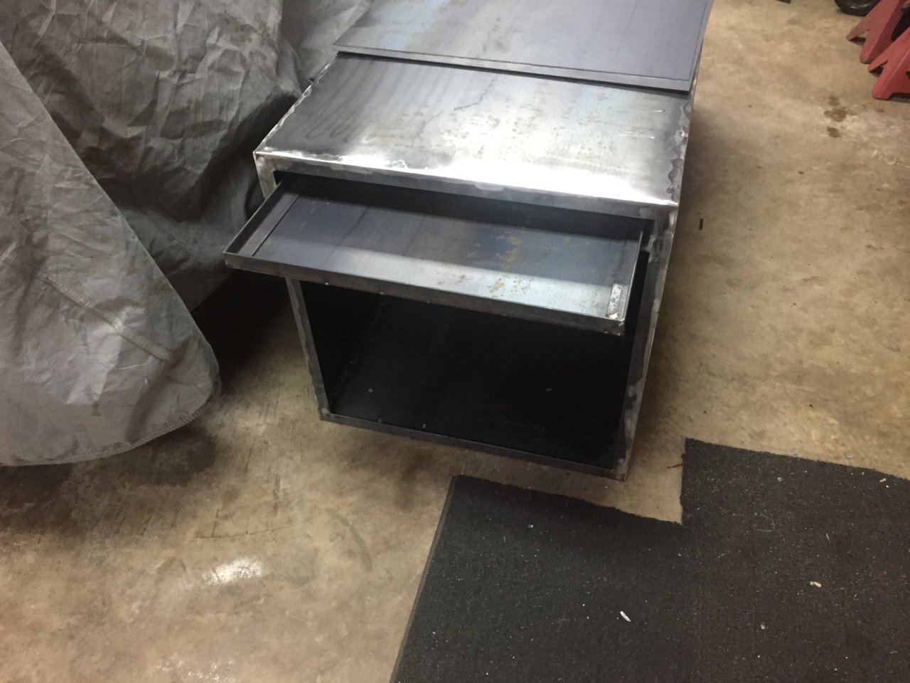

    Table:
    I planned on makeing an extra table that would mount to the top of the vertical post on the spare tire mount. I had to get the tongue box mostly built so I could see just what size to build as it will be stowed on the box for transport.
    It ended up being about 21.5x 25 I added some angle inside the box on the storage side to act as runners to slide the table into. The table itself just pins into the top of the post and rests on the tire.
    Here t's sticking out of the top of the box so you can see where it goes. I figured it would be dead space anyway so may as well put it to use
