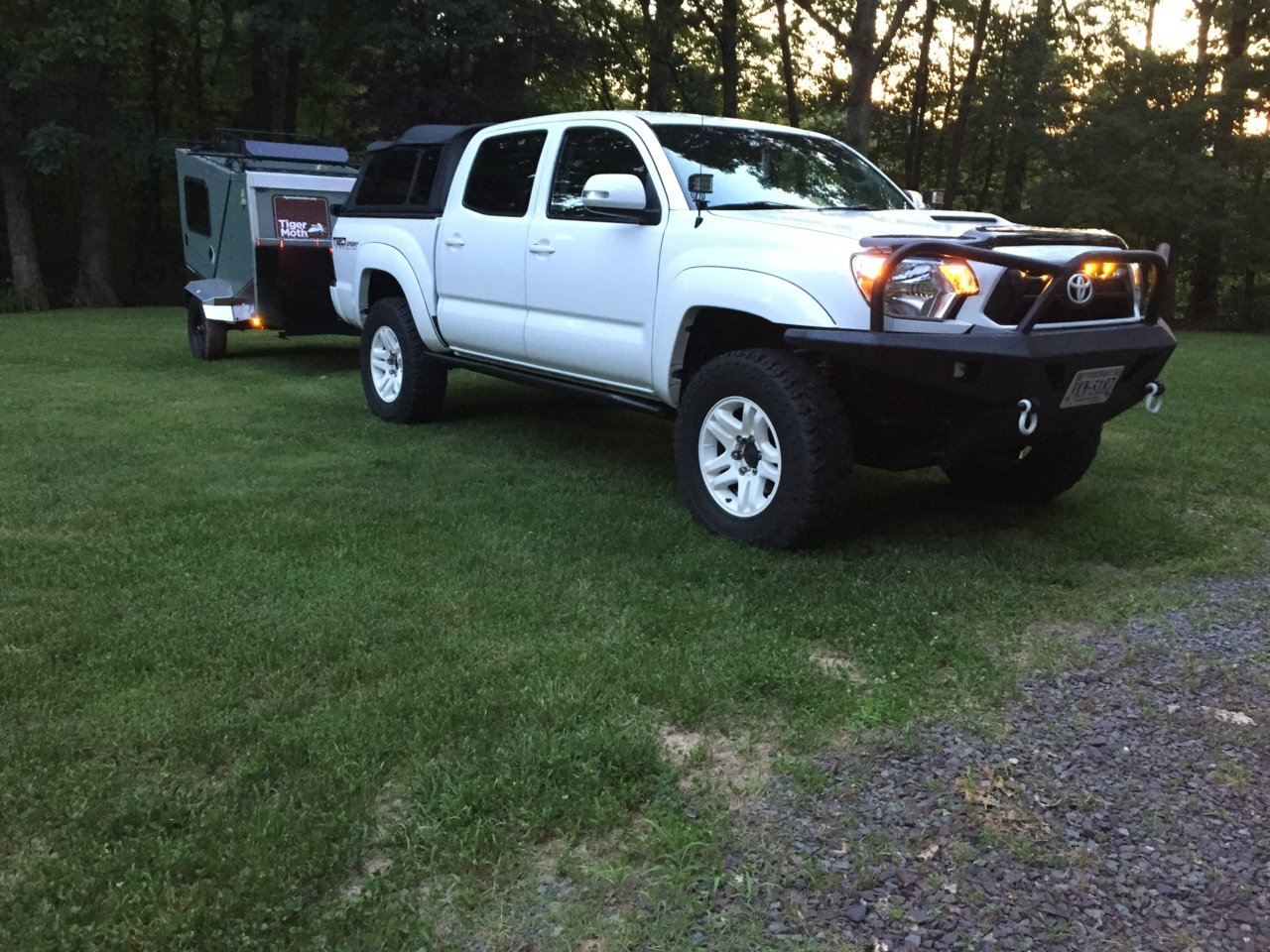

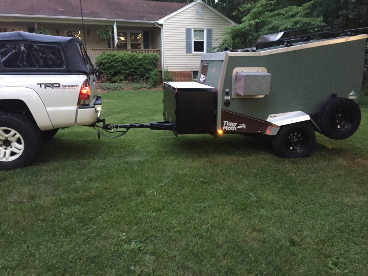

    First hook up today after all the work. Everything is in the camper except the fridge and food. Truck only dropped about 3/4-1" I'll take it for a drive tomorrow to see how it tows but shuldn't be any problems

    Looks great, nice and level. You should be good towing too.

    Test drive was succesful! No difference in power or breaking. Only a minor bit of bounce when i hit bumps but very small trailer sits almost level. All that will be taken care of eventually if i get a set of heavier springs for the truck. The hitch is very smooth and the extra length made it noticeably easier to back up.

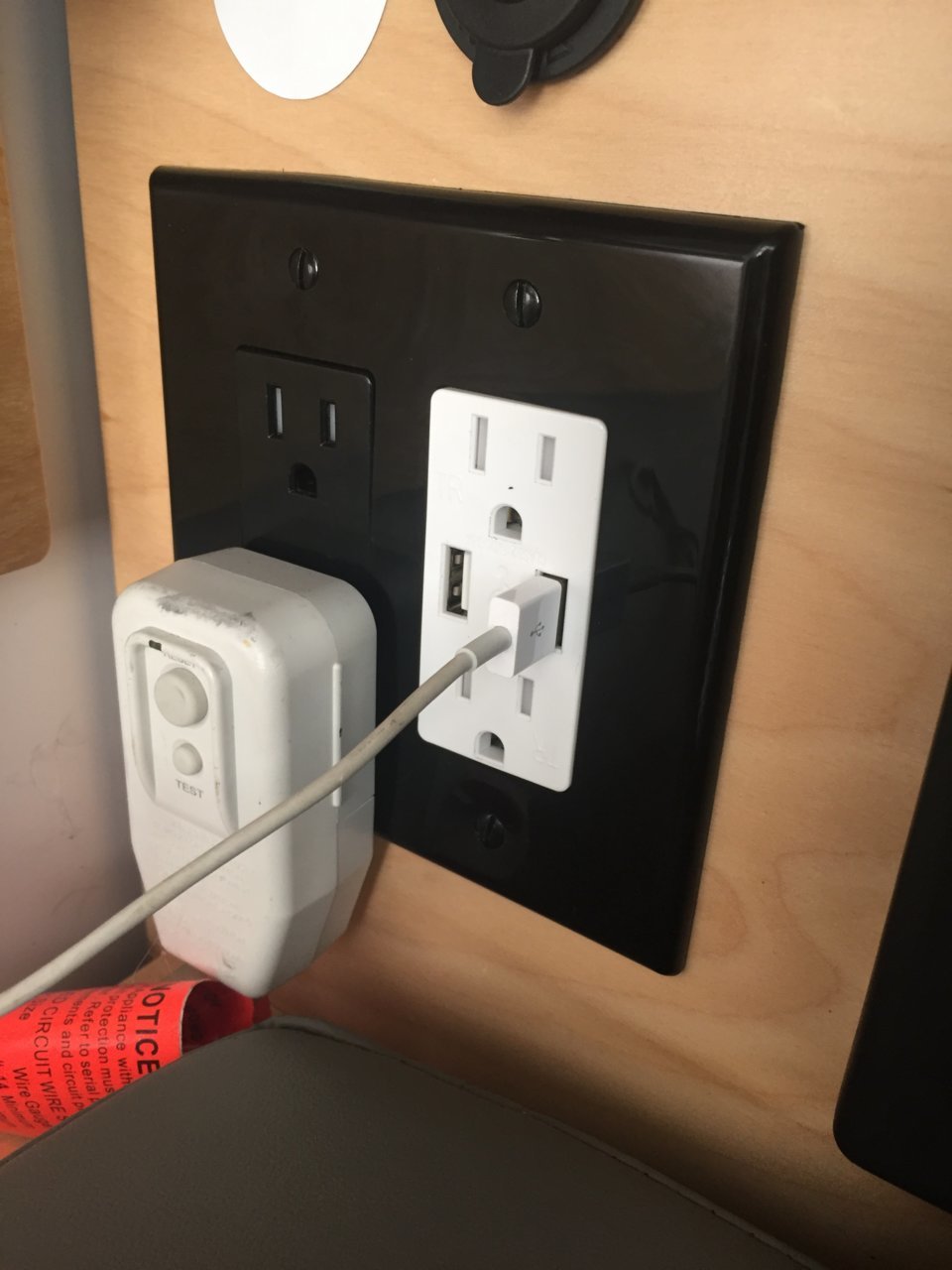

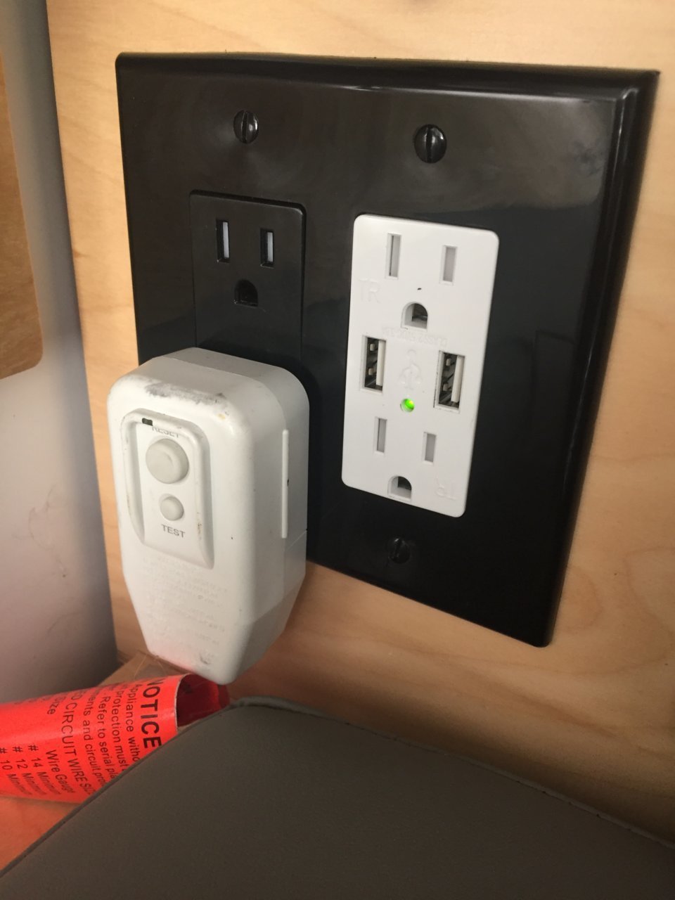

    I think I'm going to add this mod to my camper as well. Are they all 120 AC outlets only? Until the little one gets older we won't be boon docking for a bit.
  7. Jun 27, 2018 at 7:32 PM
    #527
    Casper66
    Casper66 [OP] grumpy ass
    Apr 3, 2016
    #183160
    32,047
    Culpeper, Va.
    '15 DCSB TRD Sport 4wd super white (sold) '13 access cab SR5 4wd
    piddly stuff
    I believe so that small I was ng for though. It takes a gfci outlet cover also
    MarX[QUOTED] likes this.

    I hate these damn phones. Yes, I believe they were only for 120v ac but that was all I was looking for also

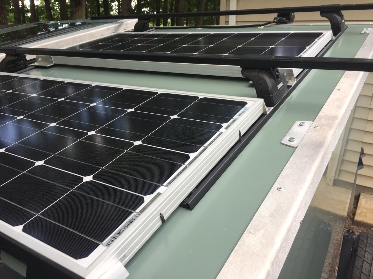

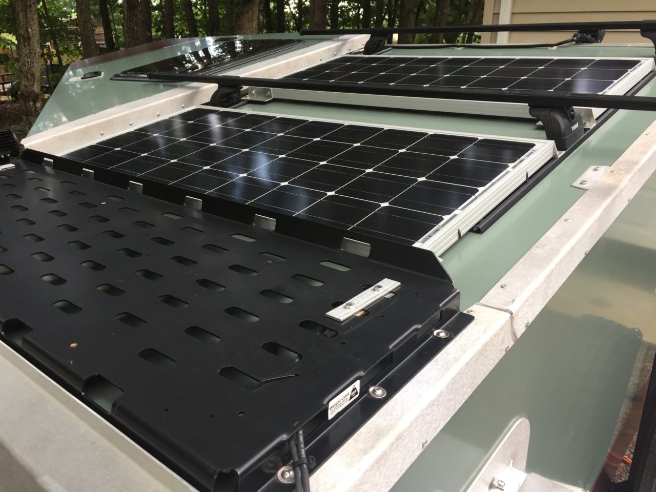

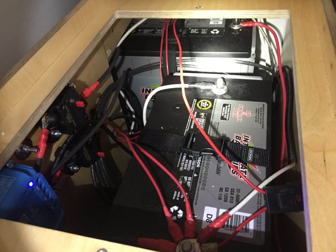

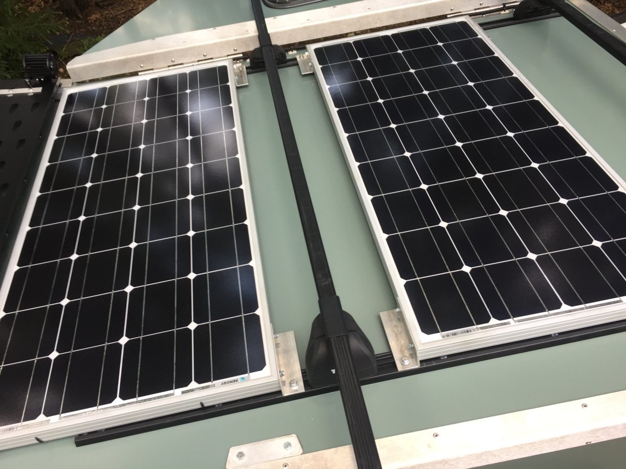

    Electrical supply—— dual batteries and solar:
    I was able to pick the camper up today finally. I took it in to the dealer to have the ac warranted and decided to have an electrical upgrade while it was there.
    Rhino rack tracks were mounted to the roof with polymer bushings in the roof to keep it from buckling. 2 100w 21”x42” panels were mounted in the track which also allowed me to retain use of the Thule bars.
    Inside where the single battery had been dual group 31 agm spiral core batteries were installed along with twin 30a breakers and a Victron Energy charge controller that’s monitored via Bluetooth on my phone.
    I like to do all my own work when I can but idk squat about solar and got a good deal from the dealer so just let him have at it. I’m glad I did as he did a really nice install.
