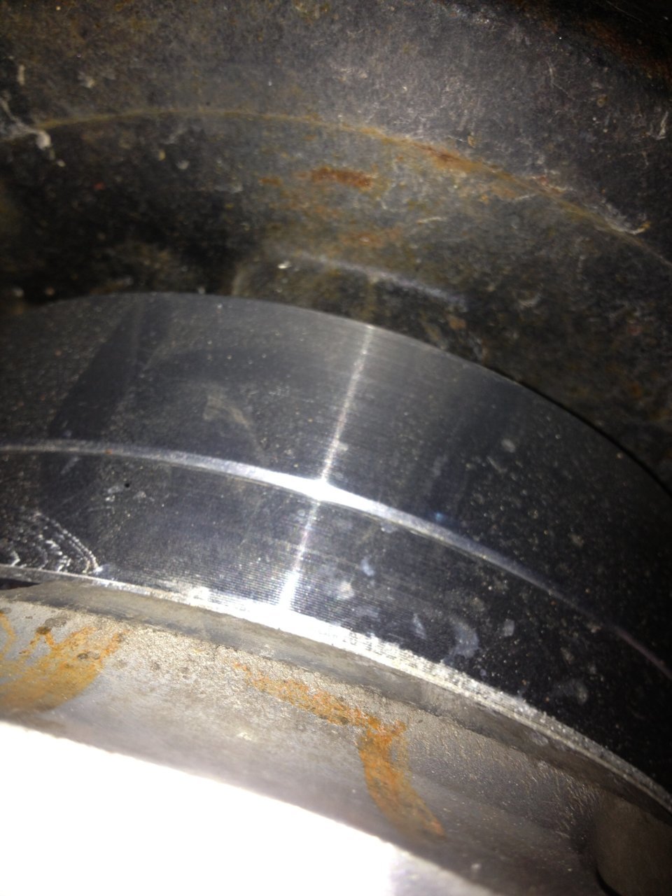

    Ok Jeff since you have done this you can perhaps help me with a concern. Withthe Toyota wheels being hub centric and these hub adapters being a completely different size do the wheels still work fine with this or did you have to find some kind of spacer to fill the gap between the wheel bore and the hub?

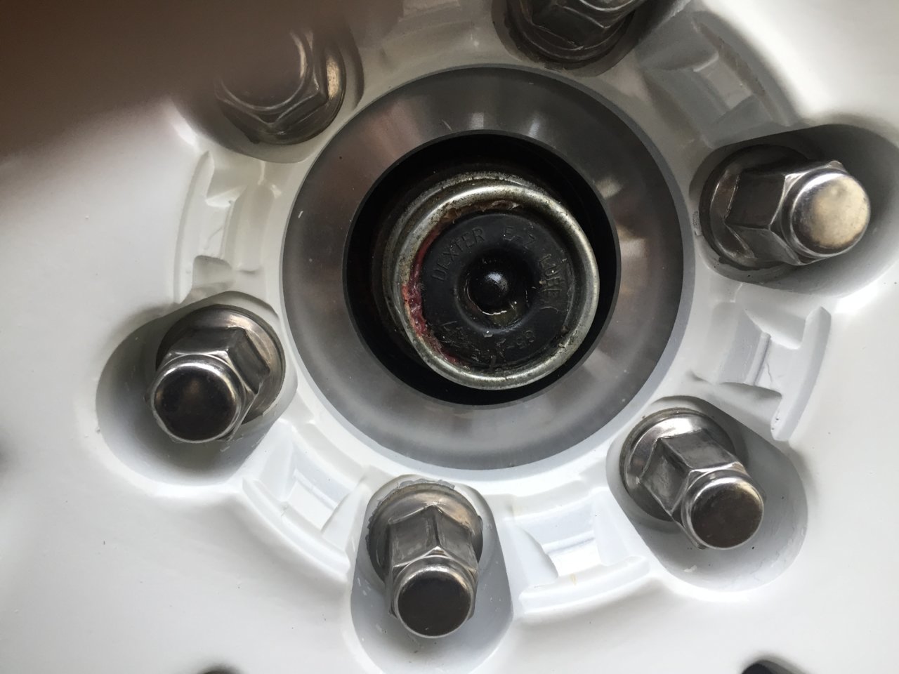

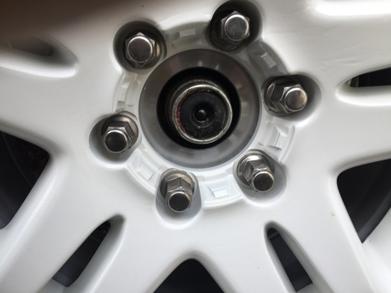

    image.jpg image.jpg Here's what my wheels and adapters look like. Hope this helps. image.jpgimage.jpg image.jpg

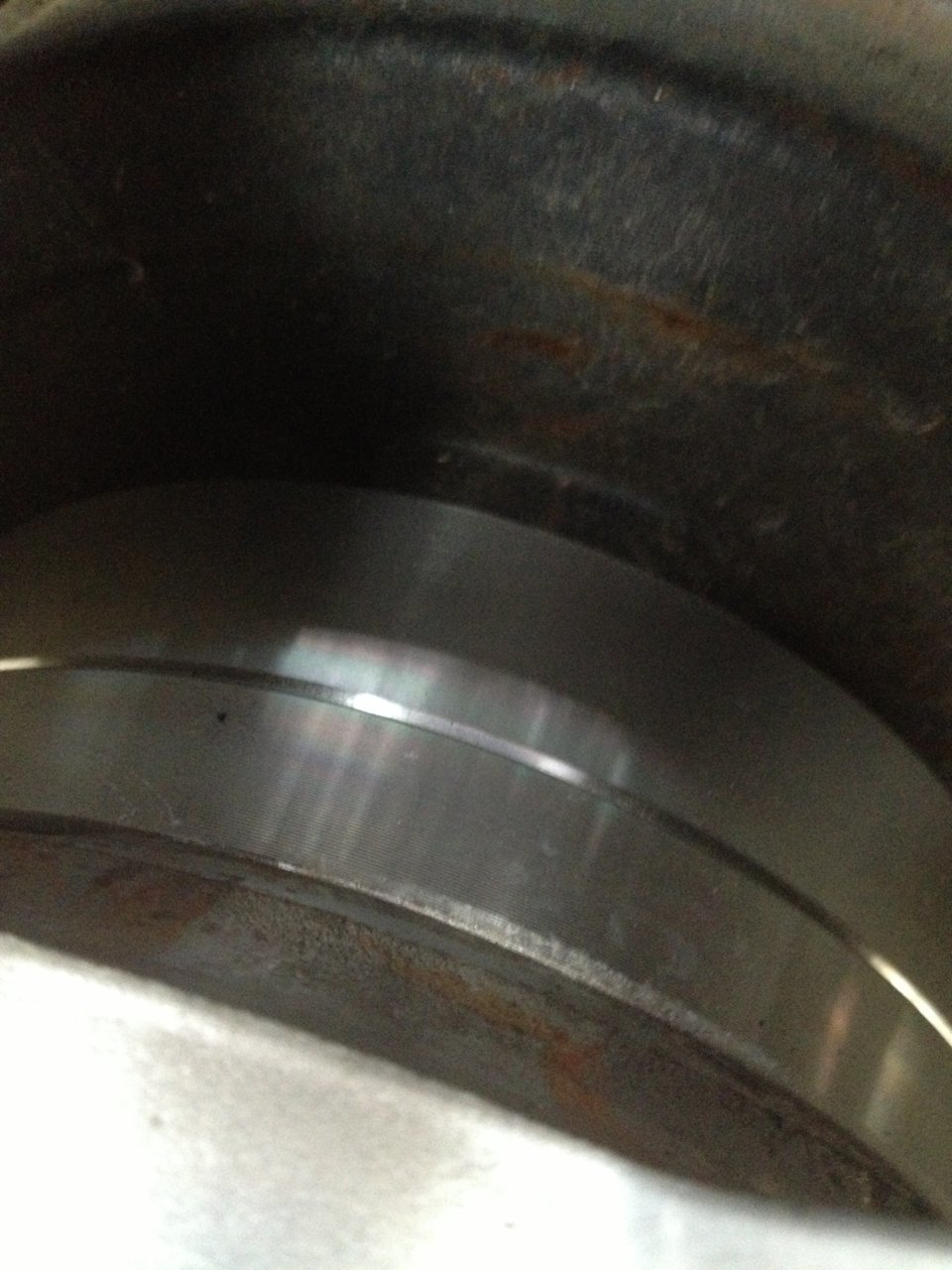

    Thanks Jeff I'm looking for pics of the wheel bore showing the adapter. @Wild Crow texted me a few but a little hard to tell. Here is what mine looks like. This is what my concern is you can see the space between the wheel bore and the hub. With these being hubcentric I am affraid they may vibrate or shift without fitting tightly with the hub.

    You'll be good without a hub centric spacer as the mag shank style lugs will still lug center the wheel just fine.

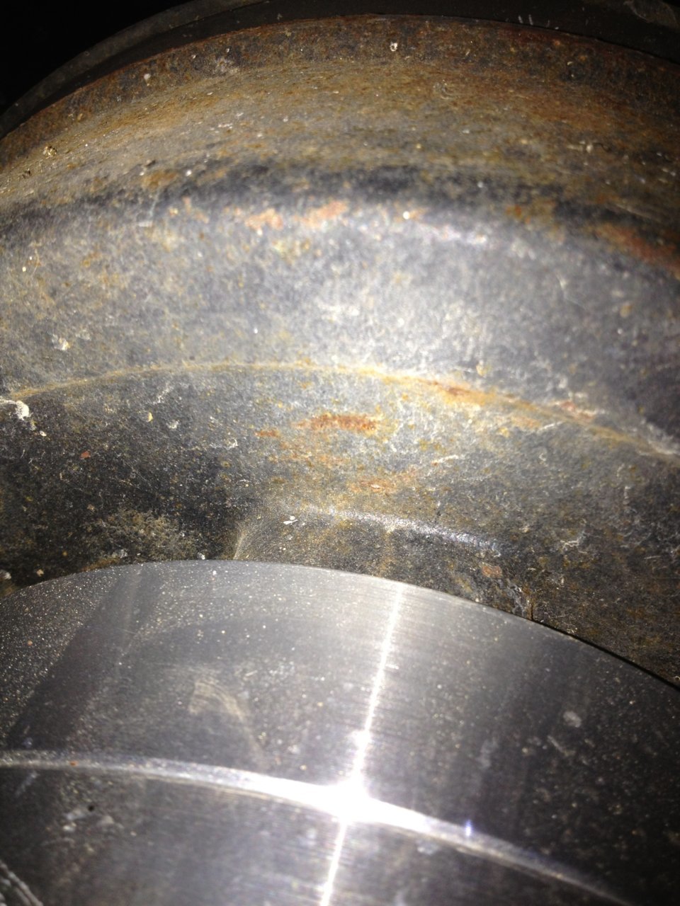

    I'll put the center cap off tomorrow and take some pictures.

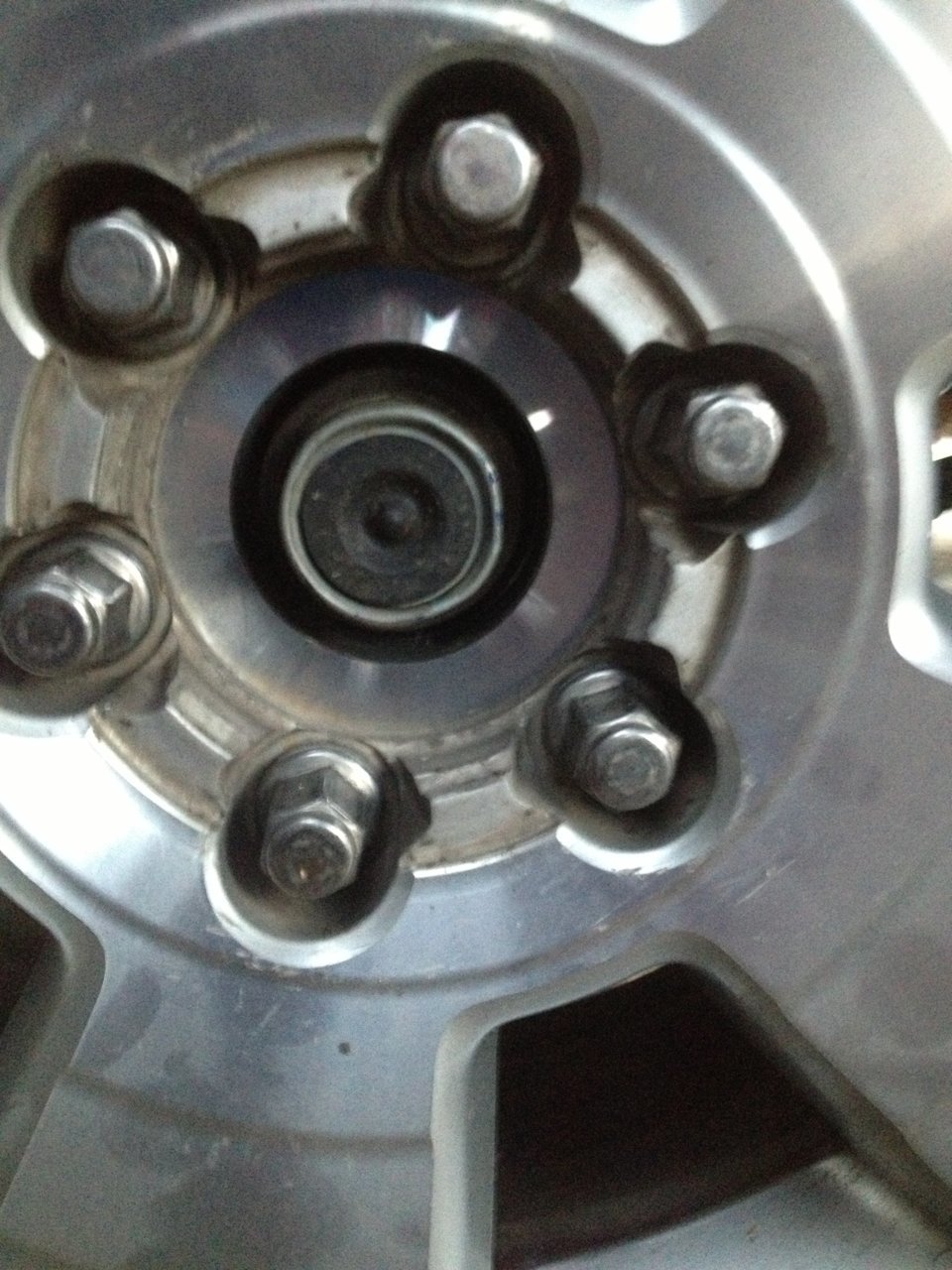

    Here you go @Casper66
