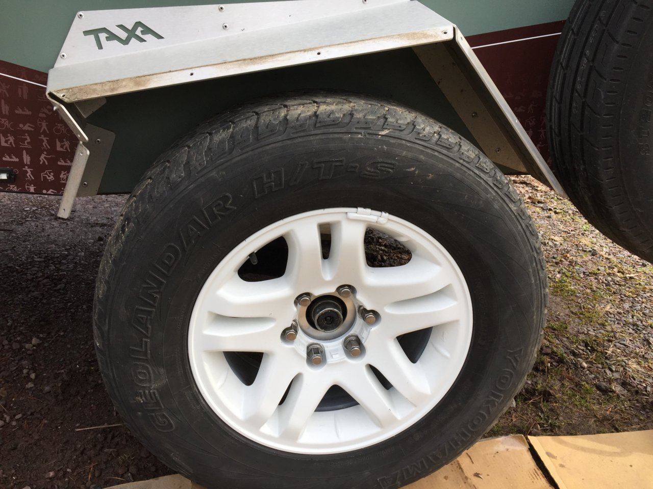

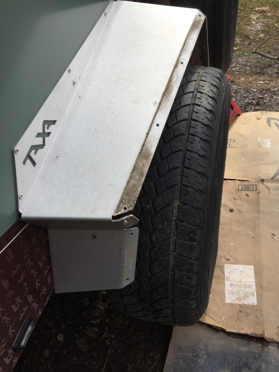

    Well I started a couple of weekends ago trying to fit the "new" wheels and tires and that didn't go as I had hoped but I knew it would take a little work. Following a suggestion here I contacted the dealer, told him what I was trying to do, told him my issue, and asked about the Dexter lift kit. He said yep and he had them in stock $65 with all the hardware all grade 8, 1/2" hardware and the brackets. $15 cheaper than Etrailer and no shipping I just had to go get them.
    We finally had a decent day of weather so I decided to tackle it. I had to work out in the driveway since it won't fit in the garage anymore. It was most level down toward the bottom so I moved it there and set up everything. Nothing like laying in the mud working when you have a nice garage but can't get into it. Just dirt shit washes off so I went at it.
    lift was pretty strait forward. I jacked the camper up using the front jacks and jack stands in the rear to secure it. Removed the stock wheels and tires. Loosened up the axel and dropped one side at a time as per the directions and installed the lift torqueing to their specs 100 ft pounds. Pretty simple and it works. Of course I can't leave anything alone so when all is said and done I will weld the brackets to the frame and I may weld a cross brace from one side to the other eliminating any flex and stabalizing it. Neccessary? probably not but good insurance.
    Then on went the hub adapters. I'm still not sure about these. If I don't like it or it shetches me out too much I'll order some 6 lug hubs and 1 " hubcentric spacers and redo this part.
    Then on went the wheels and tires. They mounted right up and torqued to 100 pounds. The driver's side fender still has the outer piece removed and plenty of clearance. The passenger side has the outer piece on it. I took pics so everyone could see what it looks like. I'm not sure about this part. IDK if it'll be ok with the outer piece on or if it will end up cutting the tire especially if i get one with more tread on it. The only other options I can think of is to ither trim the outer part of the fender extension or remove it, trim the angled down part and get some black plastic and make some flares that will basically stick strait out. Ideas are welcome here.
    Passenger side with the outer piece in tact
    Driver's side with the outer piece removed
    Big difference in tire size
    Sitting level the camper is now considerably higher than the hitch. This isn't really an issue as I have a bumper with a hidden hitch coming so that will move the hitch up considerably and this should be just about perfect. With the camper sitting level there is now 21" from the frame to the ground ofcourse still considerably less from the axel to the ground. It looks funny right now it's so much lower in the front when hooked up but that will all be changed when the bumper is installed.
    I will admit I wasn't too sure about matching white wheels on a green camper but I really like it!

    That looks awesome!!!! I like the white wheels with the Tiger Moth sticker they make it look more complete. Also as far as tire rub how much will those torsion axles flex you may be fine with the outer portion on. With the bumper and new suspension that hitch will probably line up perfectly!!!
