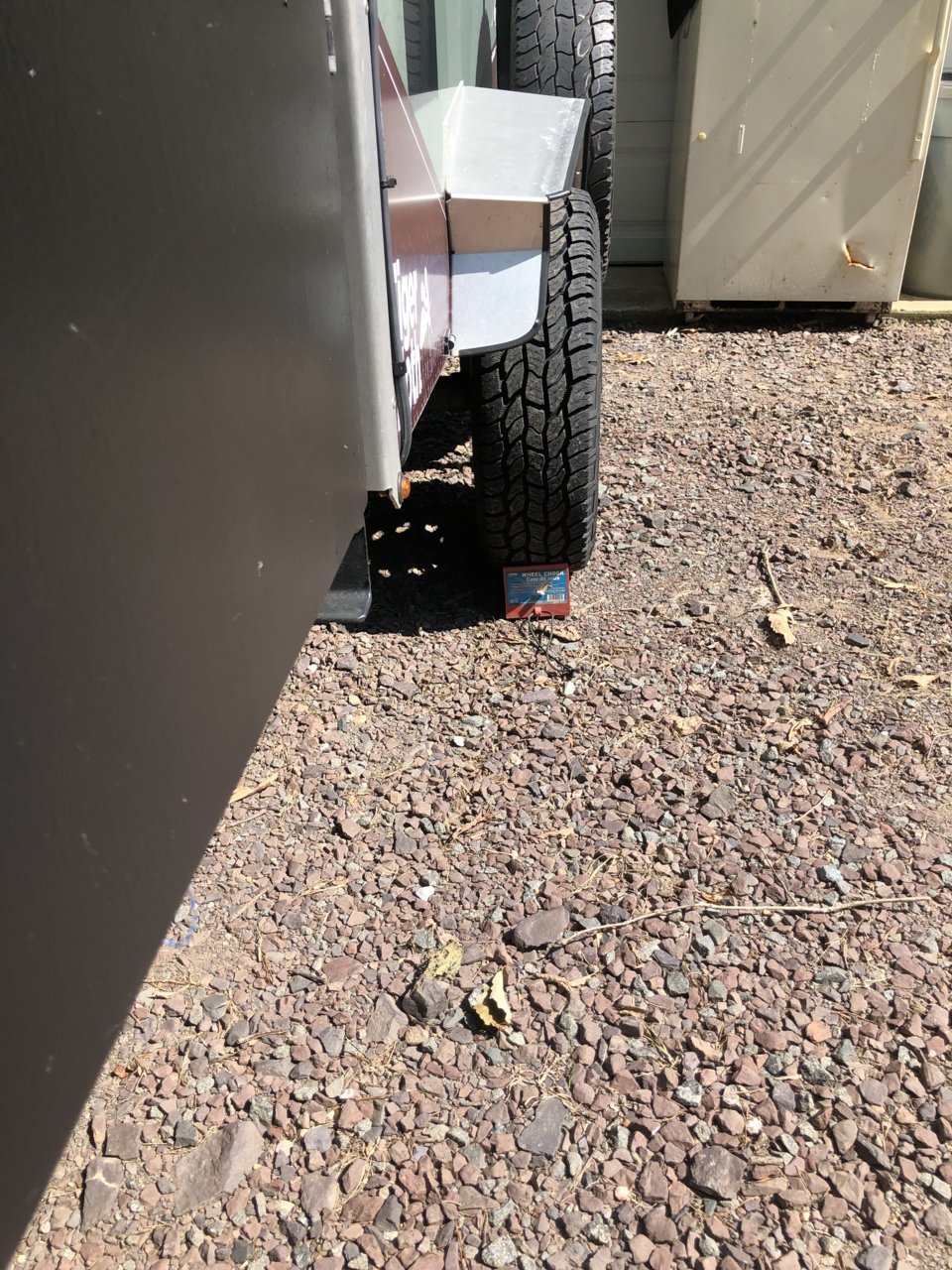

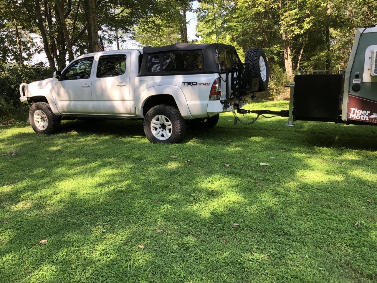

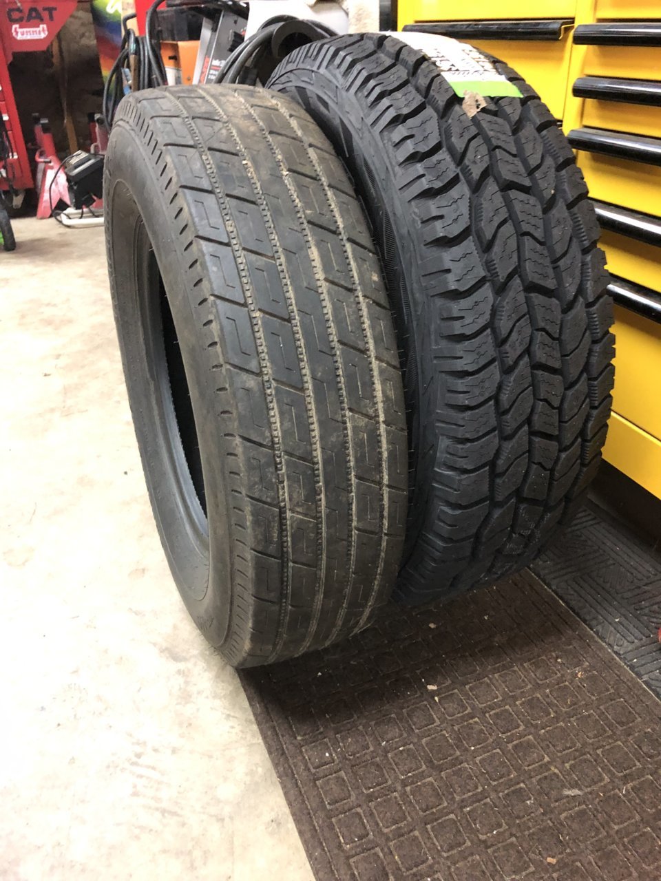

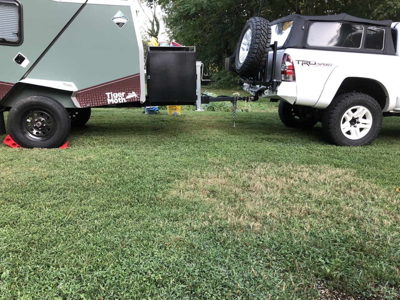

    Well back in the spring I did all the work adding the 2 1/2" lift and hub adapters to fit the Tundra wheels and it worked and the camper matched perfectly with the truck with the new bumper and higher hitch point. I just couldn't trust the hub adapters so I removed them and put the tock wheels and tires back on. When I hooked the camper back up it sat just a bit lower than I wanted so I got a set of Cooper AT's in 235/75/15 and had them installed. This was a stock size for the TM's off road version so I was confident they would fit and clear the camper.
    with stock tires
    Size difference
    So mounted up there isn't a huge difference but it's fine for now.
    The true fix will be the Timbren suspension but at around $1200 or more it'll have to wait and this will work just fine. Thanks @Wild Crow for being my sounding board through all this. We learned some short comings on our trip up the mountain and I am trying to fix the issues but money isn't limittless. This should be a good functional solution
