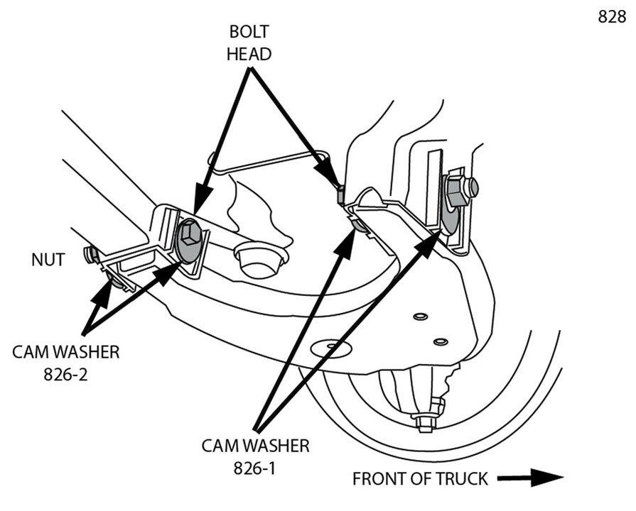

    On the Tacoma with OEM uppers & lowers, one (caster or camber) has to take priority over the other since you use the same adjustment for both. Hope the blow diagram explains is a bit better, but very simply adjust one of the bolts will change caster, adjust both give you camber, so it’s always a fight as setting caster will throw off camber, and visa versa.

    Caster is on the lower control arms, the control arms have 2 eccentrics each. Both adjust camber and caster, but the rearward is primarily caster.
    They can seize even on 16's and that may be what he is referring too, or he was lazy and only did toe in.

    That further clears it up for me. Mistakenly so I thought the caster adjustment had more independents to the camber adjustment. In retrospect I believe the tech was trying to lay that out for me. He was anything but lazy. Dude dialed in and matched the numbers.
