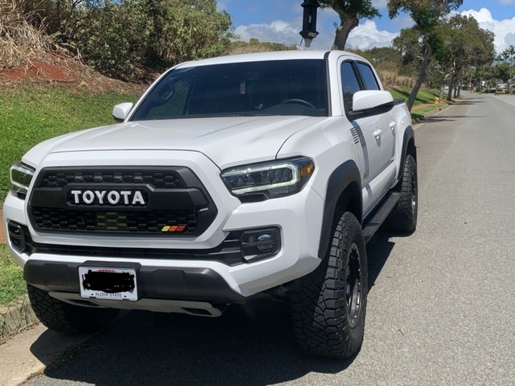

    I can't see why you couldn't fit those tires no problem without any rubbing? Mine stick out more than yours, and I only have 2" lift.
    I believe I have pictures in the "Alignment" link in my sig. It's a decent read if you have the time.
    Good Luck!
  18. Apr 5, 2022 at 11:35 PM
    #98
    toku58
    toku58 Well-Known Member
    Oct 10, 2008
    #9882
    2,534
    On a Rock in the middle of the Pacific
    Mall Crawler!
    21' TRD OffRoad 2" 887 OME on Bilstein 5100's. 285/70R17 General Grabbers G3 17x8.5" Icon TRD wheels (Gun metal gray) 4.75" BS
    Here's what mine looked like without the spacers:
    Here's what it looked like with the Nitto's:
    No rubbing even with hard off-roading.
    I would highly recommend getting a set of SPC UCA's, to give you the maximum clearance; and then cut if you really need to.
    I'm looking to upgrade to 34" or 35" tires; and that I know I will need to do the CMC.
    BUT, 285 shouldn't need to cut any metal. (Only plastic)
    285's can fit on a stock Tacoma without a CMC. Just depends if you set it up correctly.
    Good Luck!
