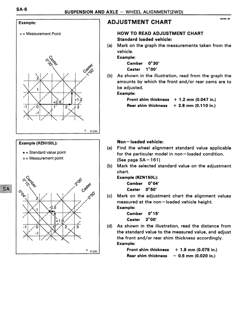

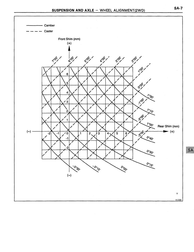

    Not sure if you have seen these yet, but this is the section from the 95-97 FSM for 5-lugs. Should be the same for your 99.

    Thanks! I don’t have the manual. That’s a handy chart if you’re going to adjust caster and camber simultaneously, especially if your goal is factory settings.
    It’s useful enough that you might consider making a separate post of the chart and all associated instructions, with a title that makes it come up when anyone searches the forum for alignment threads.
