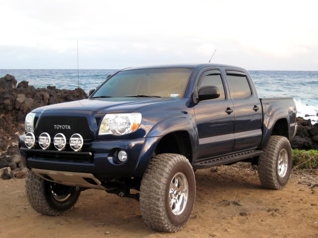

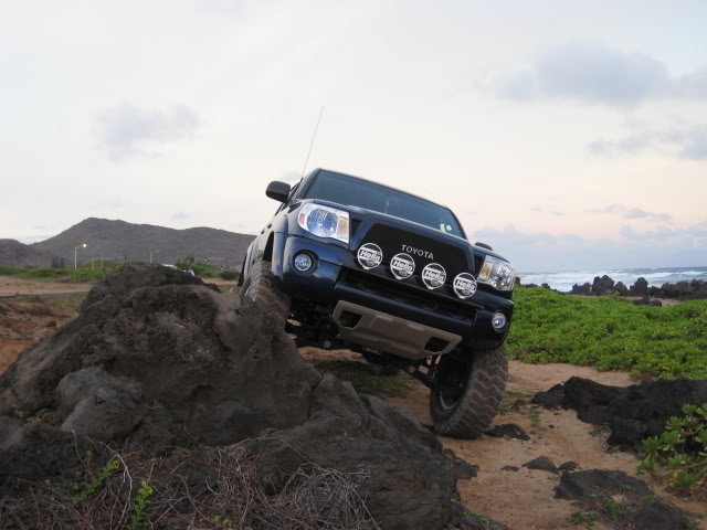

  15. Oct 16, 2008 at 9:21 PM
    #35
    toku58
    toku58 Well-Known Member
    Oct 10, 2008
    #9882
    2,534
    On a Rock in the middle of the Pacific
    Mall Crawler!
    21' TRD OffRoad 2" 887 OME on Bilstein 5100's. 285/70R17 General Grabbers G3 17x8.5" Icon TRD wheels (Gun metal gray) 4.75" BS
  16. Oct 16, 2008 at 9:44 PM
    #36
    jtaco
    jtaco Well-Known Member
    Apr 13, 2008
    #5958
    286
    07,trdOR,DC,4x4,v6,saw2.5s,OMEdakars,LRarms
    saw2.5s,AEMshortair,skyjackershocks,LRa-arms,OME dakars,Alpine,JL audio 6x9 3 way in front doors
    well they must be strong enough for 6" lift. i dont even have that much lift. are they doin ok for u toku58? did u see if they were strong enough for that much lift before u bought them? i mean did u talk with ligthracing personally?
  17. Oct 16, 2008 at 9:50 PM
    #37
    toku58
    Oct 10, 2008
    #9882
    2,534
    Mall Crawler!
    I really don't see strength as being an issue?
    Unless you will be jumping your truck on a regular basis.
    The LR UCA's are just as strong as the stock if not stronger.
    The only area that concerns me is the bushings. That is the area I'm not to thrilled about.
