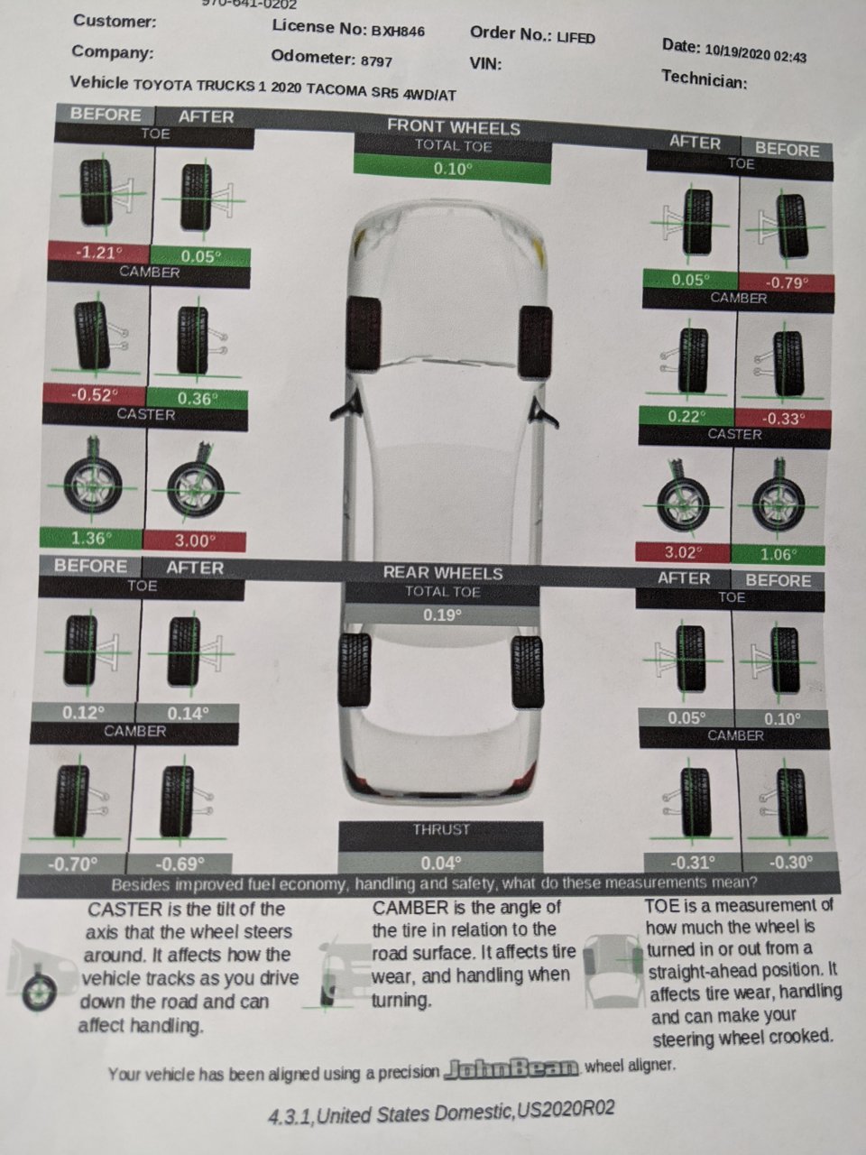

    All done with the alignment.
    The steering actually feels lighter than it did on the way there, so the three degrees caster does not make for a heavy feel.
    Unfortunately it looks like a lot of my caster came from the upper control arm being moved into position C.
    Not a huge deal or anything, but I might need to tweak on it some more when I go to fit 33s or bigger.
    He spent a good hour and a half working on it.
    It drives real nice.

    This is why when you request the "out of spec" caster, you need to tell them to max the lowers (or you do that before taking it in and then tell them not to touch it) then adjust with the uppers. You'll get that clearance you need for larger tires (I run 33s with no CMC/Cab mount relocate and have zero rubbing) and it will keep you in the "D" or "E" slot on thew SPCs usually. Each truck seems to be slightly different but that's been my experience. At least your shop knew what SPC arms were. I'm at 4* with my SPCs at "D" with 33s and it drives fantastic down the road.

    I tried to get that point across, pointing out my desire to make room in the rear of the wheel well.
    I hate to micro manage a tradesman.
    This alignment will be good for a while.
    Maybe I'll use the same shop when I buy bigger tires and drive home the point a little harder.
    It was 125.00 for the alignment. Tipped a 20 pack of michelob ultra ( liquor store across the street knew the brand).
    For now we have a truck that handles great and fits my 32s just fine

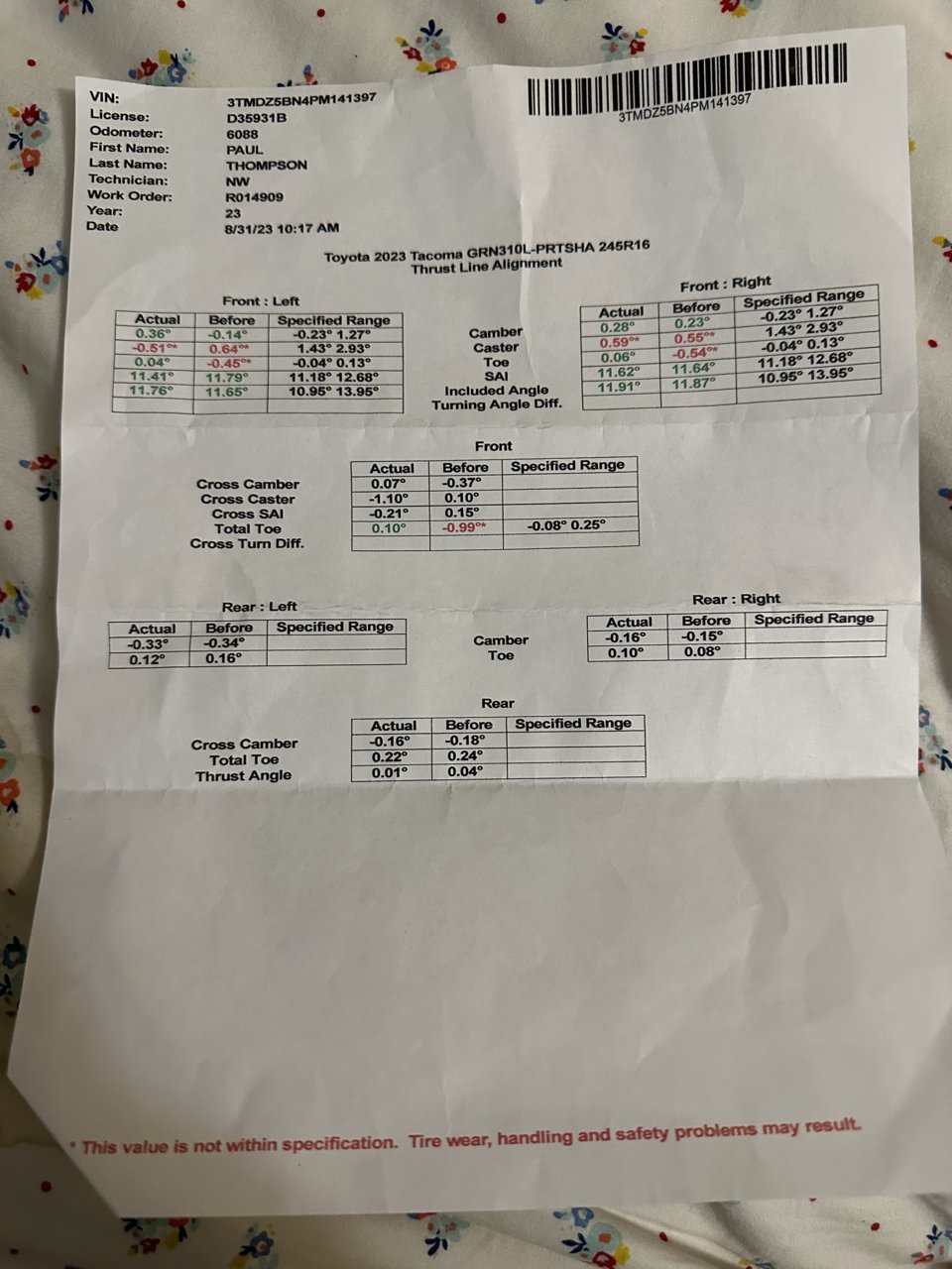

    NO! Outside of the specified range. But even the 1.43 degrees that is the bottom of the range is way low unless all you did was drive around in parking lots. Show them the statement at the bottom of the sheet, the sheet that they gave you. Get your money back and go elsewhere. Have you tried Les Schwab in Mosses Lake? Looks like there are two of them. Les Schwab has their own school for alignment techs.

    That negative castor on the left side is a pretty big deal. How did it drive?

    Like 01 said NO! I'm guessing you are getting a post lift alignment? That may be as good as they can get, but you probably have your hands full when on the highway. I'm guessing you can't take your hands off the wheel. With that low of caster, you are probably sawing left and right on steering wheel to get it to track straight. Probably time for new UCAs. If you are stock, whole different story. Go back and scream.

    That is the worst caster alignment I’ve ever seen. It’s NEGATIVE 0.5 degrees on the one side. I didn’t think that was even possible. Have you done any modifications? Is something bent?

    That’s where I got it done an Moses Lake, less Schwab I think I just need to move my coil overs down?
