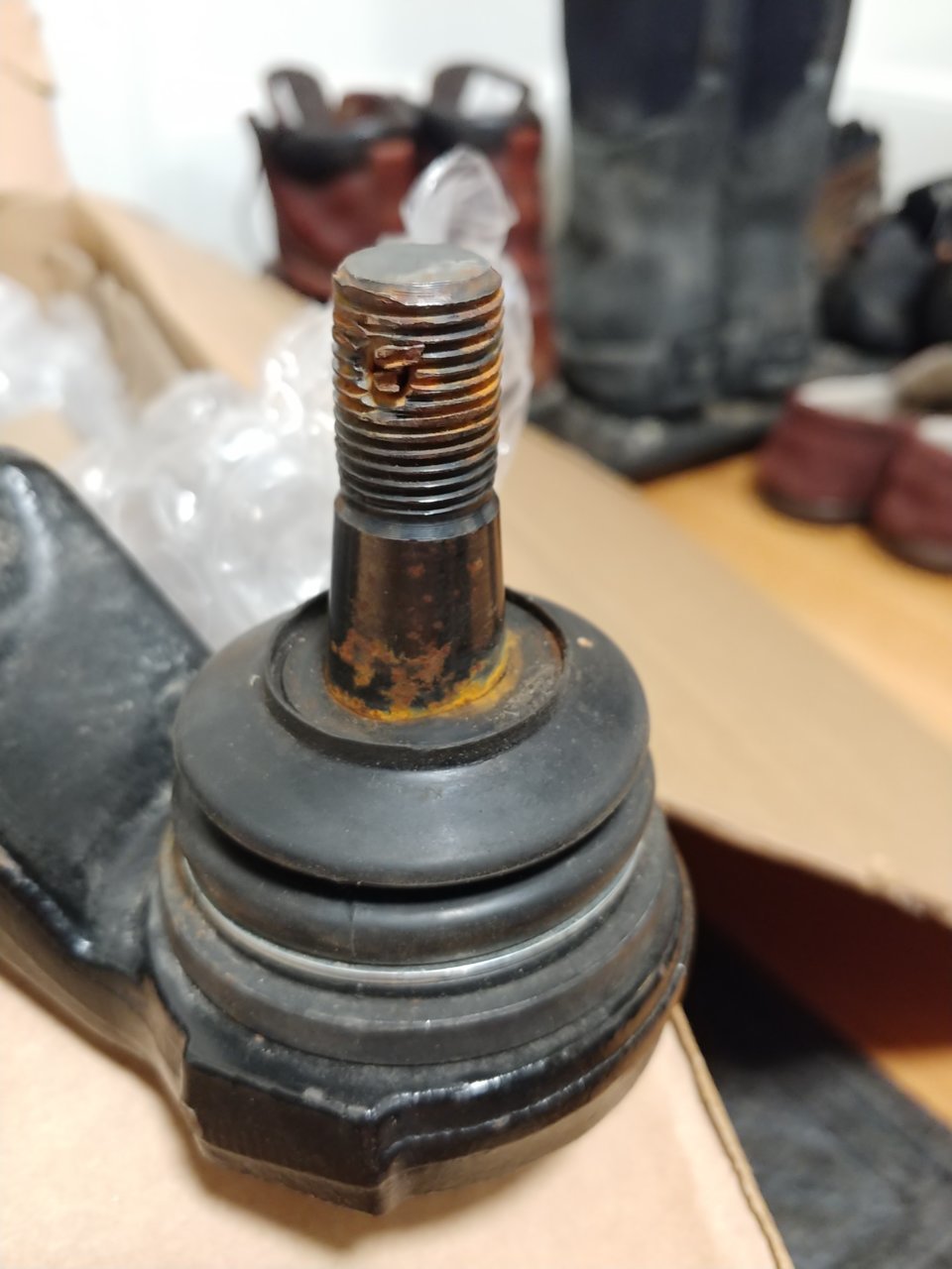

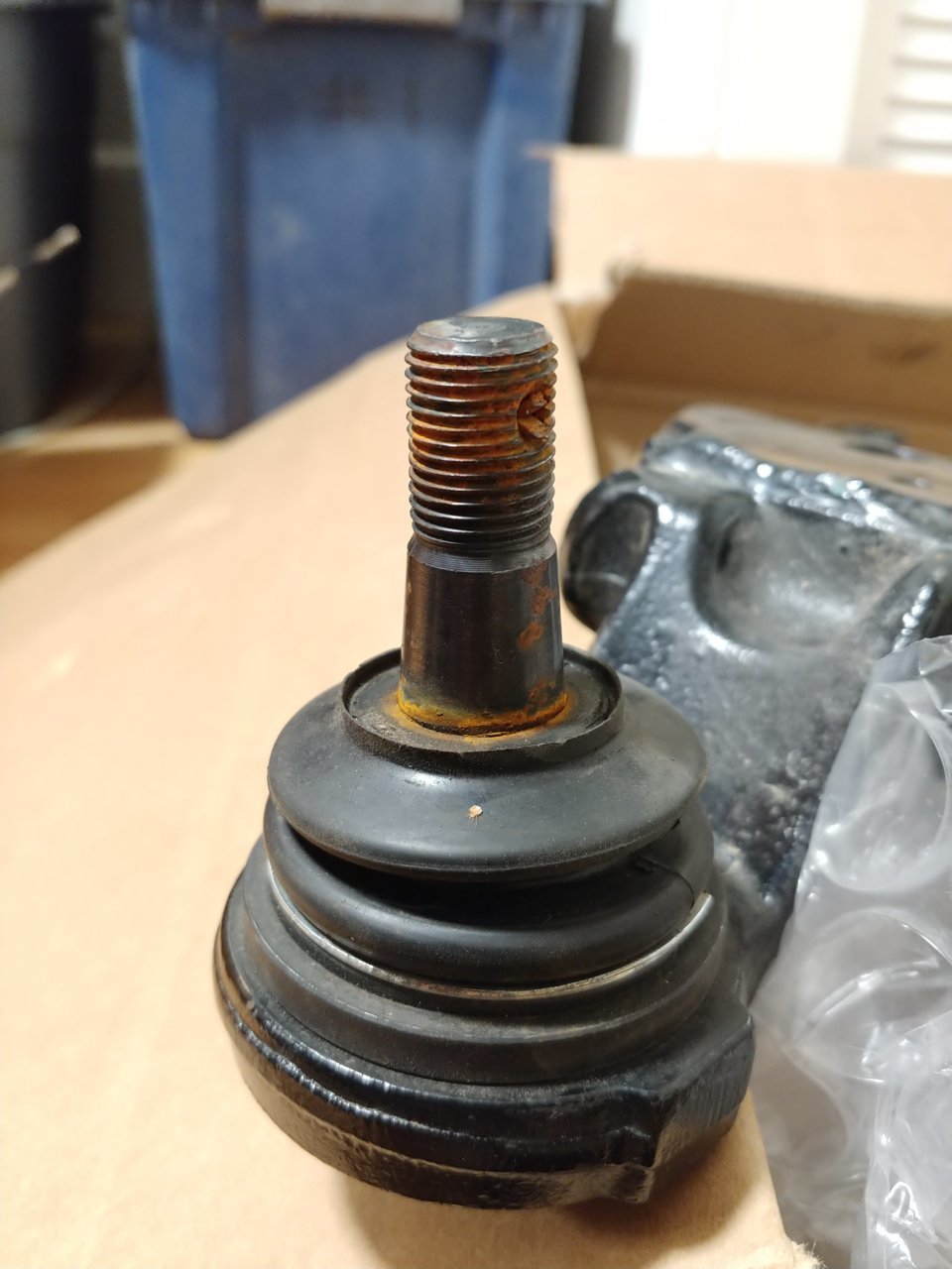

    Reviving an old thread here... Does anyone happen to know the thread size and pitch of that LCA ball joint stud? Where the castle nut goes? Im in a similar boat to OP @Dalandser
    EDIT: For future reference: M16x1.50 is the LBJ stud / castle nut thread size
    Got a set of "new" very low mileage LCAs last night. Apparently whoever took them off did not fully remove the cotter pin (somehow...) and just fed the ugga duggas right to it. A die should work in this situation to clean them up, but I forgot to measure before I left the house today :rolleyes:

    Without having one in front of me I’d say a M12 or M14

    Probably 12 or 14 by 1.0 or 1.25 right?

    Im guessing M14, but not sure abut the pitch. At $30-40 a pop Id rather not guess on dies :D

    Get a set - gear wrench makes a good one with a lot of sizes
