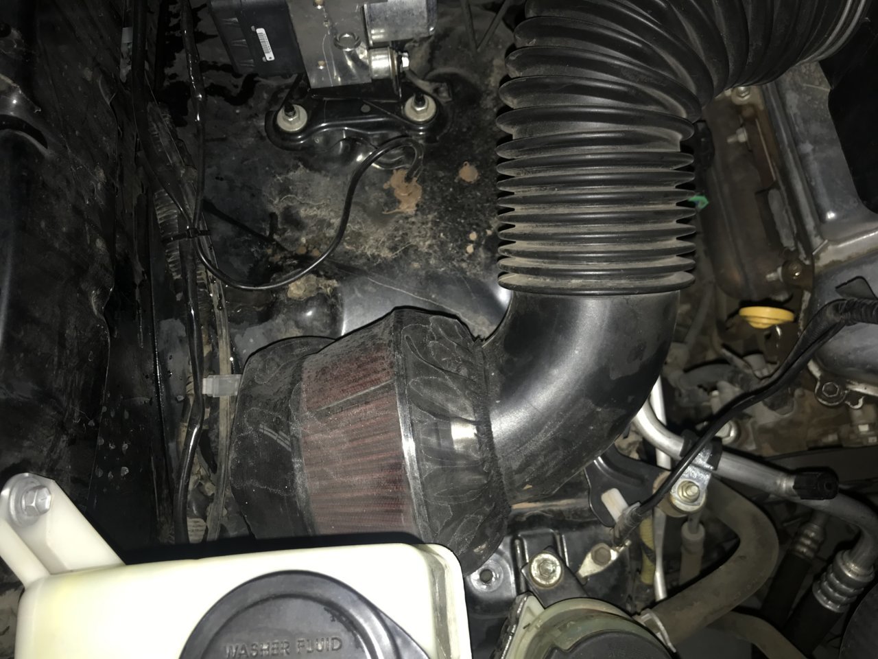

    Nice truck! I like the way you did there on your air intake. Would you mind sharing the brand name and model of that intake? Thanks!
  9. Dec 4, 2019 at 9:01 AM
    #29
    singletrack_ftw
    singletrack_ftw “I chopped the wrong leaf!”
    Aug 27, 2017
    #228223
    3,685
    Tyler
    AZ
    ‘08 TRD OR 4wd
    https://www.tacomaworld.com/threads/singletrack’s-‘dad-shred-build-thread’-i’m-just-doing-it-for-the-kids.619250/ Sos offroad sliders (kickout + filler) Sos offroad full belly skids (steel) Sos offroad front recovery point Sos offroad concepts HC rear bumper with bedside kickout tubes Marlin Crawler LCA frame brace kit Trail Gear rear diff cover Bilstein 5100 + OME 885 Total Chaos UCA BILSTEIN b110 OME Dakar standard pack Wheelers Ubolt flip kit Wheelers Superbump f/r Wheelers SS extended brake lines FN five star 16x8 -25 Milestar Patagonia MT 315/75r16 Custom projector retrofit (acme super h1 + morimoto 4300k) Baja Designs S2 sport ditch pods on CBI ditch pod mounts Amazon AMAK rock lights CMC CB radio hardmount
    I chopped the big bulky resonator off the intake tubing right where the tubing is just a simple cylinder. Then I bought a “SPECTRE” air filter from autozone and ordered a “SPECTRE mesh screen cover” from Amazon or eBay to cover it to help reduce dust / water on the filter. That’s it. Just sawed off the big head of the intake and attached a filter. And I removed the factory filter because I don’t need 2 filters.
    Thank you for the compliment also. This is the filter I used though the exact model I used was more stubby than this. Spectre Performance 8132 Universal Clamp-On Air Filter: Round Tapered; 3 in/3.5 in/4 in (102 mm/89 mm/76 mm) Flange ID; 6.719 in (171 mm) Height; 6 in (152 mm) Base; 4.75 in (121 mm) Top https://www.amazon.com/dp/B00062ZGO2/ref=cm_sw_r_cp_api_i_YA-5DbP39ARGM
    I use an Ultragauge & monitor temps and real-time MPG and IAT & all kinda of vitals & my janky DIY intake solution has been fine even in super super hot AZ temps with 35’s and stock gearing LOL. (4:88 are next though)
