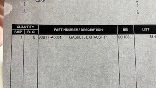

    I’m prepping for a cat back install and trying to figure out the gasket that’s needed for the flange. Saw two different part numbers? My flange is pretty rough so I got new bolts, correct size, but not sure how it’s gonna come apart. Looked at split flange options also. Anyone else had to deal with this?
