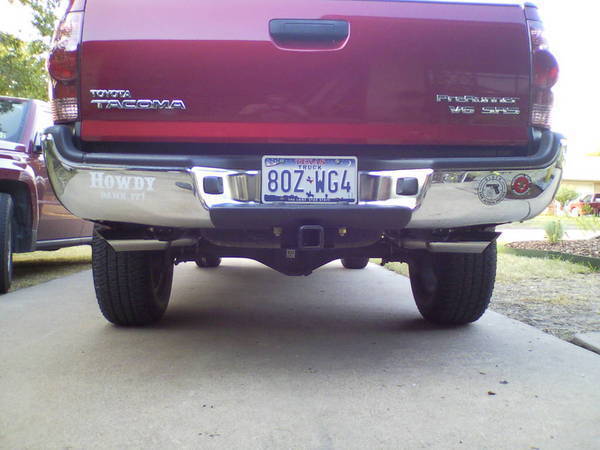

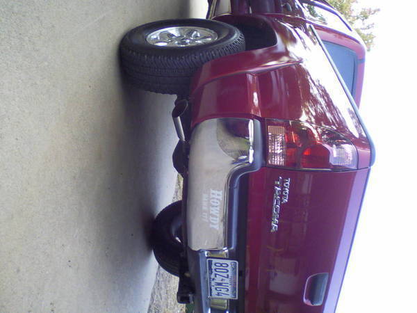

    I put on a Flowmaster Super 40 single in dual out with 3.5x12 Echo Tips, I wanted something that kept the same departure angle of the truck.
