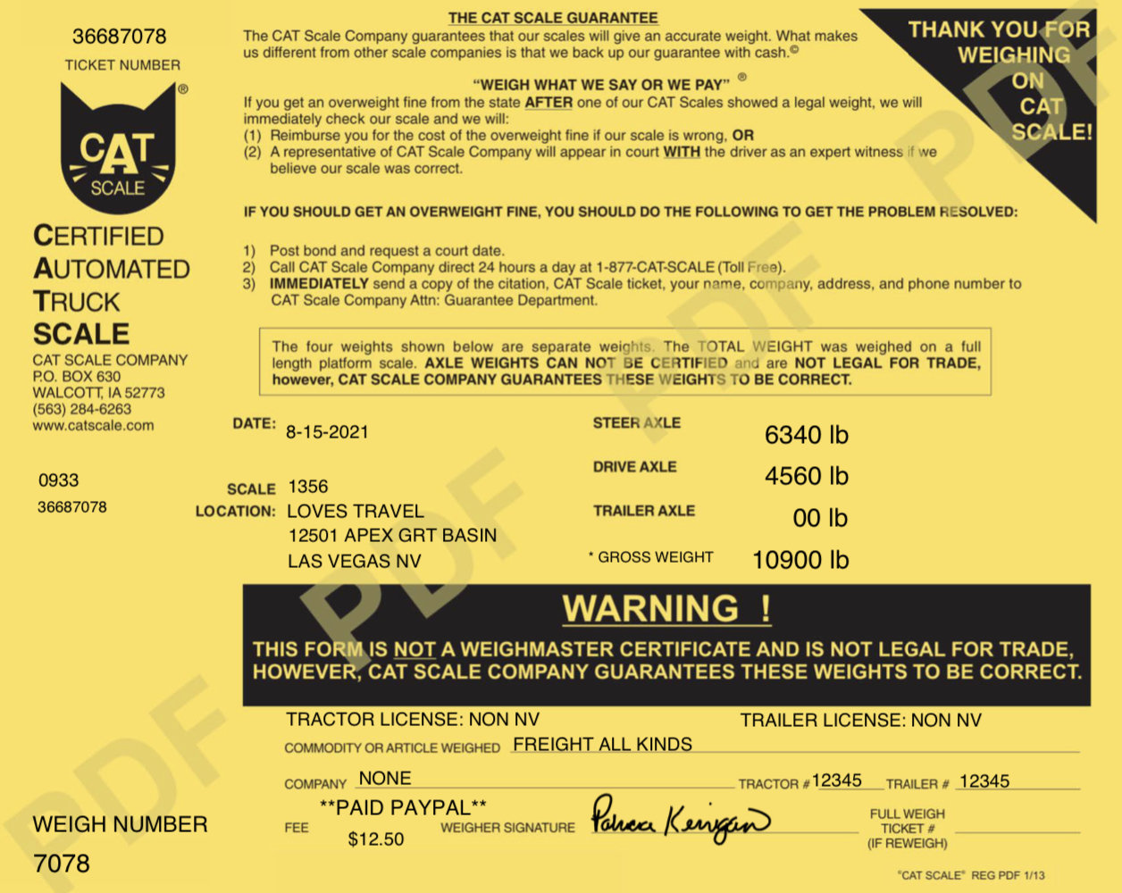

    Attached is my scale result from earlier today. 2017 4x4 OR with tow package. 22’ trailer 3800 dry and 6800 max. Stock (at the moment, stuck in back order hell).
    If I understand correctly I need to shift weight from the truck to the trailer. Quite a bit.

    A general rule of thumb is to have 10-15% of your trailer weight on the ball of your truck (tongue weight)

    ONLY 2 axles weighed & U have 4 axles ??????

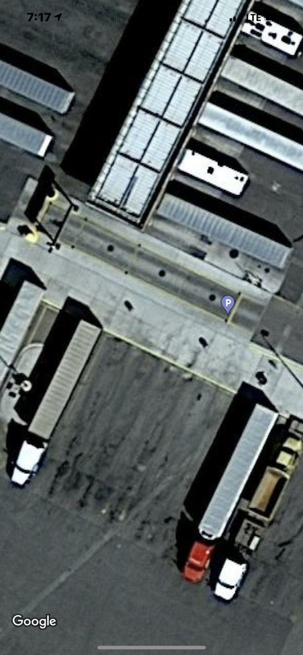

    I tried twice to get the two truck axels weight separately with the trailer but even though I had them on the marked three scales, I could only get the trailer and the truck.
    The first number is the truck, second the trailer.

    @T8tjt: Kinda tough to get individual axle weights for a Taco + trailer on a scale designed for tractor trailers. You may have to figure out how to get just one axle on the Taco onto the scale's platform, most likely just the front axle. Knowing that, and what you already know you should be able to figure out the rear axle weight.

    If that first weight is just the Tacoma plus tongue weight you need to move stuff out of the truck and further back in the trailer. That's showing you're 700lbs over GVWR with what looks to be a pretty stock truck.

    Yep it is and that’s what I figured. So since the tongue weight is approx 10-12%, or 450-500ish, I need to move about 300lbs which I think I can come close with the generators, extra water and additional junk my wife insists on.

    2,212
    2019 I4 WHITE SR PRERUNNER
    FEW
    actually not true
    living in a military town
    officers transiting out with vehicles are required to weigh
    5 pads on the scale to weigh almost ANY combination
    done right an ACCURATE Status of weight distribution
    only $10 bucks

    Three pads at this location.

    equals 3 weights ........................only 2 shown

    Maybe four. Refer to the picture.
    The pads are so long that getting the three “axels” on individual pads was an issue. The trailer is only 22’.

    What is your TOTAL weight truck, trailer, people, etc?
    Now look at your MAX GVWR on your drivers side door jamb I'm betting your over weight

    cat scales would differ with U.............they are Certified State & country wide
    a certified scale is required to weigh ANY road combo
    UR total weight is at least 2500 to 3000lbs more

    That was a fully loaded weight on both.

    I see that what does your sticker on the door jamb say your max GVWR is?

    Ok. Sooooo, we’re overweight truck wise. I get it. I was more worried about tow weight but now I understand better.
    I figure with the current config of stuff, wife, dogs etc that I can move 250lbs back to the trailer. It’ll get it closer but I suspect it’ll still be a bit over weight.
