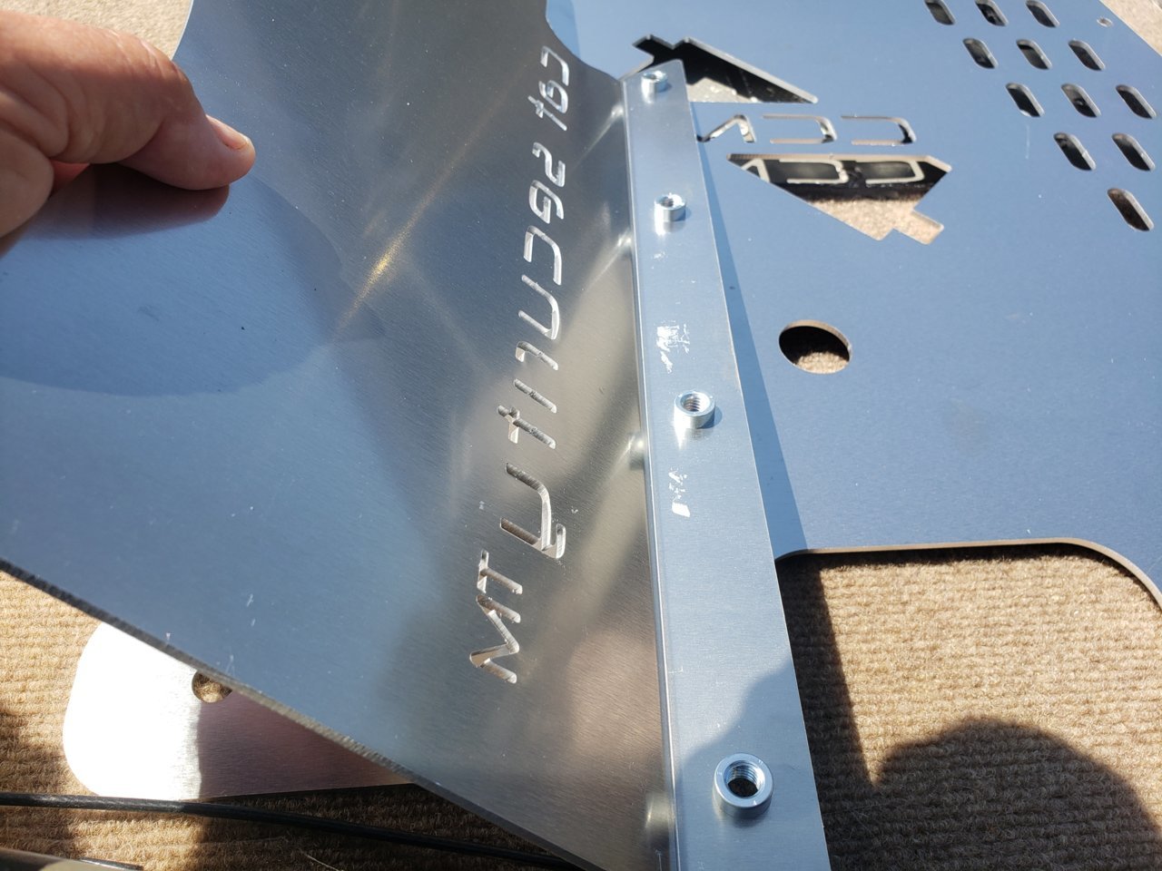

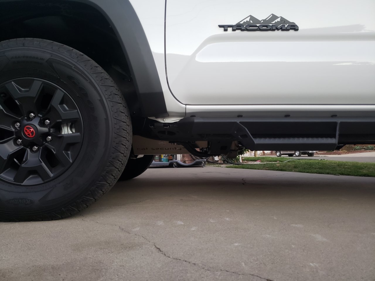

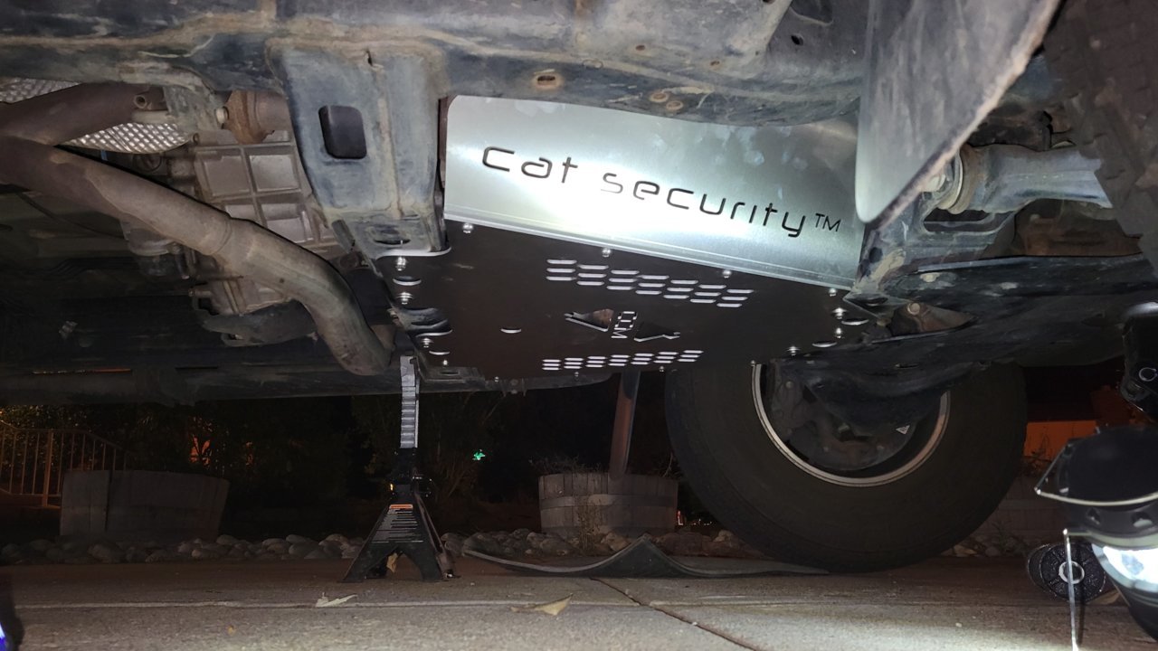

    Yes, 4-7/16" holes. 2 in the crossmember at the rear of the tranny between the angled supports (which are also connection points) and 2 under the forward crossmember that the TRD skid-plate is attached. The 7/16" holes each get a threadsert installed for 4 of the 5 mounting points. The 5th is a long bolt that anchors through the entire forward crossmember. It is the ONLY bolt that is not a security torx. All the rest are M8 security torx.
    It's MUCH easier to put the truck on ramps. That's what I just did. With a bit of fiddle-f**ing around during the install, I got the whole process done in under an hour. The ramps are helpful to give you some maneuvering room for the drilling and install of the threadserts, otherwise your face is going to be right in your work. If you don't have a threadsert installer, they give you instructions on how to build a makeshift tool with an full thread M8 bolt, 2 M10 nuts, and 2 oversized washers. I've been installing threadserts on occasion for decades by this method so I picked up the suggested parts to do it only to find when I started, they had actually supplied all those components! I didn't catch that in the parts bag. They even supply the T50 Security Torx bit you'll need. All the hardware is very nice, stainless steel stuff. No cheap zinc plated crap. It's a class piece of design and construction.
    You can just barely see it under there...
    Completed install...
    Prior to bolt on side plates showing threaded bosses...

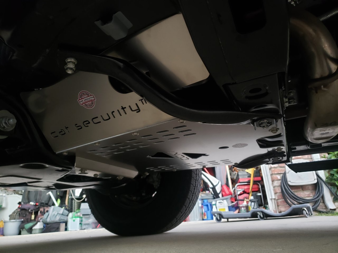

    Installed mine tonight, gives me a bit more peace of mind. Looks pretty good too.
